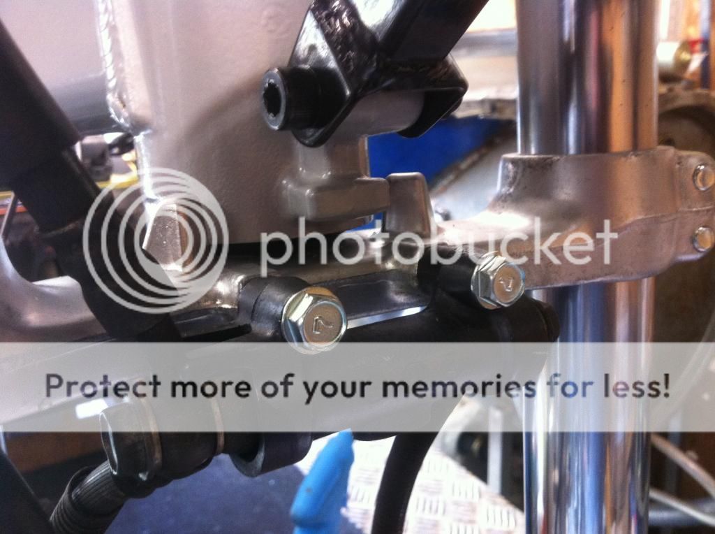

are the fork stations ok. as I notice pitting above the bottom yoke. I know A company that does as new hard chrome
- carlsburg
- Light Smoker
- Posts: 39
- Joined: Fri Jul 01, 2011 6:22 am
- Location: sudbury suffolk
Re: KR-1s restoration... getting started.
Yes the forks are a little pitted but not bad enough to worry about, I will get them sorted in the future.
They look a lot better in the flesh.

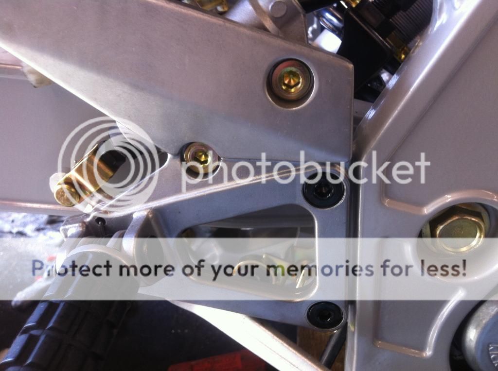

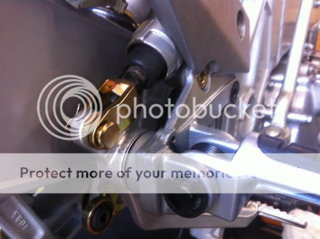

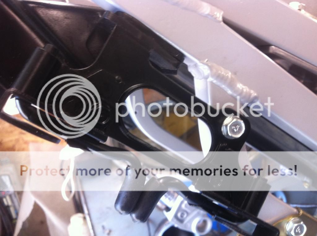

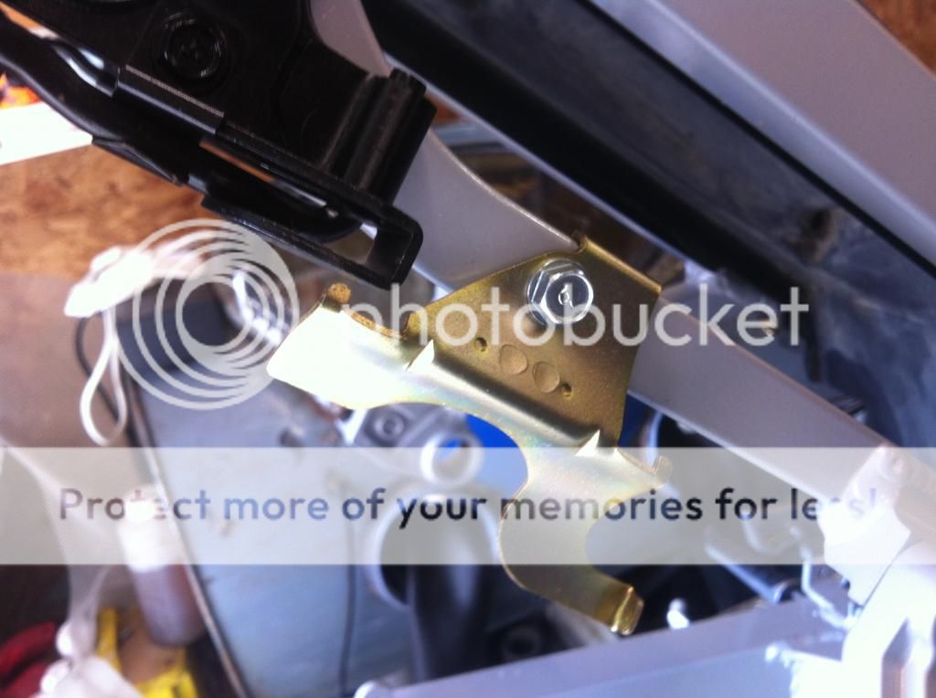

Here is a few more photos of my progress.
- Top-shaggy
- Posts: 1966
- Location: Derbyshire
Looking good.. Liking the replated bolts and brackets, look very smart on rebuild )

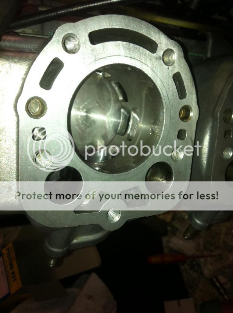

Thanks Fred, that looks just the job,

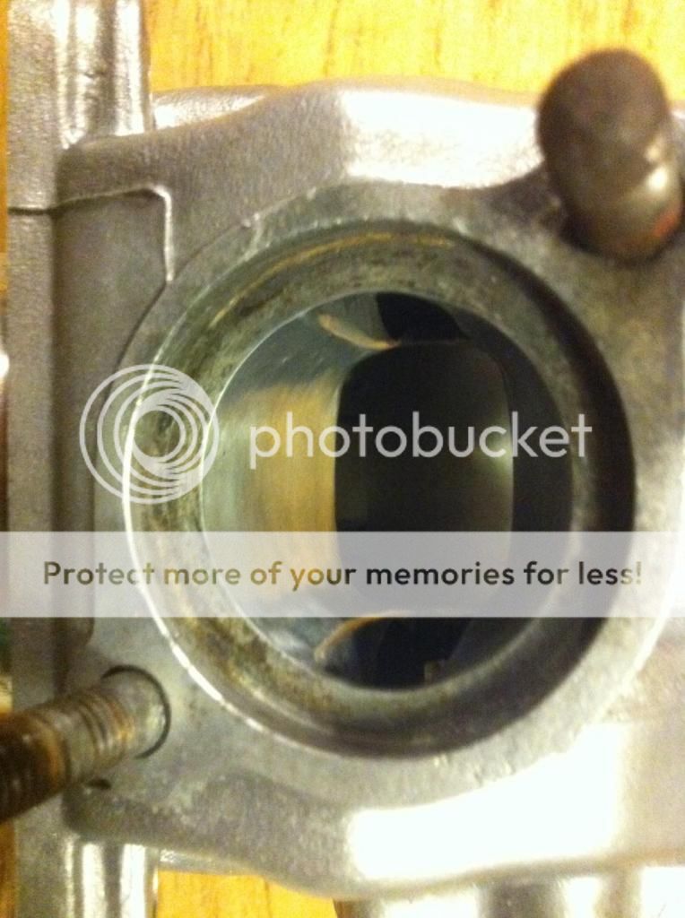

I have just got my barrels tuned, we have a fitter where I work, and his previous job was tuning 2 strokes at Stan Stevens.....what are the chances of that!!! So both barrels have been tuned...
when i removed the barrels, one had been tuned and the other not, that could explain the massive flat spot...
they look very good now..

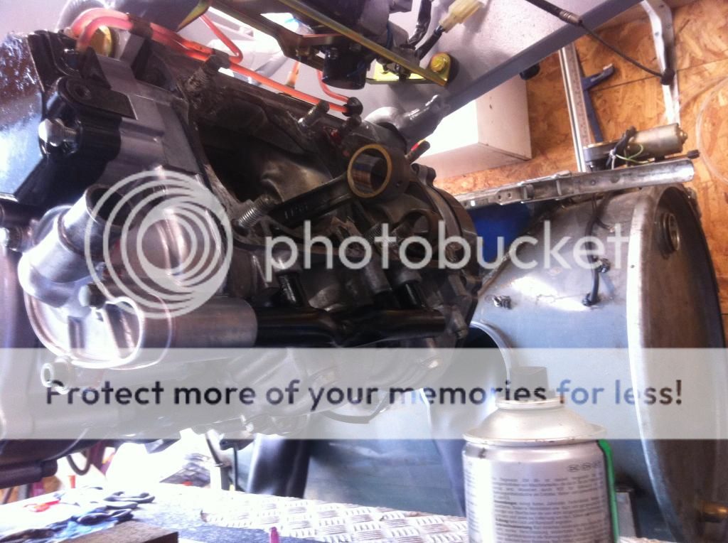

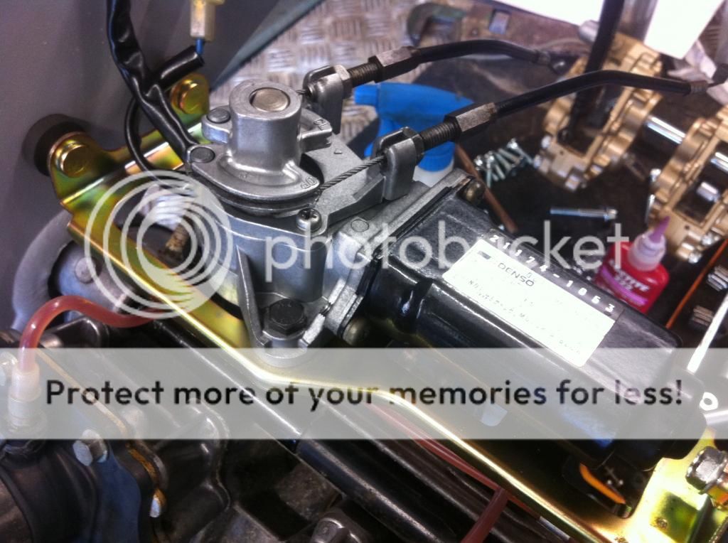

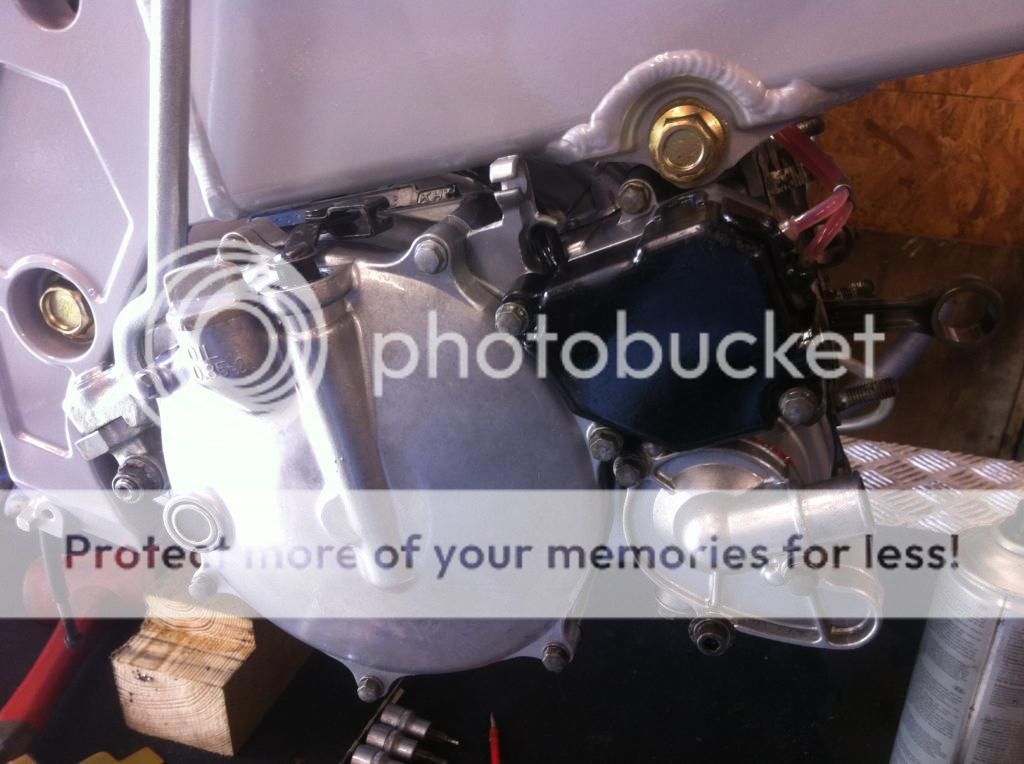

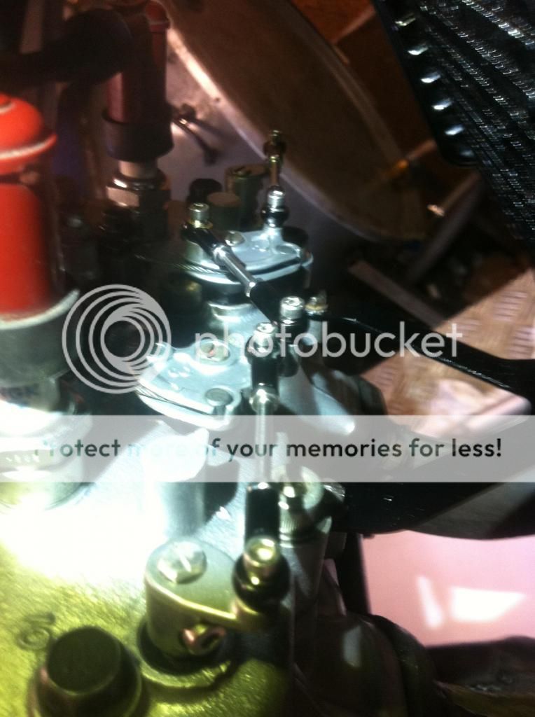

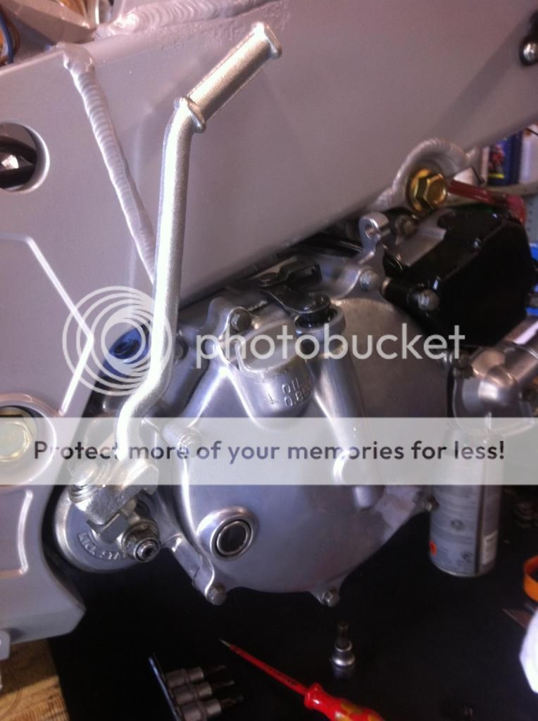

Fitted the top end today, fired it up, I was surprised when it started second kick....

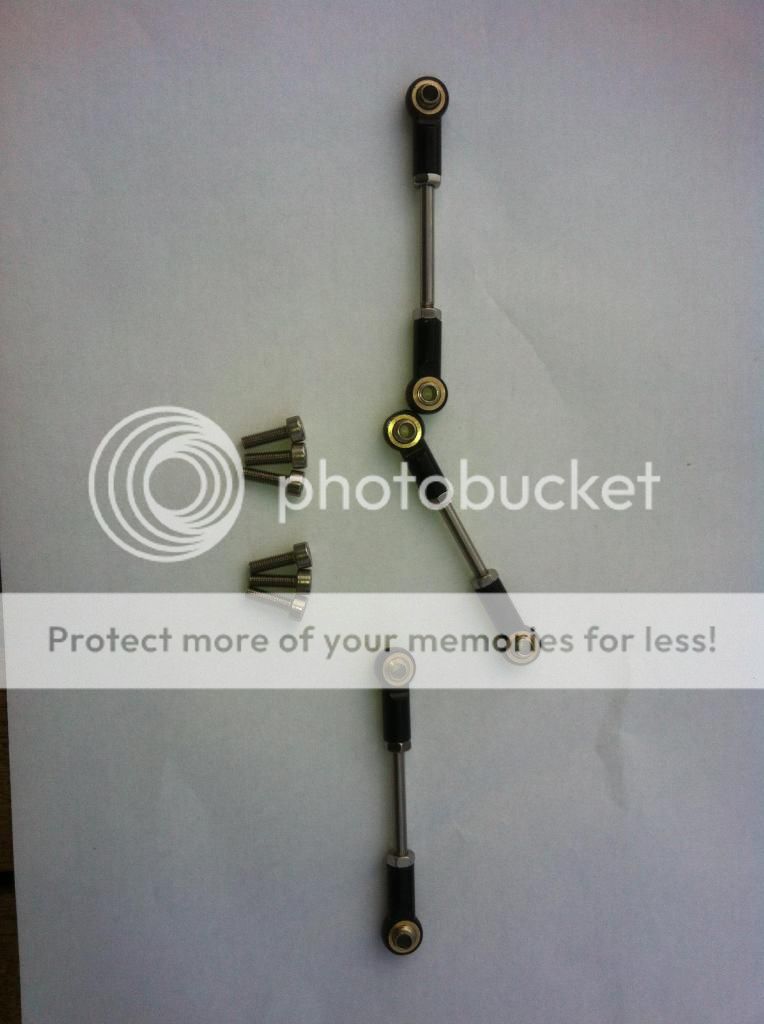

I have made some kips link arms, my original ones were shot so I have sourced some good quality rod ends and made my own, using stainless link arms and locking nuts.
I have over ordered on the rod ends so I have put the spare ones in the items for sale section and on ebay.
these are all metal and not plastic....
- tescr500
- Posts: 742
- Joined: Sat Aug 29, 2009 12:05 pm
- Location: hampshire
nice bit of welding there like it =D> =D> =D>
