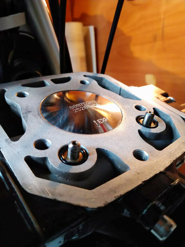

I removed the head and took a few measurements. Firstly I set the piston to TDC and checked the deck height. I'm not sure what is technically measured as deck height, as the dome of the piston does come above the deck height of the cylinder. But at the edge of the piston it's lower than the deck height by 0.3mm as accurately as I could measure with a straight edge and feeler gauges, which probably isn't the ideal method but it gave me an indication of the clearance available.

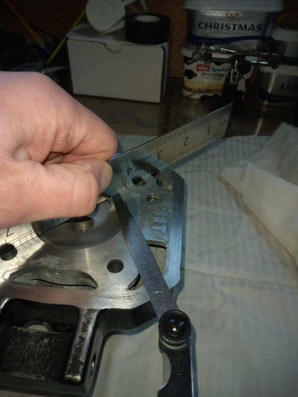

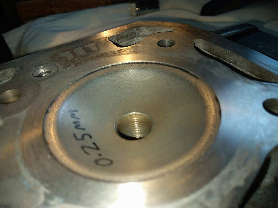

Then I measured the step in the head from the squish band to the head face using the same method, so again not ideal. But I found that a 0.6mm feeler gauge was a tight fit under my straight edge. So this gives me about 0.9mm piston to head clearance + 0.25mm for a compressed head gasket. This though approximate is a bit more than I thought, but it's a safe clearance and I've already had 0.25mm skimmed off the head. I wish I'd been able to accurately measure the head volume and work out the compression ratio, but I forgot to order a burette in time, and the domed piston makes it a bit difficult to accurately measure the combustion chamber volume?

Picture above showing piston at TDC.
Cylinder head.
Measuring step in head to squish band with 0.6mm feeler gauge.
Sorry about the poor phone picture quality, but I thought they might show an idea of how it looks.

looking at your last pic, to me the diameter of the head is +/-54mm : 2 inch (from 4 to 6) + 3/8th of an inch after the 6 minus 2/8 after the 4 . but you say the head is 55.3. still, let's suppoese you measured right.
than you still continue to mis-calculate your squish clearance : you can not count the 0.6mm from the head as it's diameter is smaller than the diameter of your piston !!!!
on the edge of the piston, you don't have squish-clearance, you only have head-clearance as the squish in your head does not reach the edge of the bore.
so you only have 0.25 and 0.3mm = 0.55 head-clearance which means you are in GP-engine-territory. when all parts are new it will not be a problem. But GP engines are not supposed to run 10.000km as they are opened probably daily and have service interval's of about a tenth for the crank. I don't think you'll get to 5000km before the piston start's kissing the head.
If I where you, I didn't start the engine, but take it appart again , and either add a 0.2mm gaskett under the cylinder, or better : have the head cut so the combustionchamber matches the bore.
