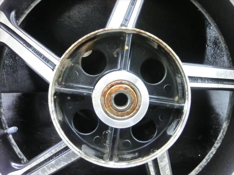

For starters, axle diameters- if I'm not mistaken, the KR-1 axle is 15 mm, the KR-1S axle 17mm. It can be done, I suppose, there are others on the forum who can offer more info and advice.
- Posts: 1595
Re: Wheels front bearings
KR-1 bearings 6202 15mm ID, 35mm OD, 11mm wide
KR-1S bearings 6203 17mm ID, 40mm OD, 12mm wide
Youd need rings to adapt smaller bearing (35) into 40mm hole of KR1S hub as well as new hub spacers
(There is no cross over bearing for stepping down to 15mm axle)
Or get some S forks with axle then you have to upgrade calipers also
I think the rotor bolt pattern is same to use smaller 1 rotors on 1S wheel
Hub Bearing spacer tube (B 1) 92143-1185 COLLAR, 15.1 x 20 x 70 long
Hub Bearing spacer tube (C 1S) 92143-1317 COLLAR, FR 17.1 ? x ??? x 72.5 long
