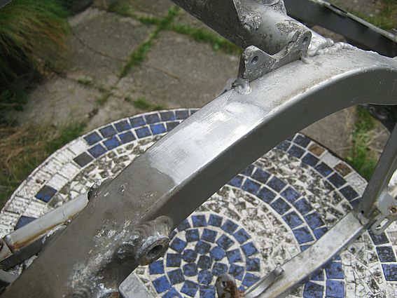

First rough surgery on the rear subframe:

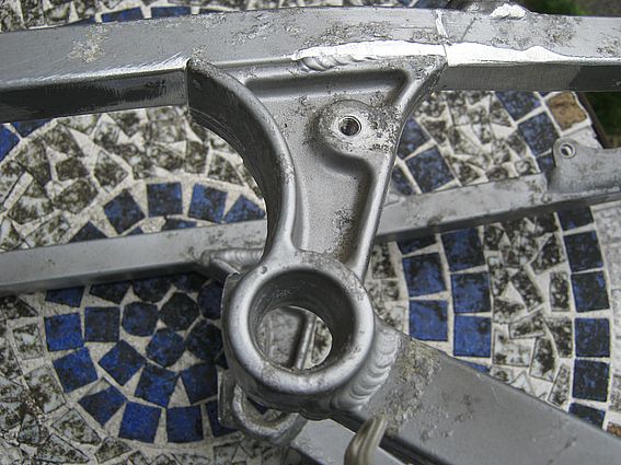

Re: KR250A track bike project.
Next step is to carefully remove these two weird brackets, one at a time, and replace by 20 x 3 mm round tubing:
I might need them later for an altered rear suspension setup.
