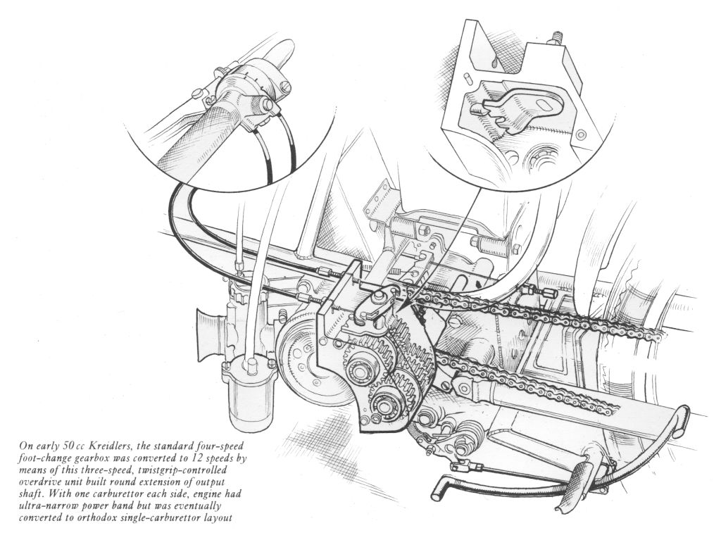

Thanks for your reply. That rings a bell from my distant past, probably picked it up watching Grand Prix re-runs in the '70's or something. Have you got any more info? Maybe some pics? Big question: might it be possible to build something like this for a KR1 or similar? Hi/Lo would probably be enough for my purposes.

- Posts: 1588
Overdrive gearbox 12 speed, 18 gears
Three speed overdrive Kreidler - 12 speed
..."in the eary sixties when the bikes were still air cooled, the 50cc class where a high proportion of race time was spent completely flat out, more gears allowed the small engine capacities to stay in the powerband.
New Zealander Hugh Anderson won the world championship (50cc) in 1963 & 1964 on the single cylinder Suzuki - for '63 the engine had 1bhp more horsepower (11bhp total) and 1 more gear in the transmission (9 total). The consequent boost to top speed was 6mph.
Later on the Kreidler bikes went to 18 gears - 9 internal, with a 2 speed overdrive "
