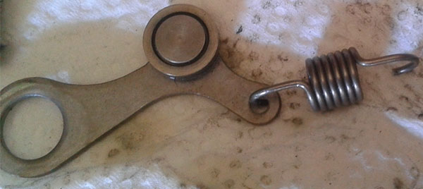

Re: Gearbox failure
Hi Guys
the spring is broken.
unfortunately, the mechanism of my spare engine is different (from KR1 ?).
the spring is much shorter.
i'm a little unsure
i can very easily and widely rotate the drum.
is that normal?
i'm a little unsure
is that normal?

what is the correct part number (long spring) for my engine?
springs are no longer available.
and now???
and now???

Hi Bernie
Thanks for the address .
Unfortunately NLA
fits a spring from another motorcycle ?
is my ( long ) cracked spring from the KR1S or KR1 ?
cheers

both springs are no longer available japan 92081-1709 92144-1448
stocks could be different in EU
many engineering shops sell partitioned boxes of extension compression tension spring assortment
you might look at side stand springs or brake pedal springs...
92081-1296 92145-0105
92144-1185
92144-1185

it's a spring, just find one that fit's with some tension and it wil do the job.

I've already asked in some motorcycle shops.JanBros wrote:it's a spring, just find one that fit's with some tension and it wil do the job.
nothing to find.
The problem is the long hook.

make your own. springs can be bent

I have a spare spring.
Many thanks to Jarno! =D>
should I gouge out an eye?
cheers
Jan, i work in the IT.JanBros wrote:make your own. springs can be bent

When you fit the spring i would check that it does not rub against any moving parts
As i recall there are different ways of fitting it - and i think constant contact with the change mechanism
could have worn it through
