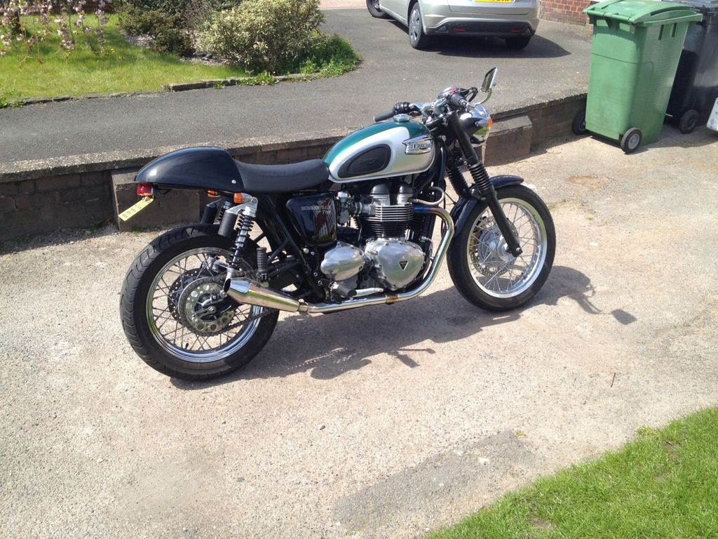

So to date as of May 2016
Replacement front forks (old ones were shagged)
Thruxton fork internals which basically give the forks some pre load adjustment
Thruxton front wheel (old one was 19 inch,Thruxton is 18 inch and alloy)
LSL Clubman bars
Alloy single clock mount
Fork Gaitors
Chunky lockable fuel cap
Mirror hole blanks
Rear mudguard eliminator with Lucas style rear light
Thruxton front mudguard (will need modding to fit)
h***a 3 piston front caliper to replace standard 2 piston caliper (Bolts straight in [-o< )
Thruxton seat
Thruxton seat cowl
Angel eye headlamp to fit inside standard shell (looks more retro !!)
Stainless Predator silencers
Alloy bullet style indicators and rear locator brackets
Thruxton rear shocks (Longer) (Now TEC Shocks)
Removed air injection system
New horn
Skid plate
EBC Front Floating Disc (Old disc worn out and pretty heavy)
TEC Rear Shocks ( Cheap but a great improvement)
Plastic Side Panels (To Replace Heavier Metal Ones)
