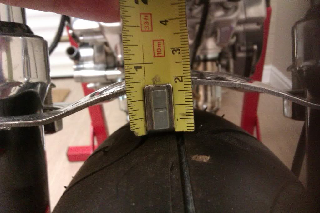

But I'm trying to figure out the front mudguard. There seems to be very little clearance to the actual tyre...
This is at the back it's basically touching:
The front has some clearance, but that's only because there are 1cm spacers added in there between the forks and the mudguard plate. But even then they don't seem to get it very high.
The tyre on there is I think a 110/70-17, so in theory the same diameter as normal (or close enough).
There doesn't seem to be any stock spacers in the parts manual for this.. So I feel like I'm missing something really obvious, or somehow an 18" wheel and tyre have gotten on there.

I don't have a mudguard handy, but the bracket is in place and there looks to be about 17mm between the underside of the bracket and the tyre.
