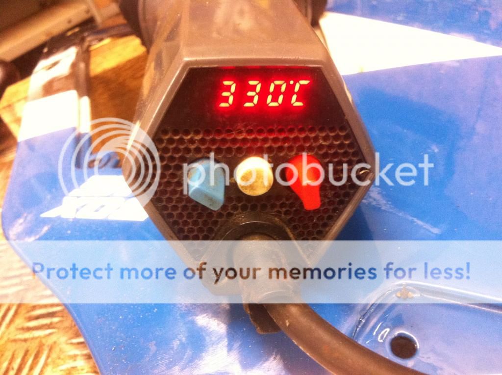

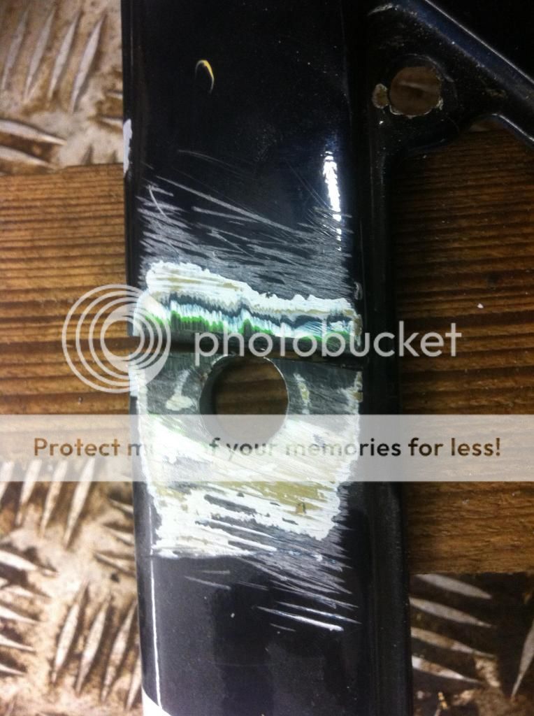

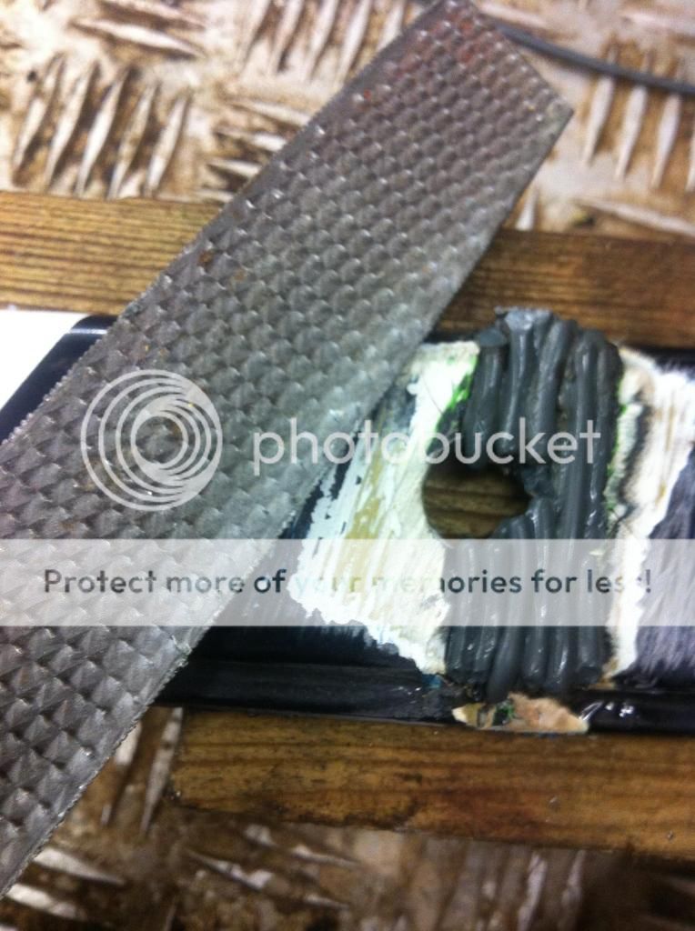

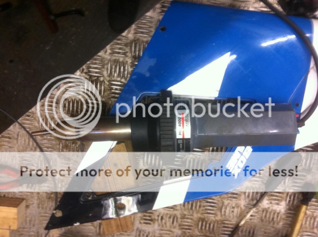

Here are some details on the plastic welding repairs I have done.
firstly, find a suitable crack.
Prepare the area with a grinding wheel, try and get it back to the good plastic.
I have a plastic welding gun, you can use a hot air gun as long as it has a good stable heat controller, you need to set it to 330 deg C if it is cold in the shed, or 320 deg C if you are in warmer climates.
The filler rod is ABS plastic, it is important that you only use ABS as any other plastic won't work.
Place the filler rod at 90 degrees to the work piece, and using the hot air from the gun move between the work and the rod in a swinging motion until the rod and work start to melt, (they will become tacky) at this point apply light pressure to the rod, this will then start to move towards the gun, continue all the way across the gap. you can build up as many beads as necessary.
when you have enough filler rod in the gap. let it cool for a while and then use a rasp or coarse file to level the area, followed by a normal file for the detail.
hope this has been some help.......
