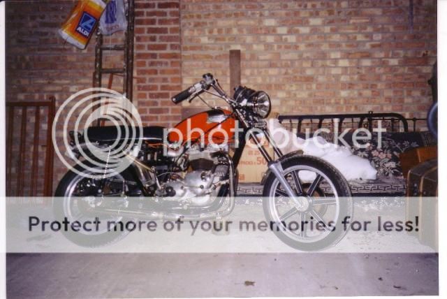

heres some inspiration for ya ....
note the fine detail such as sparkplug battery box side cover
i think he was doing a high speed run as it doesnt normally feature the long range fuel tank
