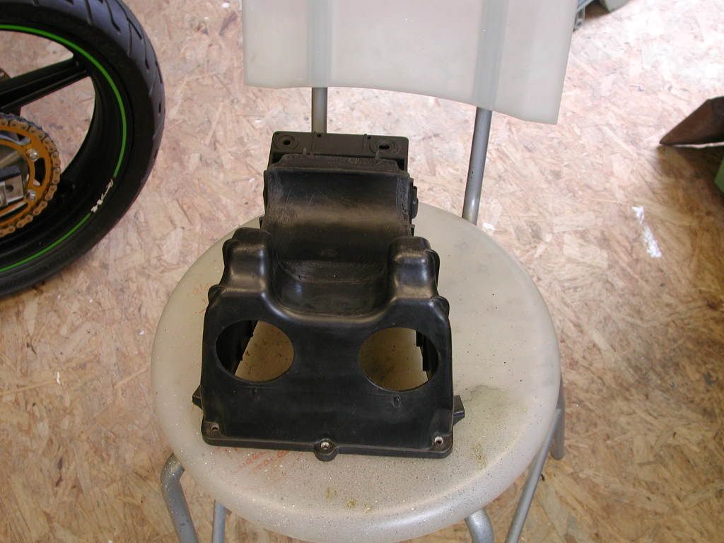

Could'nt find the will to make a new airbox. So took the dremmel to the old one, though it would be a pig but ends up wasn't that bad. Took a lot of time before I made a cut but I got lucky & was very close to what I wanted 1st time. Well chuffed, but would rather have had K&N's. Alan.
Photo bucket is playing silly b$ggers so new post for pics. :evil:
alanw
Posts: 507
Location: northumberland
Post by alanw »
I used an old mudguard inner heated & rolled around a pipe
Second time I've done plastic welding with soldering irons. still not fantastically pretty but it is strong & watertight.
The curved piece takes up less room inside
I'll have to find out what these screws are for :roll: never mind they look pretty :)

alan..old mate....would you be interested in making me one of those,its a top job =D>
and the shiny things are high and low speed compression damping,when you plodding along the shock does'nt need to be as firm as its got time between bumps to get back ready for the next bump...but as you hit bumps in quicker succession,the shock needs to be stiffer or it wont return to deal with the next bump...it then hits another bump and sits a bit lower...then another bump and its lower still till it cant deal with hitting bumps anymore..its called pumpdown...
only trouble with turning em is you can make it worse...write down the stock settings,ride it,then adjust 1 screw at a time...try it,ajust a bit more,ride it...
im probably teaching you how to suck eggs...:oops:

alan me old,thats cock on fella 8) how long did it take to make?you must have some right patience =D>
Posts: 1549
Post by scooble »
wow, that is some job.
I did mine with GRP and plastic filler, and it looks a right bodge!
Hope to be building a fully enclosed one soon from plasticard. I think I might need to make the sub frame cross brace detachable though to get it in and out though :?

alan, what you mean it dont look pretty? its damn neat enough to me. esp like the fact you can get to the adjusters easily. id jet up, and try set it up to run with the lid absent. this will make up for the loss of volume. however you may find it will be as good with the lid or with the lid jacked at the front 25mm. dynos are good for comparisons like this. cracking job alan.

Took from 4 till 11 one night, couple of hours the next night. Another one would be quicker. If anyone NEEDS ! one & CANT ! do it themselves. I'll try to do one or two, you would need to supply the airbox btm + an inner guard or suitable ABS. If too many want one then sorry can't do any
"time time time". I'll measure photo template any of it to help..... Using a soldering iron to plastic weld, I have 2 soldering irons, one very fine circuit iron which after experimenting I've found that if you push it well down between the joints of the plastic edges almost all the way through and almost joined together move along the joint doing that ( gives it strength ). Then I use a heavier iron to melt a thin strip of the same plastic over the top of the weld, but I press this one on the surface but make sure it melts into the two surfaces. then sand the rough back This isn't "how its done" this is how I do it... Alan.
