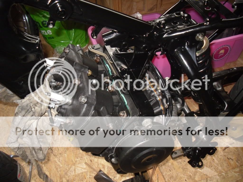

Gordi wrote:Image
Has it worked?
Hi Gordi,
perhaps I'm mistaken but it looks like you fitted the shortest kips-rod on the lhs? It's supposed to be in the middle. (two rods are of the same length, the third one is shorter).

KIPs
Post by Gordi »
Thanks a lot, Charles. I would never have noticed. Things like this are why this site is invaluable!!!

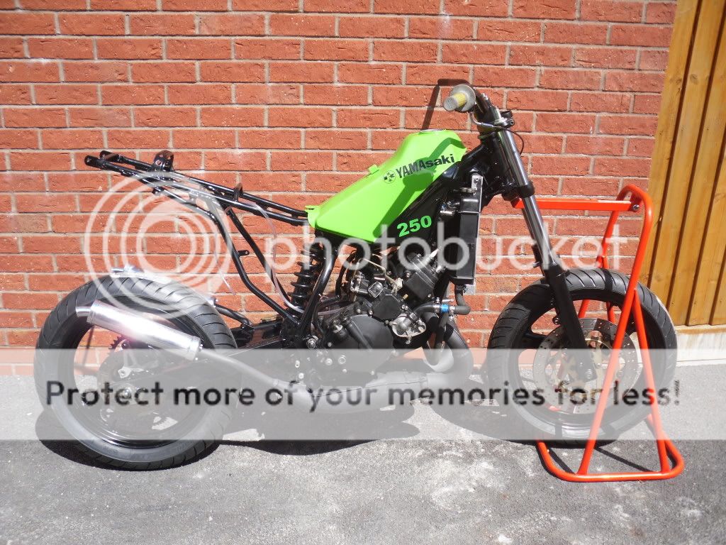

Yamasaki
Post by Gordi »
Thanks Scott. Just wiring and brakes to sort out now. Oh, and get the seat recovered (it's blue). And an insight on how to set up KIPs. And some spacers for front wheel and disc. And then a very benevolent MoT inspector!
smithyrc30
Posts: 287
Joined: Thu Oct 26, 2006 11:49 am
Location: Torquay, Victoria, Australia
Post by smithyrc30 »
That looks the dog's tadgers.... =D>
What is the finish on the engine?
It makes it look like a full on 2010 bike.
Gordi
Posts: 149
Joined: Sun Oct 25, 2009 10:29 am
Location: Gloucester
Yamasaki
Post by Gordi »
Cheers Smithy. Engine finish nothing special, just Screwfix "No nonsense" heat resistant black. Had to be acid etched first.
