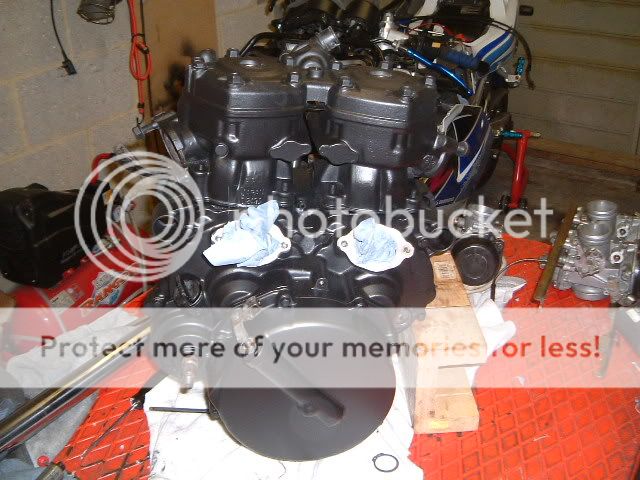

frame
Post by dougindoors »
yes, under the skin the frame is made up of 6 bolt together parts the swing arm being in 2 parts, bit like aluminium mecano , the rear sub frame is not fitted in photo. the whole thing is a bit of a balancing act to reassemble. you can see by the welding these frames were put together by hand not on a standard production line even down to drilled drain holes to stop it filling with water. engine in next!

Hi Doug,
A stunning bit of kit 8)
Great job with the restoration, keep the photos coming =D>
Bernie :D
Re: frame
dougindoors wrote:engine in next!
Hope you havn't bolted those barrels down yet. [-o<
