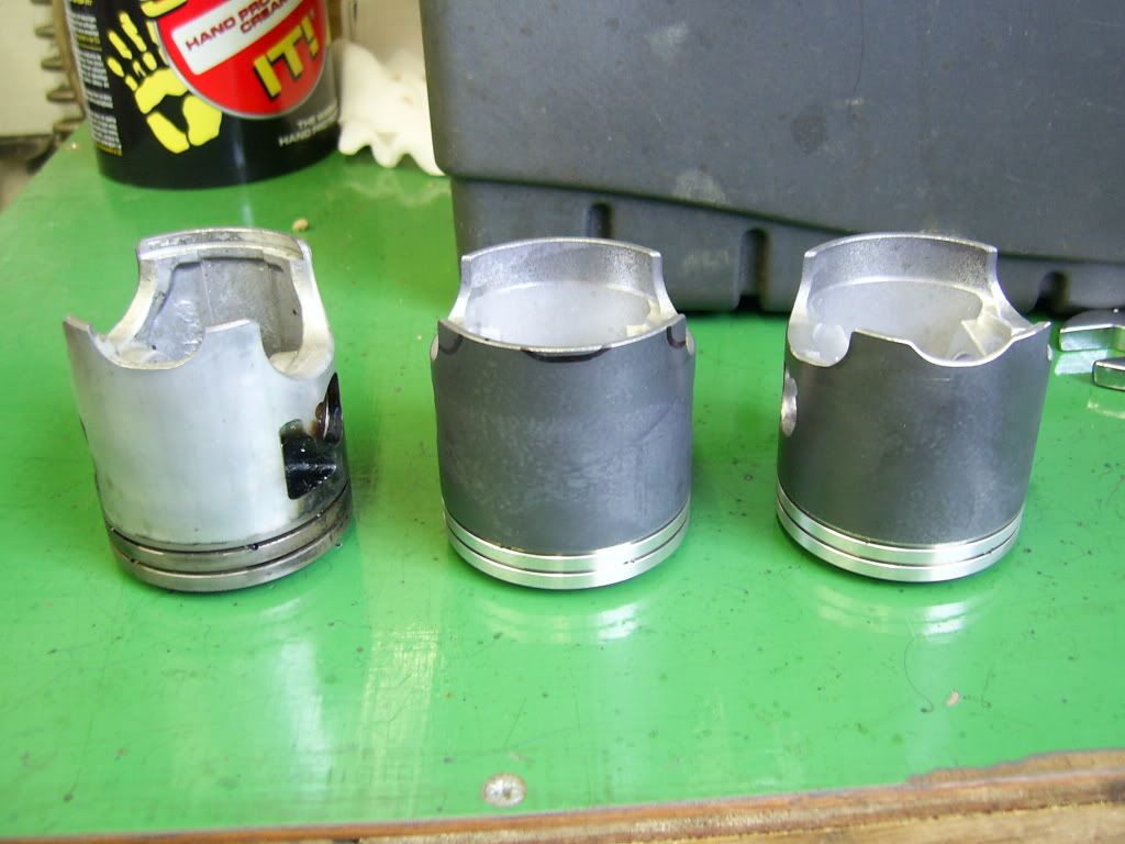

the cutaways in the DT125 piston are so big, that when they are at the level of the boost/transfer ports they create a bridge between them. That way there is a direct connection between the exhaust and the cranckase when there isn't supposed to be oneRocket wrote:what do you mean by " short circuiting"

I'm just trying a pair of Wossener KDX pistons, I've cut the skirts slightly to match bottom of the barrels / original pistons.
The lube holes aren't quite in the right place though so they open to the exhaust port briefely!
Look ok otherwise so I'm going to try them

Mark as Jan says the indents on the side of some pistons can allow gas from the transfer and the KIPS port to mix or escape.Rocket wrote:what do you mean by " short circuiting"
The problem is not confined to just the piston indents, even if you have a piston with no indent in front of the piston pin, the piston pin hole sits across the KIPS and Front Transfer port. From memory a 'short circuit' occurs for 12mm of piston travel - 25% of the stroke.
has your exhaust port been widened ?

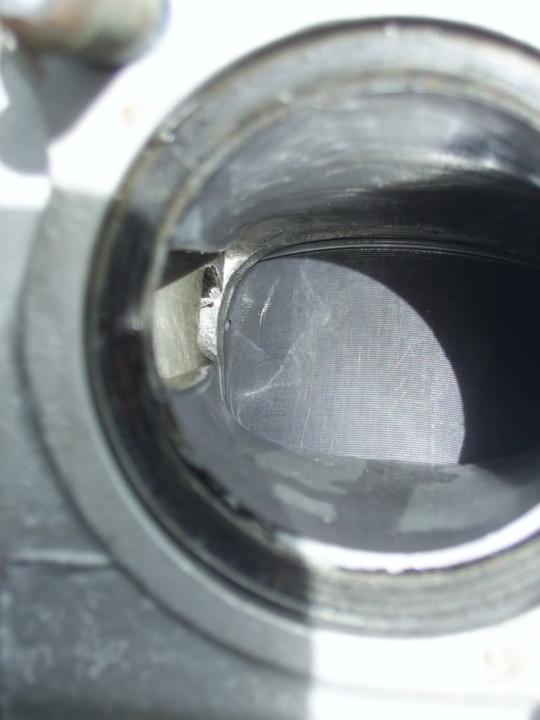

picture on the forum of a KR1 cylindre. you can see clearly the side of your port doesn't go straight down, so it must have been widened bye someone who didn't know what he was doing

They are KR1S barrels, origanaly tuned to stage 3 by stan stevens and I havent changed any thing drasticly on porting since buying the bike. The holes in the wossoner KDX piston are diffinatly slightly different postion compared to genuine kr1s. Maybe useful to have genuine kdx piston to compare?

still : your exhaustports are too wide I recon
