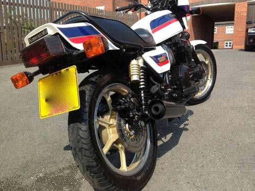

Nice job there Bernie,i need to change my transitions lenses,it's soooo bright
Fingers crossed i may have your clipons finished this week [-o<

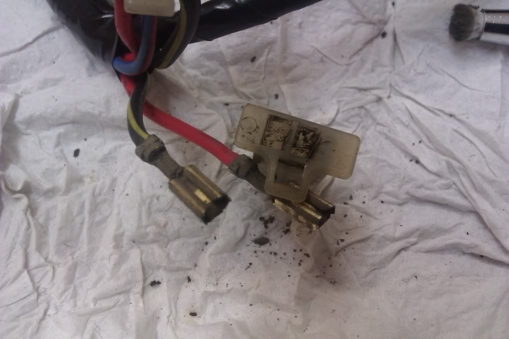

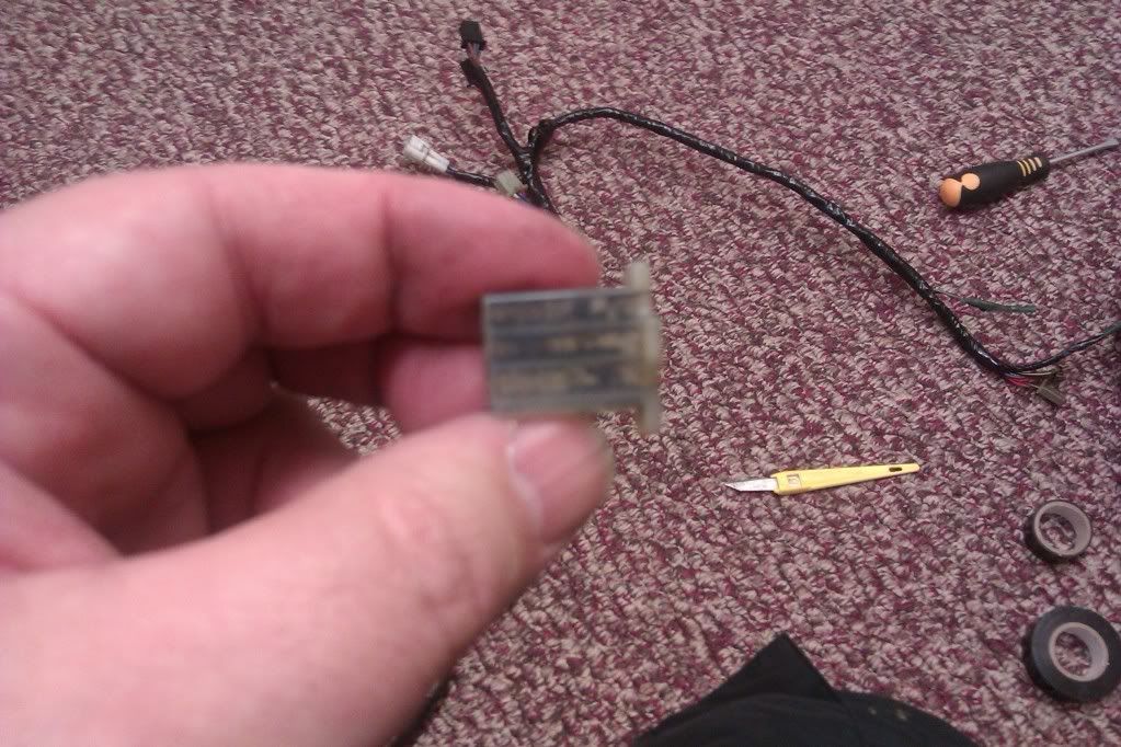

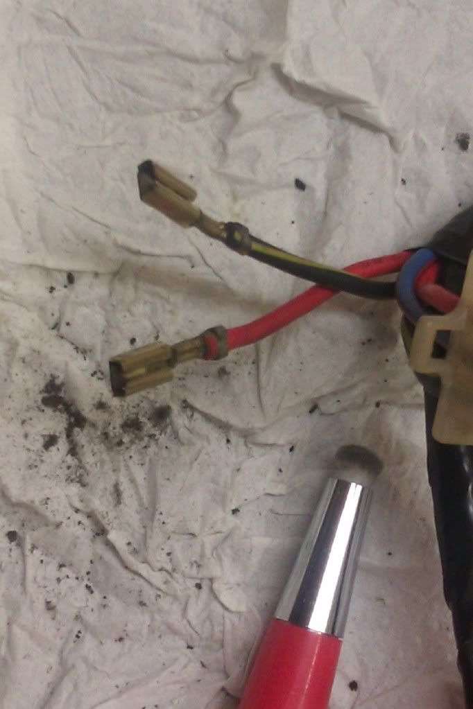

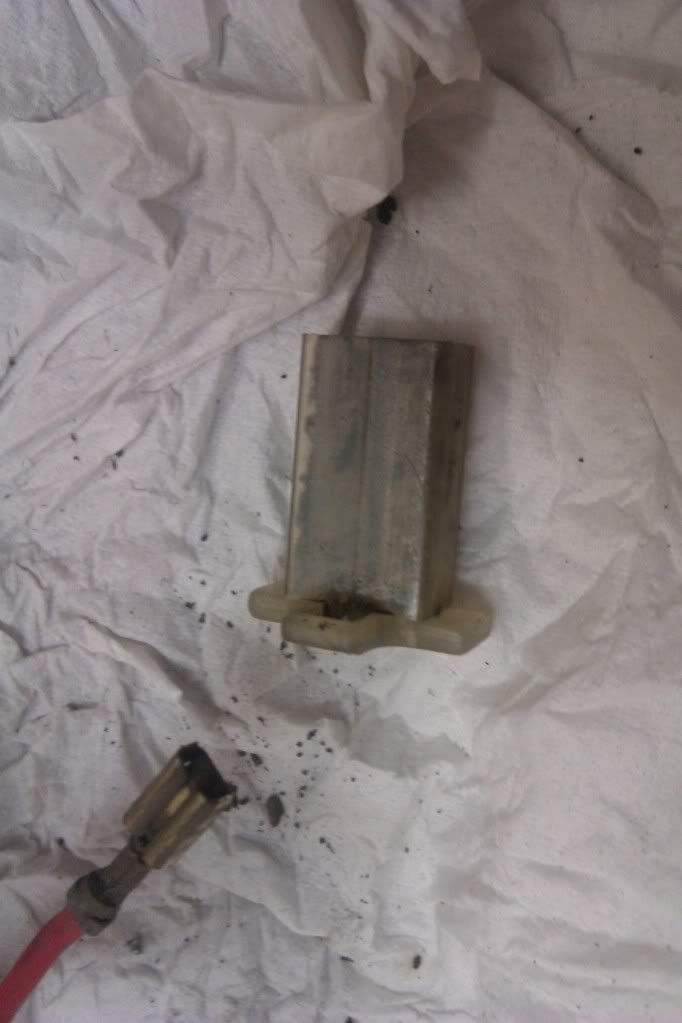

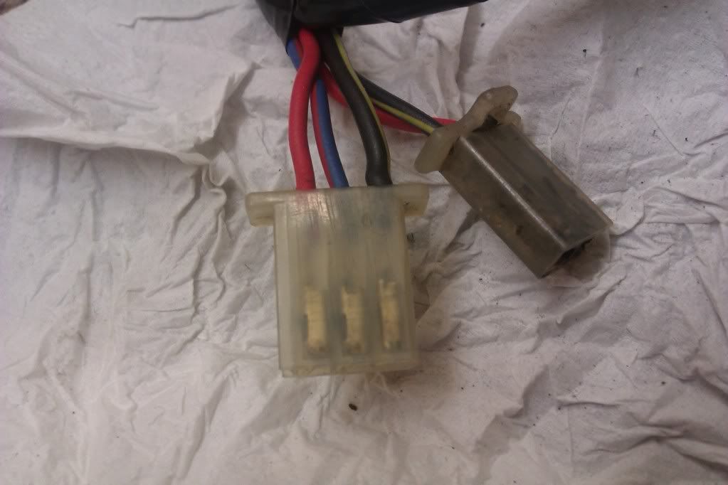

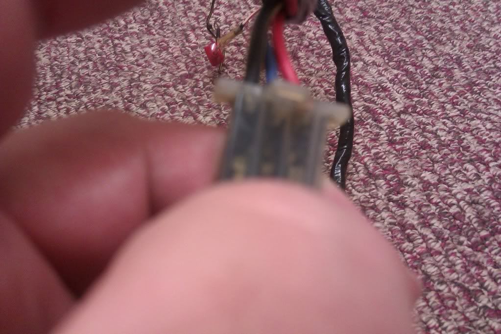

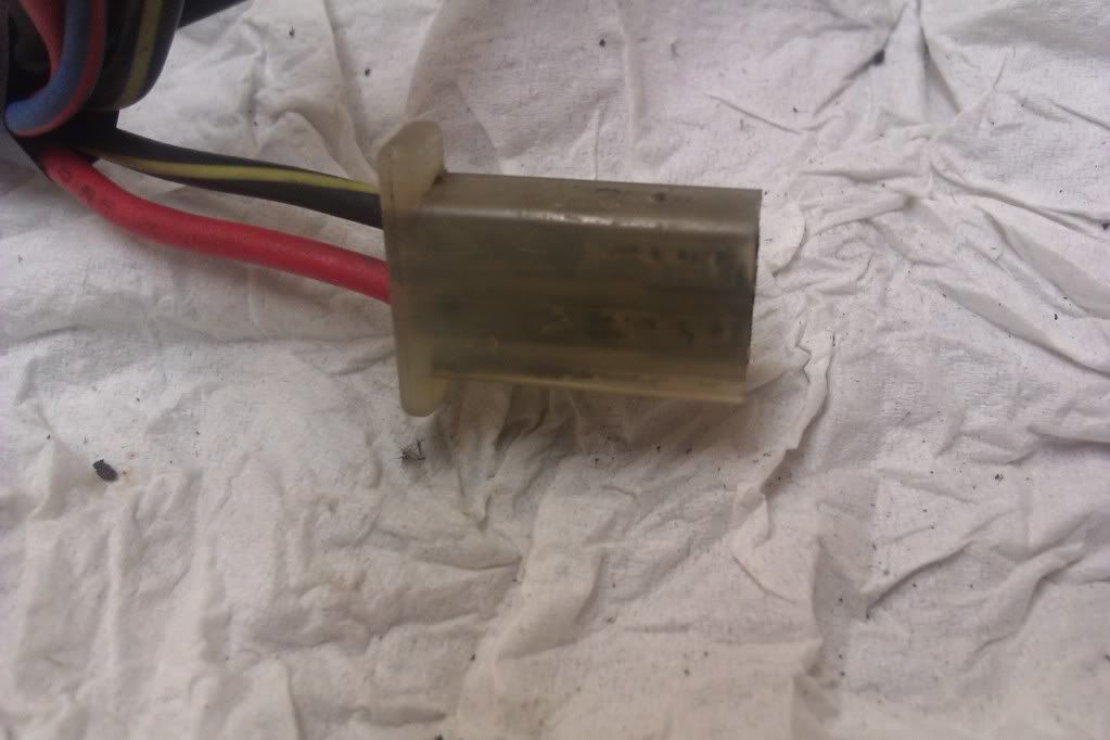

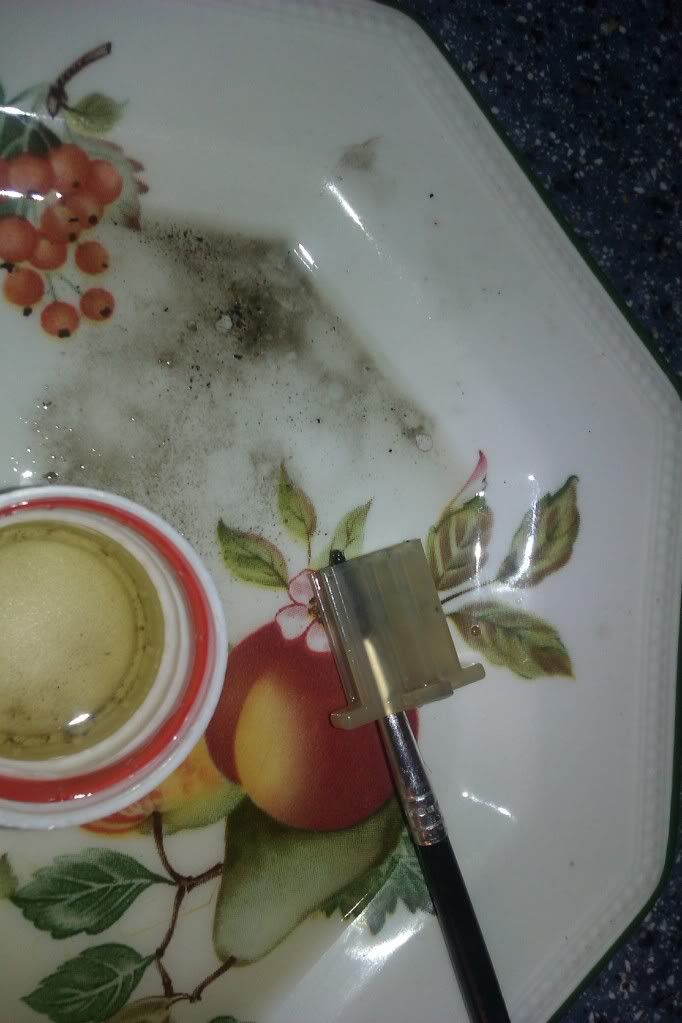

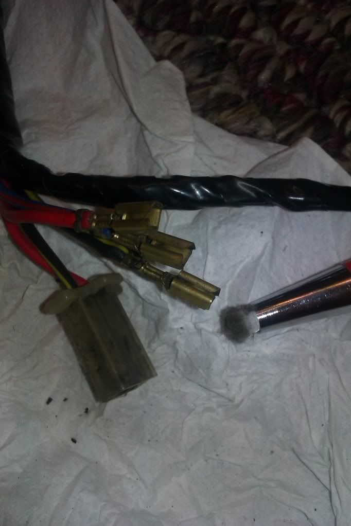

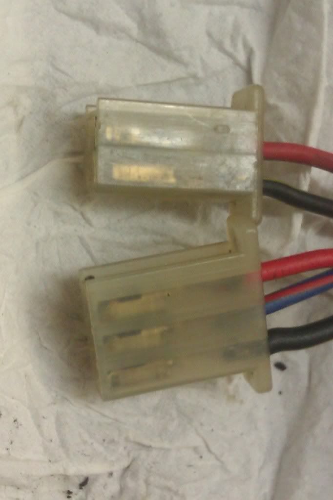

Before I put the wiring loom in place I am taking the connectors out of the blocks, so that I can clean the contact block body and the contact surfaces.....some are still a bit dirty
The contacts can be removed by gently pushing a small flat blade screwdriver in the small groove under the front of the contact (this lifts a small locating tab and you can pull the contact out of the back of the block)
I use a solvent cleaner and a small brush to flush out all the crud...
I then clean the contact surfaces with a fibre glass contact cleaning pen...
It is then reassembled.....
And on to the next one.....
Still a few more to go.....

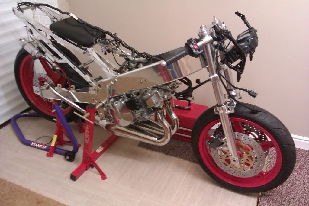

First time I've been on the forum for ages Bernie and you have damaged me eyes500bernie wrote:I am pleased with how it is looking so far
I will finish off the wiring loom during the week.
Like a welding flash.
How ya dee'in anyway?
- Posts: 3403
Hi Paul,
Great to see you are back online
The bike is coming along at long last, I nearly blinded myself when I took a photo without turning the flash off
I am glad I have finished polishing bits as I knackered my polishing arm lifting/fitting some french doors
Have you started on any of your other projects yet?

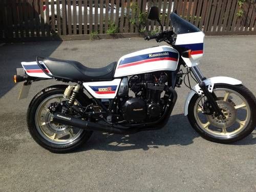

Just had another look at the White 1000Rs....
And the Kerker is not as big as I thought it was, but still big enough to put a smile on Michael Barrymores' face
P.S. The White ones are the best, they look a lot quicker than the green ones

you'll probably have to do something with that left pipe to stop the chain from eating it, but my experience with standard configuration is limited so I could be wrong.
- Posts: 3403
It looks very close to where the standard pipe was, but we will see, not ready to put the chain on yet.

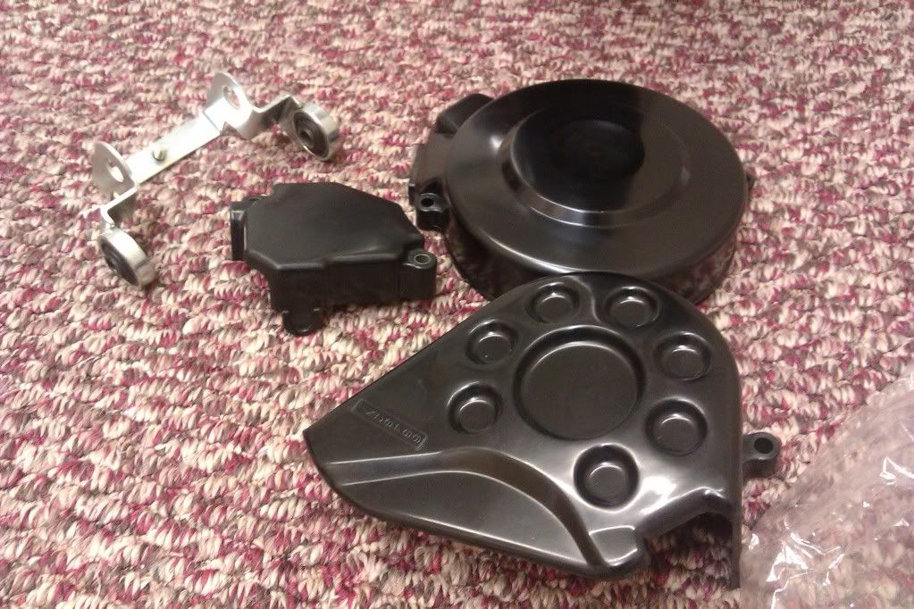

I still have a new front sprocket to fit, and change all the plastic engine covers for new ones
