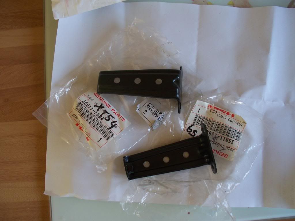

martin wrote:next time you are down my way Bernie, heres a little something for you.
they are new old stock. but the only problem is they are not polished :) :)
Dont worry Martin , after two nights with Lenny in a Premier in Bernie will have polished em with more Carnuba than you can shake a stick at!

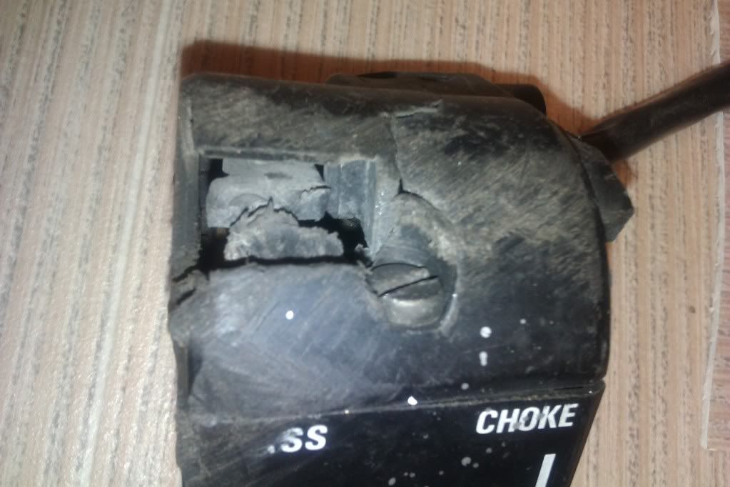

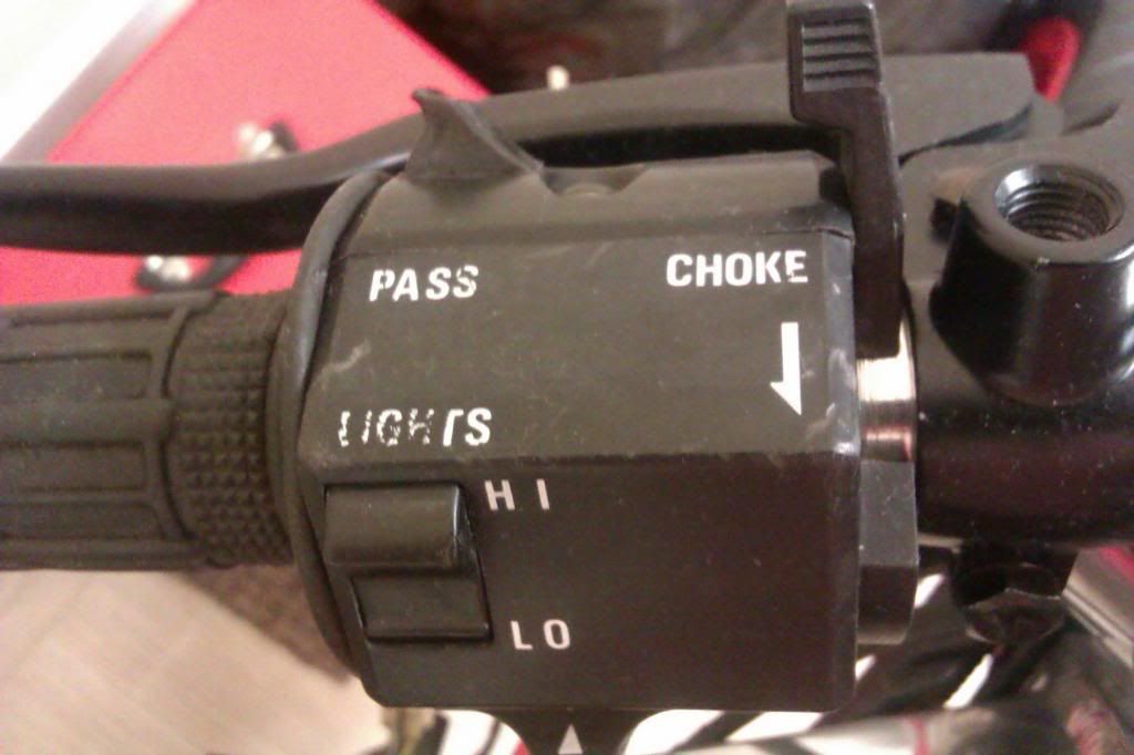

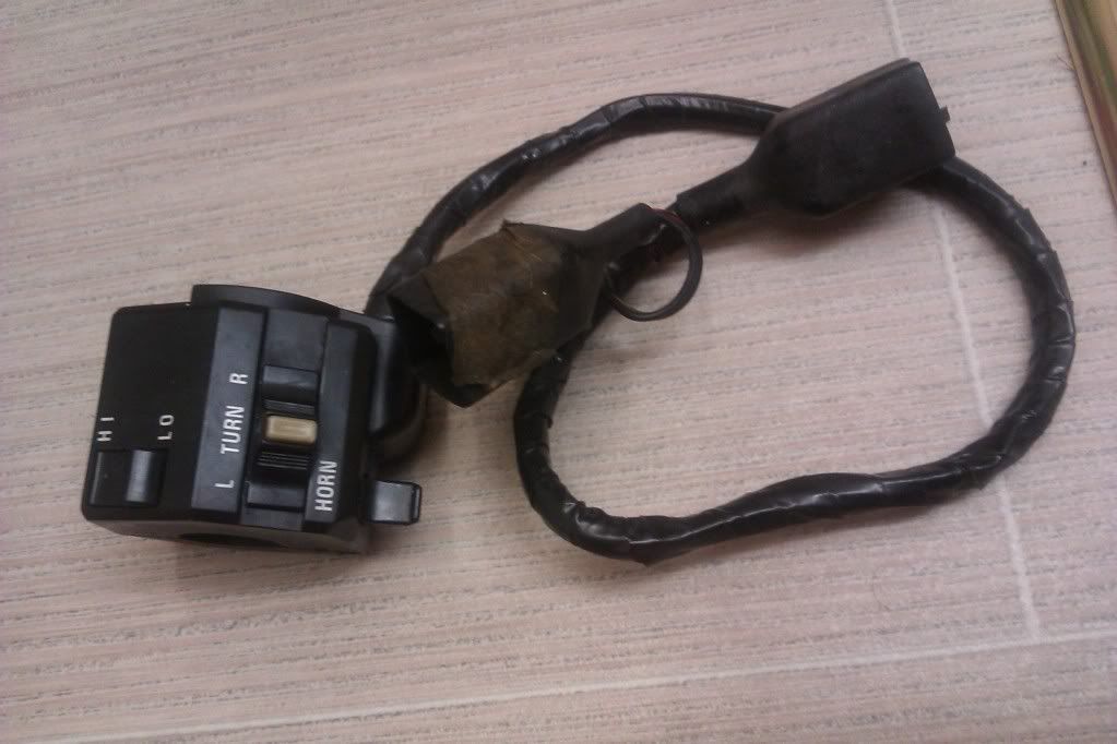

My left hand switch unit has seen better days
I had a new replacement unit, but I accidentally chuck it and a few other items in the bin while I was having a clean out :shock:

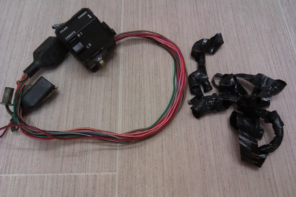

I have a couple of knackered spares, one with very bad road rash (but good switches and wiring except the pass switch which is totalled)

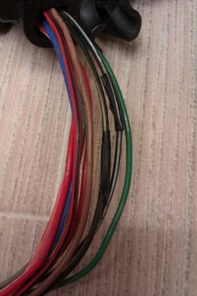

The other one has had the wiring tampered with, as it is wound in electrical tape, so I expect broken wires have been repaired.
Tape removed, repaired wiring found :)
I only need the body and the indicator switch.

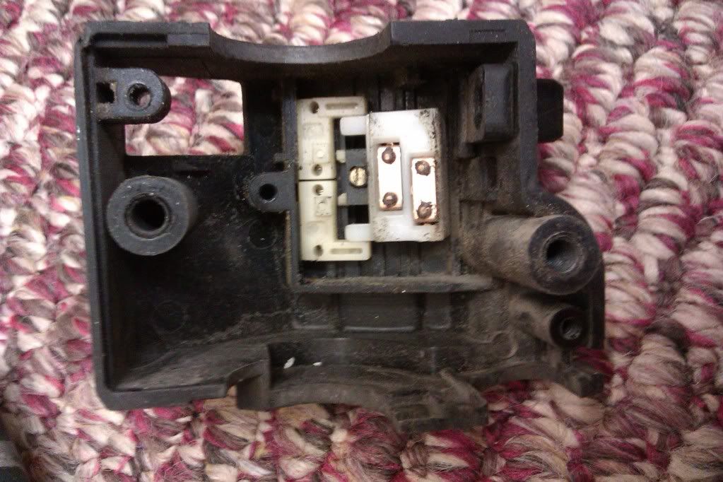

Good for me the come apart, the springs in the indicator switch are a bit fiddly...
The two small white parts have a compressed spring on the underside that sits in a small groove.
If you remove both of them, plus the switch contact plate, you can then remove a retaining clip for the indicator switch.
More later :)
