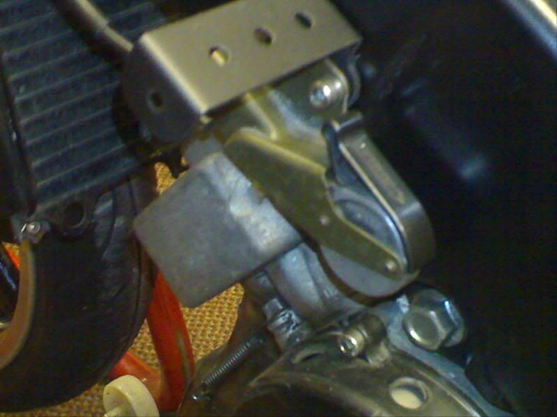

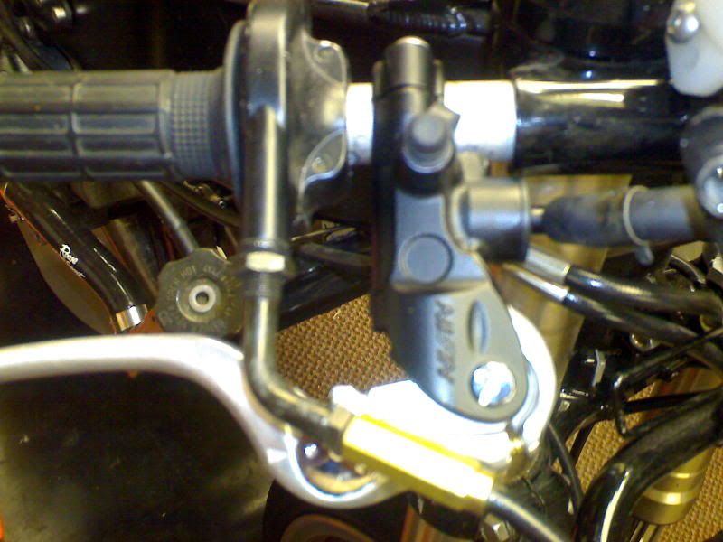

Did not want to ruin a good left hand switchgear on my hybrid, so i moved my choke lever...
Used a fzr400/600 choke lever assy works fine...

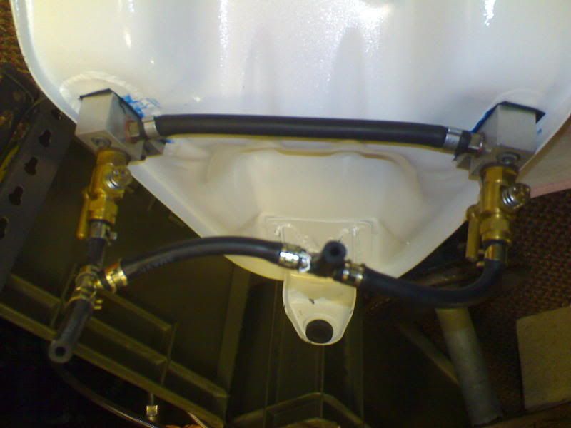

fitted radial master cylinder, 02 Blade calipers and finished twin tap tank mod....

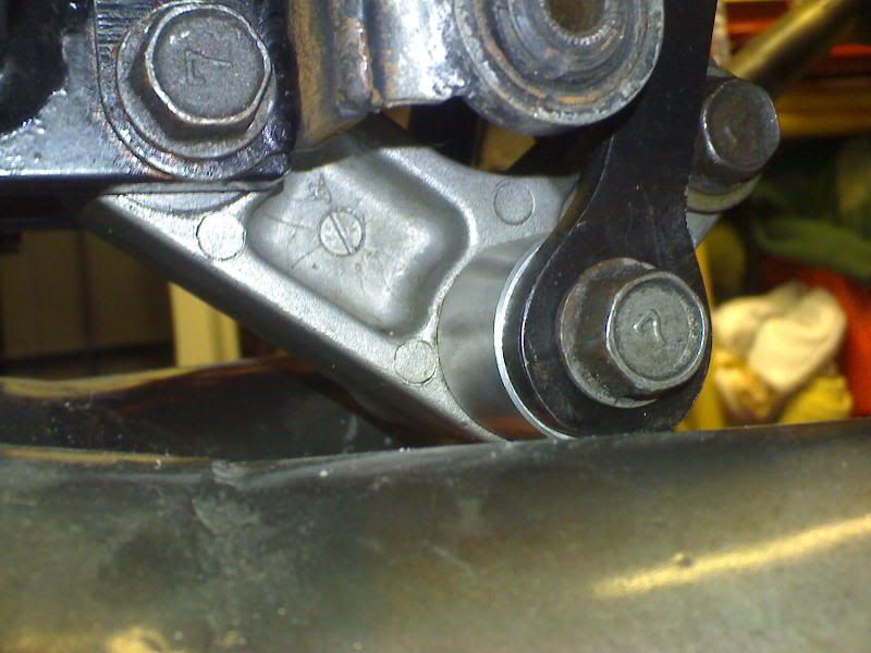

Just how hard is it to get the RGV arm in?

not a great problem really mate i just made spacers up to fit inbetween the swingarm and frame, then (using the kr1s shock) i used the std kr linkage but made up spacers so that it mimiked the rgv dimensions (ie two either side of it,different widths as the rgv mount is offcentre, and a bar thru that allowed me to use the rgv bolts) then just had to extend the rgv tie bars to fit..
i have a steel spacer unning through the kr1s knuckle it is 85mm long.20mm ext diam and 12mm int diam (for rgv bolt)
the outer spacers are alloy and are both 35mm ext diam and >20mm int diam but as the rgv swingarm fittings are slightly off centre they rt hand spacer is 21mm and the left side is 24mm.

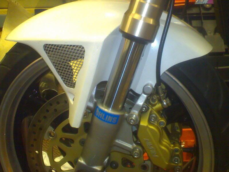

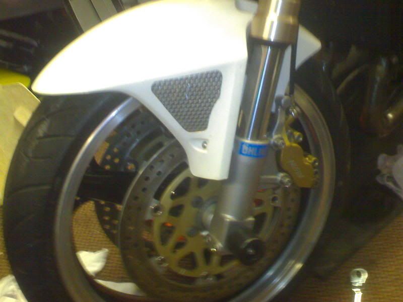

modded front mudgaurd fitted,brakes bled front end complete...

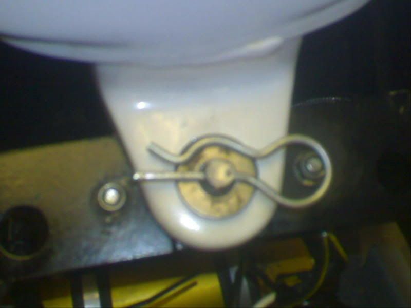

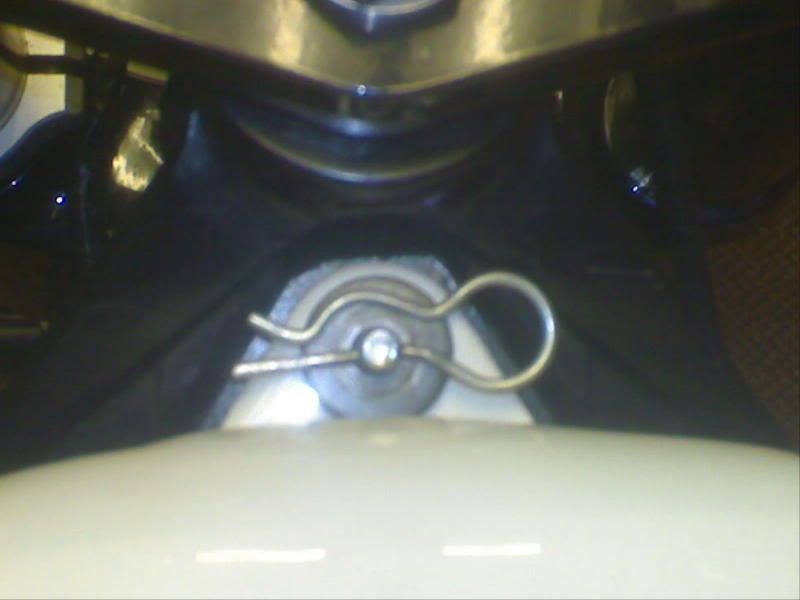

kwik release tank mod.....

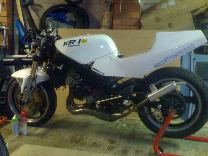

Would love to go to brands but work is getting in the way of everything, cant plan anything,so will have to wait and see, hopefully book it last minute...(what gearing for rgv rear at brands?)
Put tank stickers on to let people know what it is...a KR-1S..
Got a nice fat spark....She is ready for fuel now.....

mgtkr1
Posts: 1402
Post by mgtkr1 »
quick pointer, ive done the q/release tank mod and the lare clips can catch your leathers, solution is to use a small clip on the rear mount that does'nt ''overlap'' the edge of the tank grommet. the bike is awesome btw, hope it goes a good as it looks!
