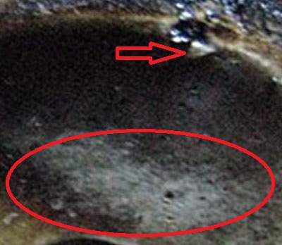

That damage looks like something has clattered around the combustion chamber at some stage, but no damage to the piston suggests it's old damage.
Take the power valves off and get rid of the gasket. If you have a steel rule, stick it across the head and check it isn't warped slightly. If it isn't, get the damage welded and cleaned up on that damaged combustion chamber.

the minimum you should do with that head, is filing away the "sticking out" points on the damages.
they can become so hot they act as a spark plug causing to early combustion and detonation.

@ Jarno and Dirk : there is damage and damage. as long as there are only some/even lot's of holes, that's not a problem.
but on this particular head, if you look at img 5860, at 1 o'clock at the end of th squish, that bit of aluminium sticking out might be a problem.
and I agree on actualy checking the gears for the waterpump : that it turns while kicking doesn't mean it's 100% ok.

I think you mean the sharp edge (arrow)?
the gray patch looks like a hot spot?
can also deceive..
cheers
can also deceive..

off course I mean the arrow.dirk wrote:Hello Jan
can also deceive..
cheers
little pits don't matter much, it's the little things sticking out that can act as an ignition point.
