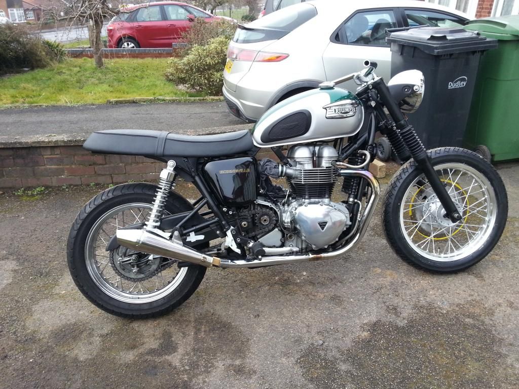

Looks the same picture but it's not :lol:
Thruxton Longer shocks,rebuilt forks with Thruxton internals,Thruxton 17 inch alloy front wheel,chunky fuel cap,fork gaitors and LSL "Clubman" style handlebars

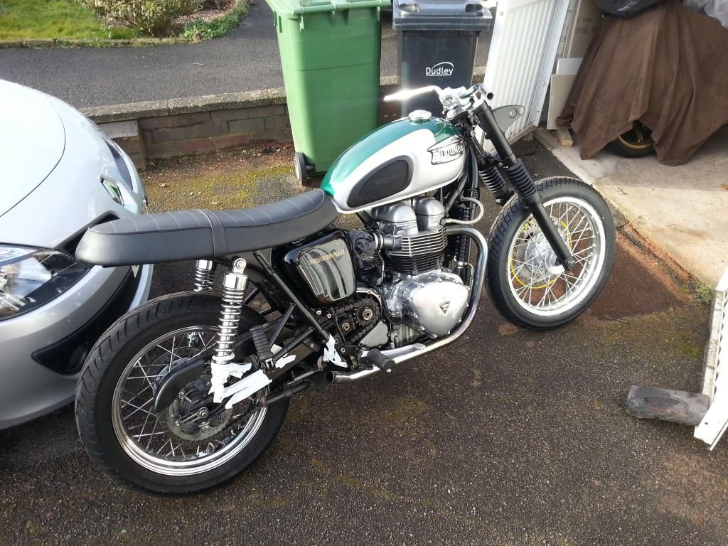

Post by headcoats »
Put in a Angel Eye headlamp like we fit in our LC's,still looks retro me thinks :wink:

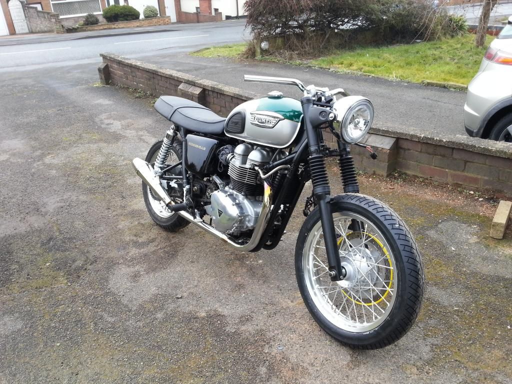

Post by headcoats »
With the Thruxton down pipes fitted it looks like the cheapo universal silencers have a better chance of lining up :P
Need a link pipe which will need to be angled and go from 1 1/2 diam to 2 inch :shock:

Re: Well it's Green and a bike !!!
Hi Martin,
Front mudguard and sprocket cover?
Posts: 2120
Post by headcoats »
Mornin Bernie :P
I will re fit the original sprocket cover but the front mudguard has been a bit of a pain :?
As I have fitted the Thruxton front wheel which is an inch smaller at 18 Inches the lugs on the forks to mount the fork brace/mudguard are now too high.
I hope to mount the mudguard "under" the fork brace to bring the gap down but the second hand mudguard I bought doesn't fit even though it's a Triumph Bonneville part :oops:
There is a model called the Bonneville SE which has cast wheels and the forks are set wider so the mounting holes are about 20mm out which I wasn't aware of #-o
