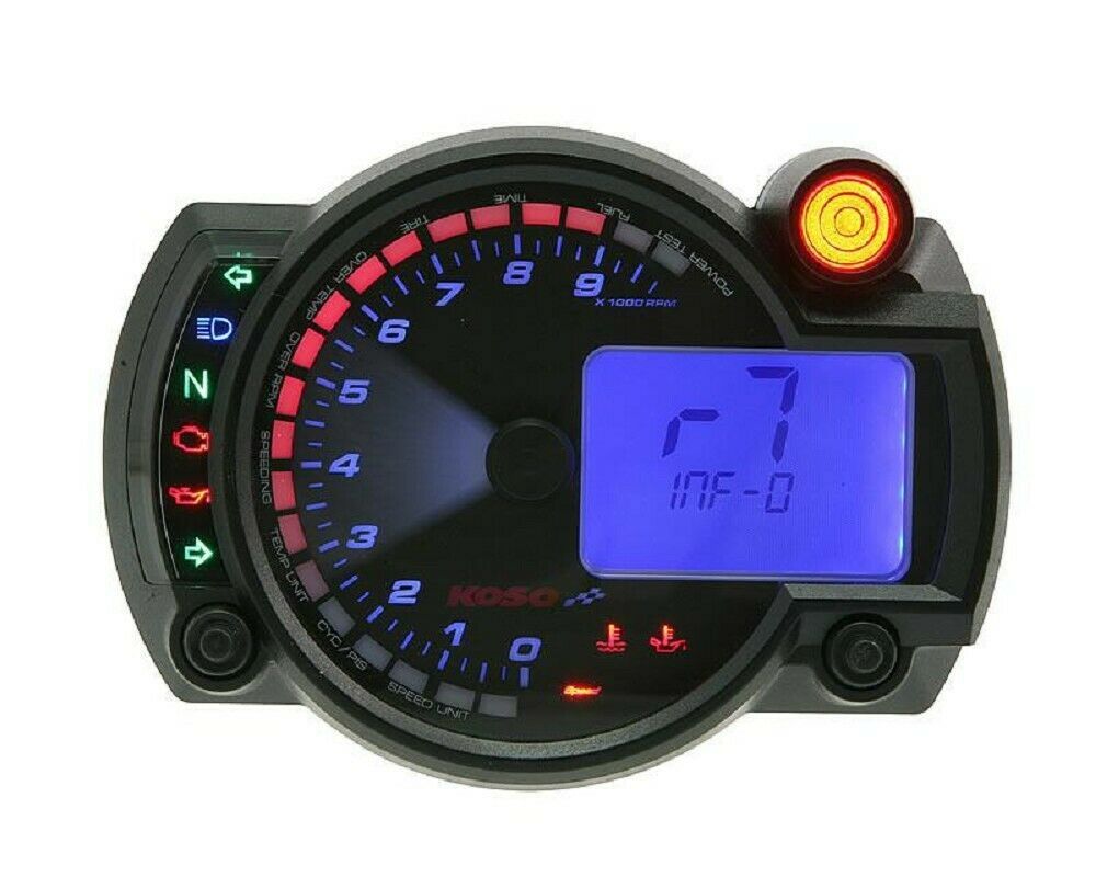

I promised to return to the subject of those Chinese dashes - I know this is of limited interest as most people will be doing fairly standard restorations but here it is anyway.
The clocks that I`m talking about are Chinese replicas of the Koso RX-2N dash. This is the real thing with a ticket price of around £250 -
The two ripoff versions are pretty close copies, same size, same look, same mounting but available for under £30 from ebay, Ali or Amazon -
- the two types look the same from the front but turn them over and the one on the left has a black multi plug, the one on the right a grey plug and `SS182` moulded into the casing. The other thing which will distinguish them if you are looking at a sales listing is the one on the left has 7 colour options for the backlight, the right hand one only 2.
This matters to KR owners because the one on the right (SS182) will work on a KR1/S, the other (black plug) won`t. The function menus are slightly different on the two models, the critical thing being that on the SS182 model you can switch the rev counter input from +ve to -ve, on the other it is fixed positive wave input and because the rev counter pulse from the KR1 CDI unit is negative, the tach simply doesn`t work.
If anyone is thinking of using this type of dash on a KR1 you are welcome to contact me and I will show you how to adapt the intermediate loom which comes with the dash to `plug and play` into the KR-1 main harness.
