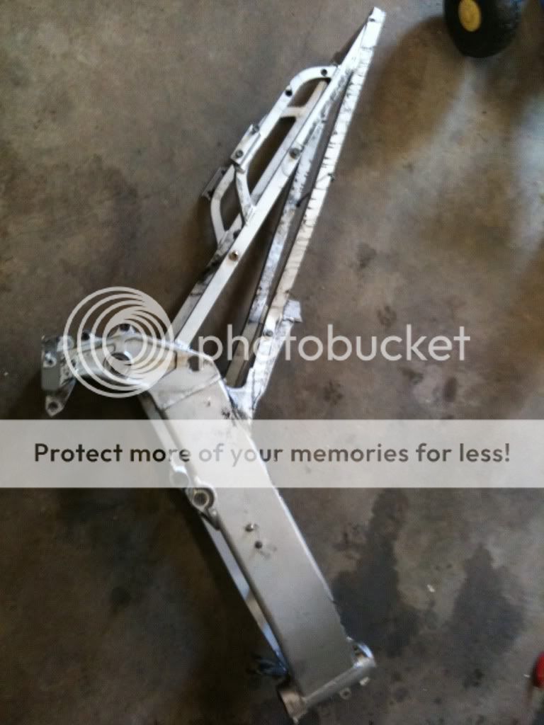

There are allways suprises too, like that crack in the frame.No it never ends

That crack in the engine mount is actually pretty common it seems. It's caused by the mounts being slightly wider apart than they need to be and being pulled inwards against the engine when the engine mount bolt is tensioned. The best way to avoid this crack re-occuring is to fit some appropriate thickness shims between the engine and the mount removing the stress altogether.

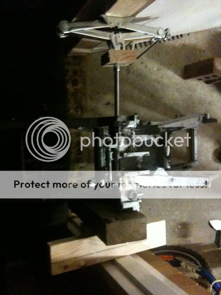

But had a bit of trouble with the swingarm bolt. Those bastard really got stuck in there. I sent it down to the local h***a dealer, but those dick couldn't get it out either.
A little bit of thought from a mate a magic.
F@€K you h***a techs
Almost ready to go off for powder coating.

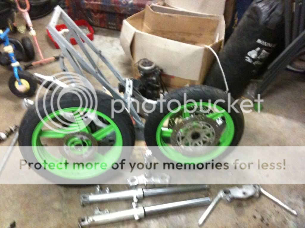

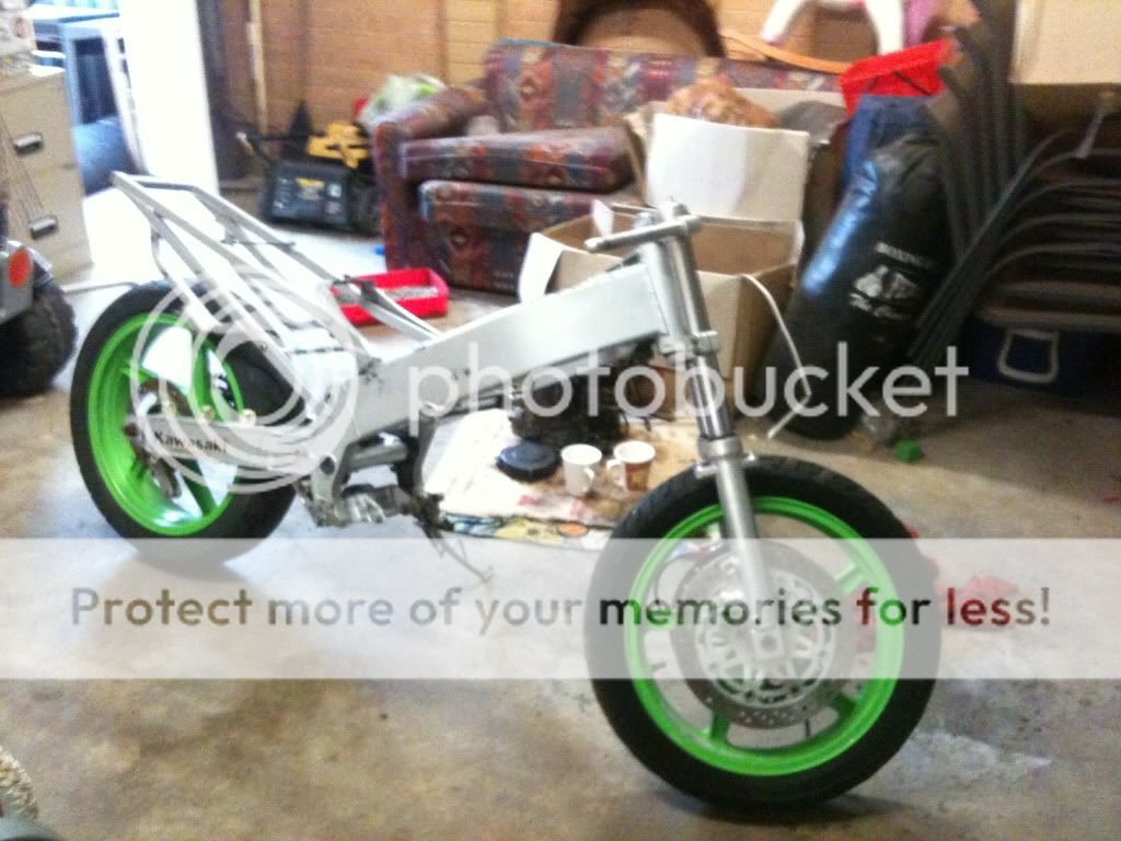

I finally did it I dropped all stuff down to the powdercoaters.
I've been thinking tires the last few days. I only seem to be able to find Battleaxes or Perellis and cost is around $400aud for the pair. What do you lot use and what's the cost roughly. I've had battleaxes before and wasn't really a fan.
