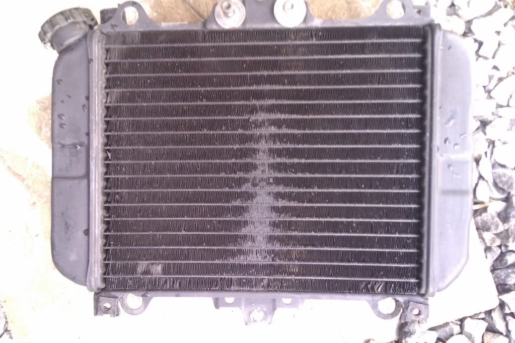

Hi Jan,
The back of the rad looks like it has been a target for a BB gun :(
straighten radiator fins repair
I use the clear plastic sealed packaging from items bought (tools, memory cards etc anti-tamper packaging) - I also collect this for mixing glues etc on.
Ice cream container lids are thicker (closer to fin spacing) and still flexible - cut this to suitable strips (pointed helps if when only part of the fin is bent) and can delicately maneauver into bent fin and lever back straight.
you may find you can push the strip all the way through helping straighten the opposite face of the radiator - better than a tapering screwdriver :idea:

yes, on the plastic. I use the side of an old oil bottle/can, just about the right thickness.
Also if you know someone with an ultrasonic tank that you can lie it flat it it works wonders, the dirt will fall out easily, but needs to be big enough to go flat, in my smaller one the rad sits vertical and it doesn't shift it anywhere as good

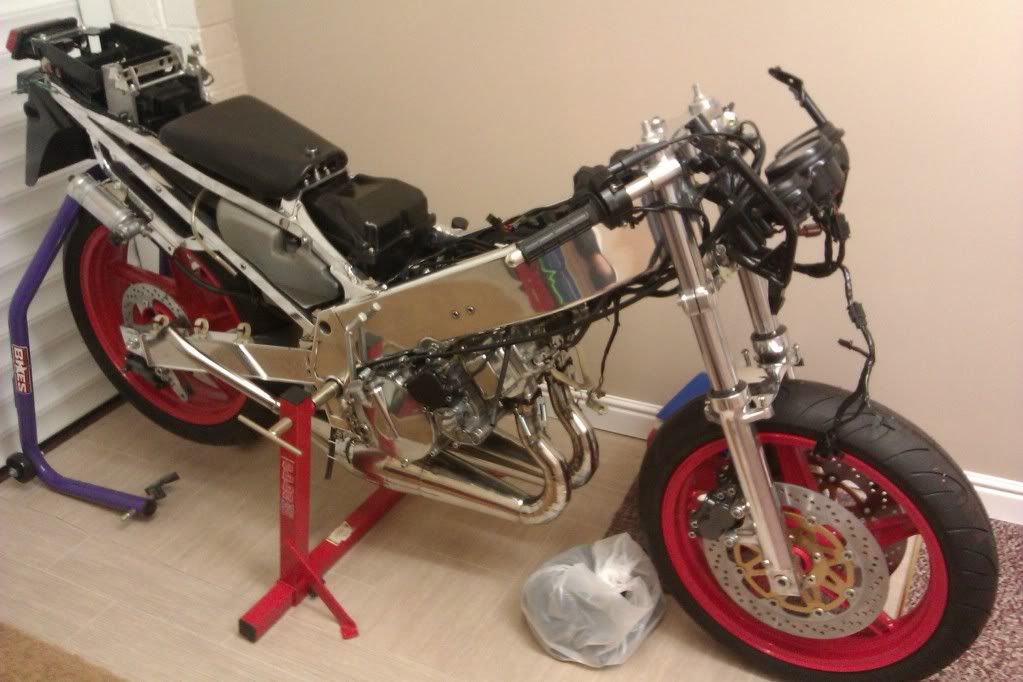

Got a bit more done....
Still not convinced I have the harness routed correctly #-o
Going to spend a bit more time on the scabby rad :oops:

500bernie wrote:Just having a go at cleaning and tidying this up...
I have soaked it in hot water, brushed it and it still looks crap :cry:
I am not giving up yet (but I am not far away) ](*,)
That mud splash on the rad is a right git to get out, soaked in cleaner for 24hrs, jizzer actually. Then washed carefully scrubbed blew out with air line took a few attempts to get it clean cheers

Good results with the steam cleaner :)
Two big black marks on the patio that need sorting out now :(
Need to plan a quite evening at a premier inn to sort out the bent fins.
