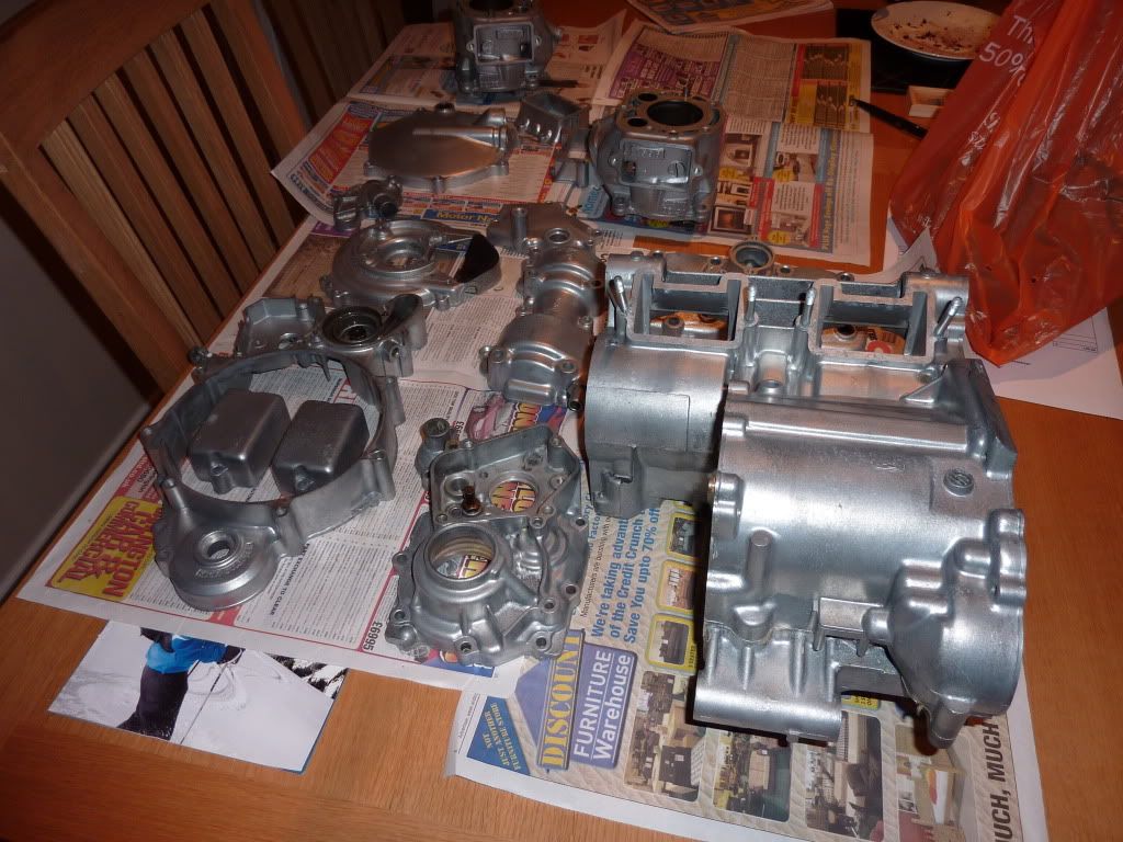

Right I've done it the cases have gone to be vapour blasted.Had to I've tried every means chemical and mechanical at my disposal and they still look crap,so they've gone.
Now then when they come back and the garage warms up I want to repaint the outer cases,am I right in thinking its clutch,inner and outer,waterpump cover,res chambers that were painted.many thanks.

Maccas thats all interesting stuff.The rebuild fund has enough wedge in it for the vapour blasting and a bit more after that then things will come to a standstill for awhile.I might well do some work on the cases its not something I'm familar with but I know someone who can help,thanks Paul

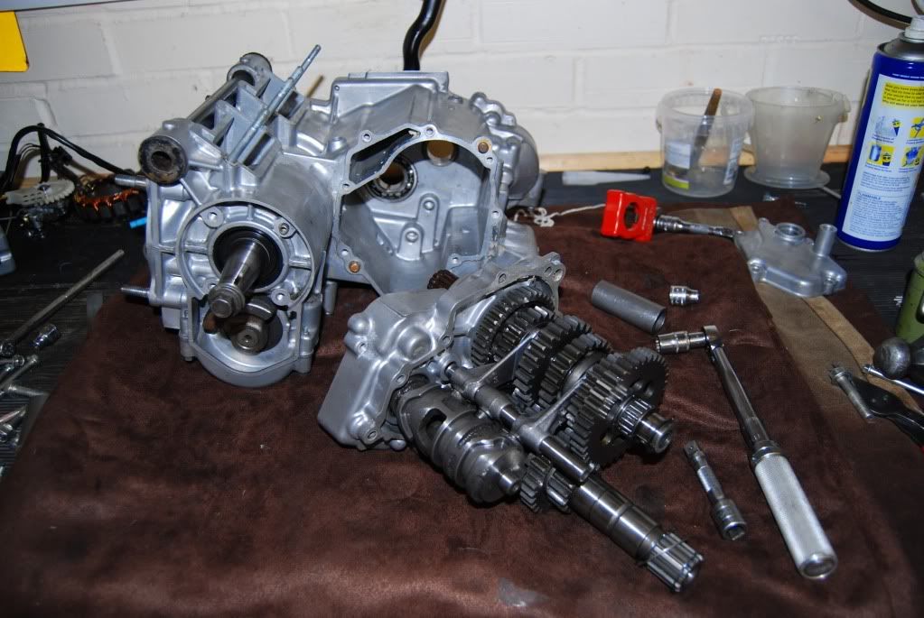

After a long lay off I managed to make a bit of progress with the Kr1S yesterday
A while ago I stripped and repainted the front calipers and discs,again
Refitted the discs,but I,ve still to rebuild and refit the calipers.
Finally started rebuilding the motor.I've had the cases back from the aqua blaster since January. I must have had the recon crank back since July,ish,a bag of new seals bearings etc and replated fasteners from about the same time.
I still need to get the barrells replated but I've been spending project money on the ELR,buying stuff that I know I will need when the time comes to restore that.What do you do tho
when stuff come up sometimes you have to dive in
The bottom end is just about done and hopefully funds will soon be available to do the top end.
