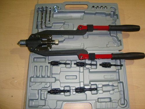

just stumbled in ,give us a shout ben if you need any nut inserts for subframe

wasnt that why you should do double shear? all my linkages are double shear on my ypvs to be fair just in case. Rivnut kits are pretty cheap by the way its only like a pop rivet but just leaves the nut in place in the hole if that makes any sense?

Hi Ben
just ordered this so if you need to borrow it you know where i am
