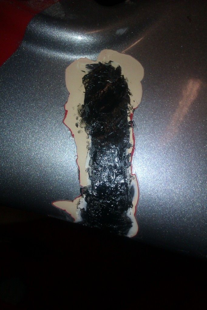

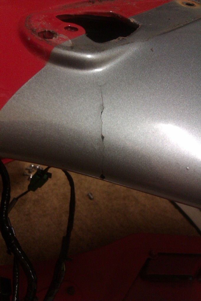

He did not have enough time to do the plastic welding (as he was almost fully booked up before his holidays), so I have been entertaining my self with a soldering iron....
Left hand side of top fairing.....
Rubbed back and cleaned with solvent...

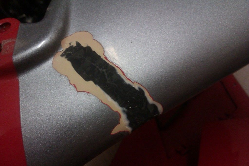

Given a good seeing to with the soldering iron....
I will smooth it off later, then rub it down to a good finish
Back to the soldering iron

I see they have been painted before? That looks like some filler in there as well!!
Good job! The solder does a good job, plenty of melting!!
