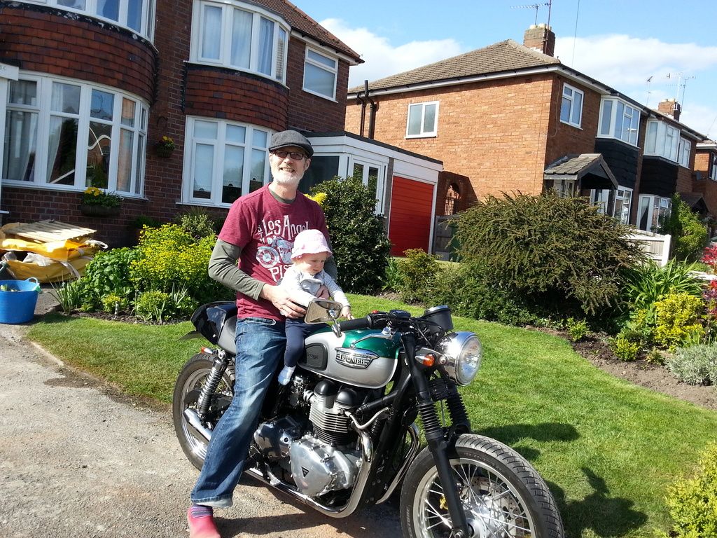

Been to you know where today
They do 54bhp standard so was o.k. with the result at 61bhp but for a nearly 800cc engine it is pretty paltry
Torque isn't much better
but feels better on the road than it suggests and apart from as mentioned a bit strangled at the top I really enjoy it
Super rich at the bottom and weakens out a bit in the middle but main jet seems o.k. at #135 which was 2 sizes up on what they recommended
Needles already have 2 shims under them and when I got back I turned the fuel screws in from 3 1/4 turns to 2 1/2 but didn't want to idle evenly
So not sure what to do there and last run I told him to take it to the rev limiter to see if the modded ignition box said what they had programmed
As I have no tacho I was 90% sure it was hitting a wall before the limiter but the dyno showed otherwise
Still revving it's nuts up the top so going to go another tooth up on the front sprocket
Plus as it's making roughly the same power as an LC then the other option is to make the bike lighter
Already dumped the heavy mudguards and exhaust system and changed the heavy steel chromed front wheel to the alloy Thruxton ,removed centre stand, the air injection system
Can't really do much more maybe get the Thruxton alloy rear wheel, change the metal side panels and chain guard for plastic ones
