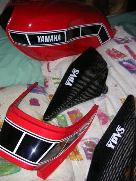

Paint back from the sprayers
Looks the same but not the 15 plus year old chipped,faded paint that was on it

Looking at all the previous pics, it was always going to look THAT good
=D> Is it as close as it looks to finished.......I think I'll have to blatantly copy your wheels ..............I mean it Alan

Thanks for the replys
There is still lots to do,electrics being the main one and i'm waiting for my end cans as i damaged one when the bike fell over in the garage
I still haven't had it running so it will need setting up with the KR carbs ,Ramairs and running premix
