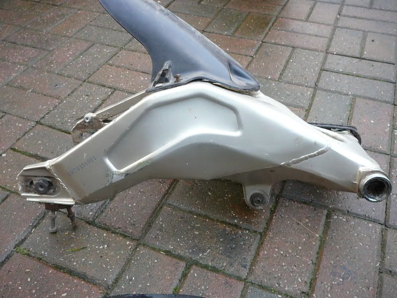

Anyway, my szr swingarm turned up today, here it is

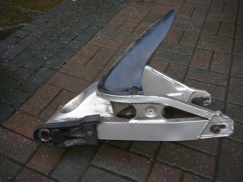

other side
Initial looks show that it's a fraction wider than a KR one, but there is loads of metal available to remove on either side without impinging on the bearing positions. Looks like the bottom linkage mount is identical with the 4dl one (i.e. in the same relative position as the KR, but about 10 mm wider) som my thoughts on that was to use the KR dogbones with 2 spacers and a longer bolt.

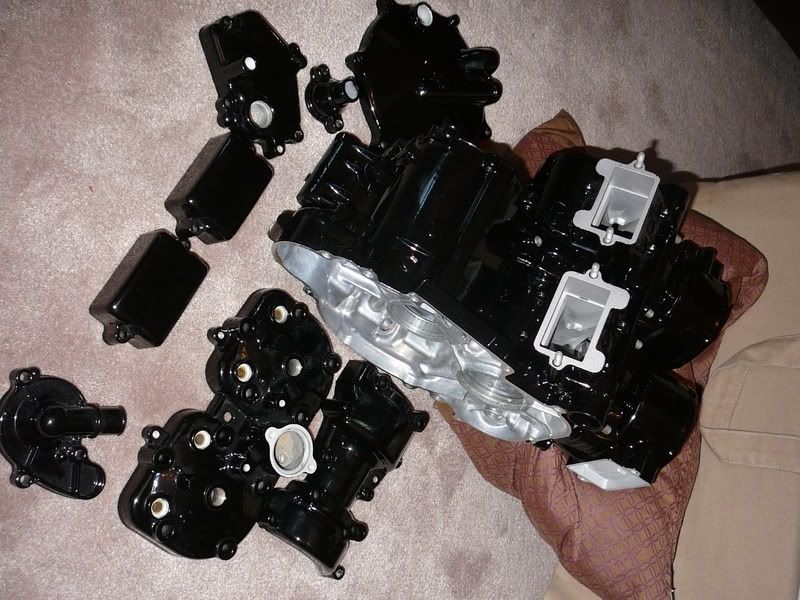

Got most of my engine cases etc back from Triple S, so it's time to get the engine rebuilt, but here's a taster of what it'll look like
Engine in the front room and the mrs doesn't mind, d'ya think she'll let me rebuild in there? :lol: :lol:

Seemingly, they must mask off parts before blasting as the insides of the cases, barrells, head etc are completely unmarked and as they were before.
On one of the parts there is what looks a bit like a bit of resin, I'm just guessing here, but would think that all the mating surfaces are perhaps brushed with a liquid that goes 'off' to create the mask, then peal it away after coating? Dunno, but can't imagine doing it with tape.
Hopefully it will end up a nice tidy engine with an easy to clean surface. :lol:
