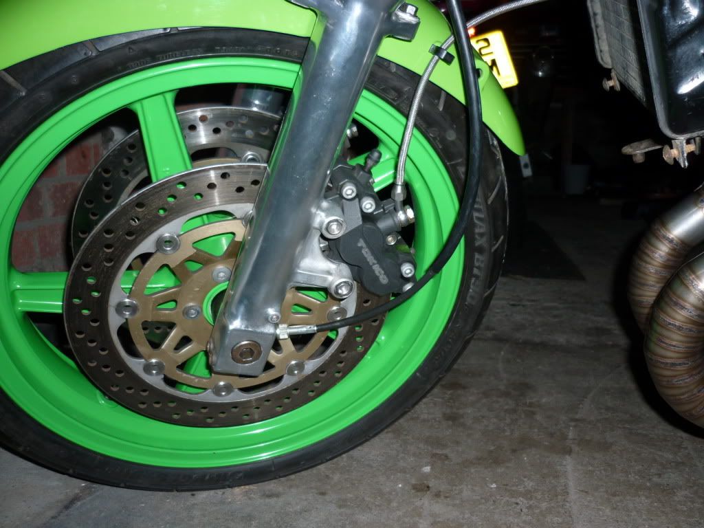

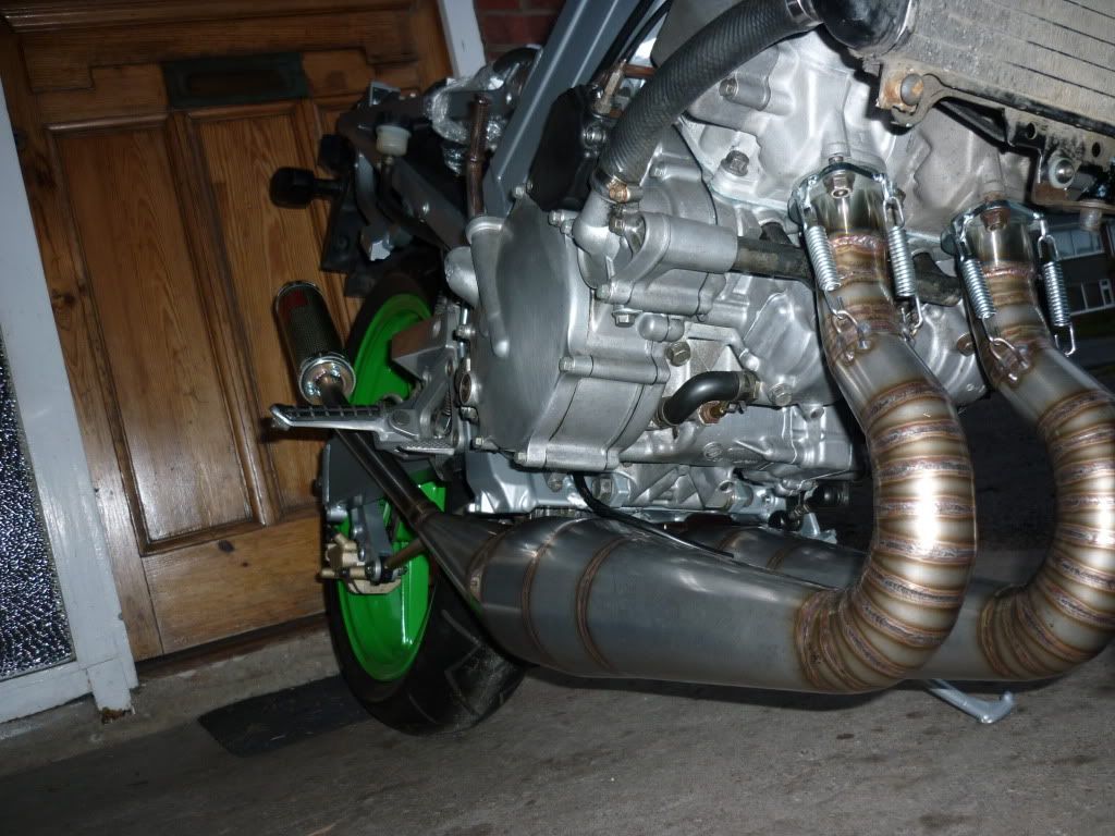

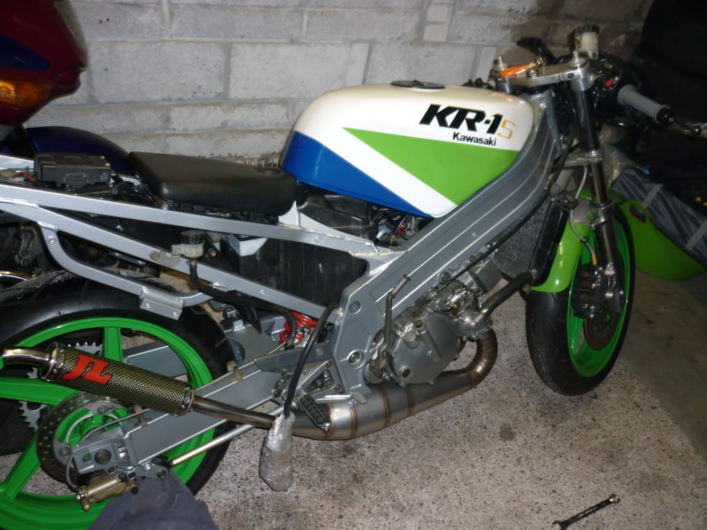

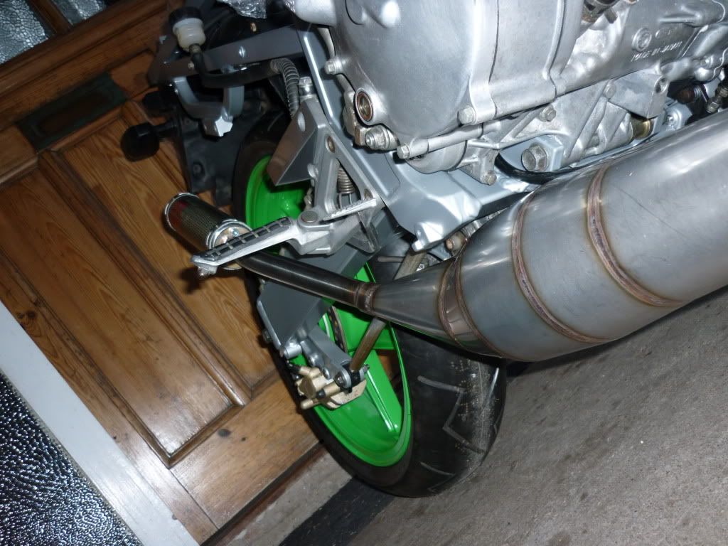

Yep that sounds right bernie, the confusion is with the f3 powervalves. I haven't been able to make a vid of the valves from up the exhaust but i have done more to the bike:

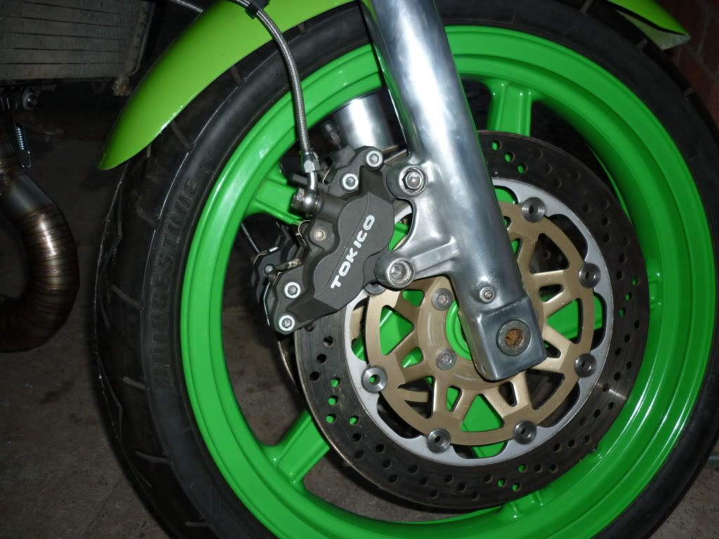

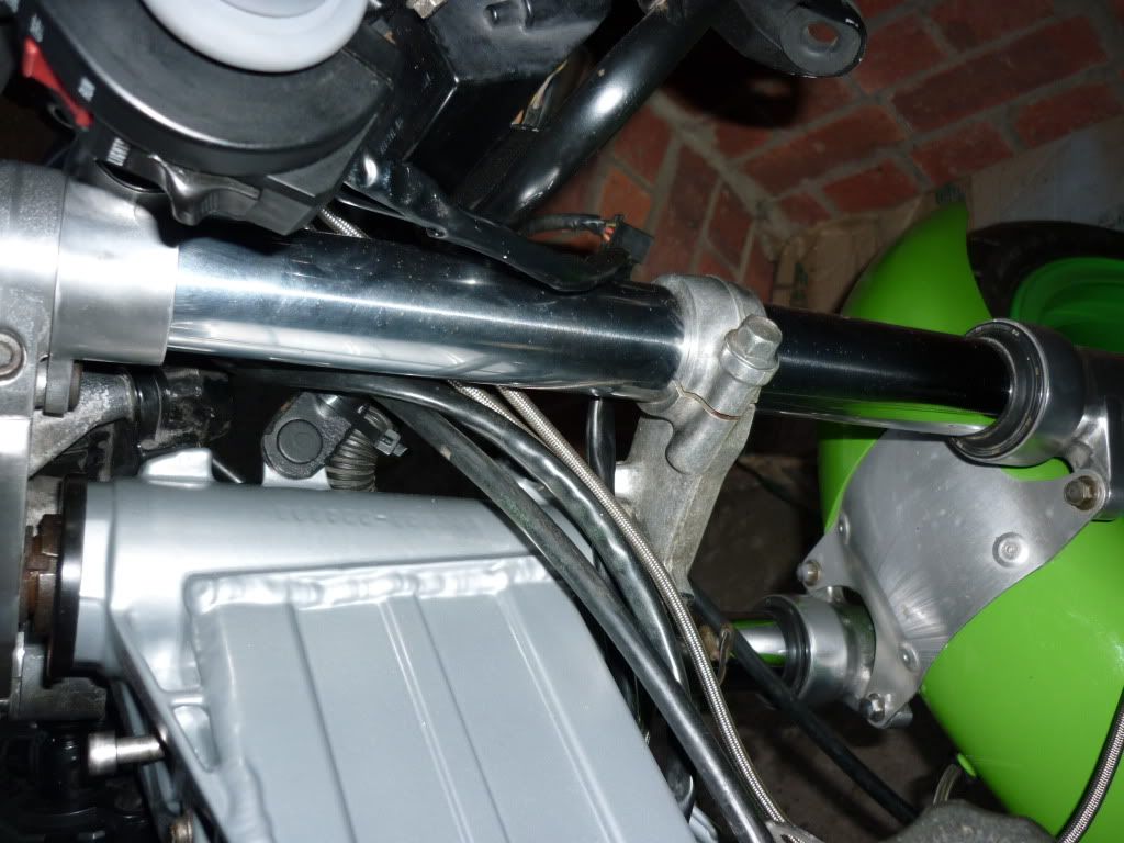

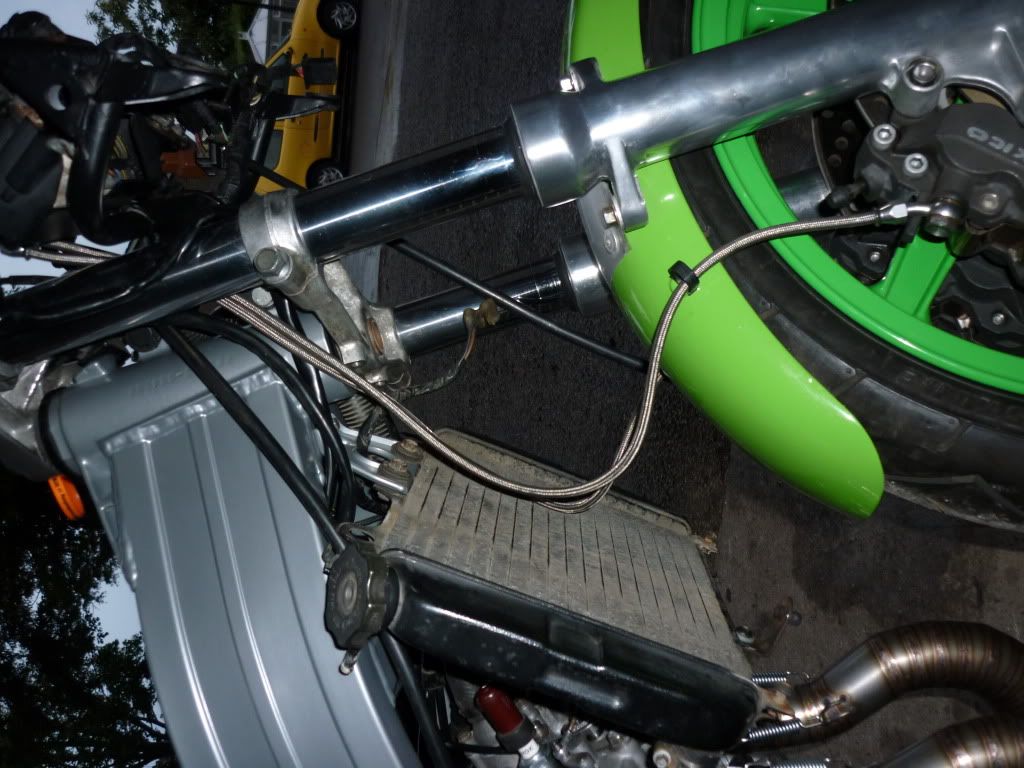

Fitted my gsxr 600 k2 calipers but the goodridge hoses that came with the bike look way too long in my opinion, what does everyone think?
Really pushing to hear those pipes now!
Maccas
Way too long, have a look at how mine are.

Yep yours look alot better don't they, more money needs spending then :(
Maccas

Blimey, what were those hoses off, a Harley?

Lol they must have been, they came with the bike and its been that long since i got it i forgot how long they were :(
For now i might use the hoses that came with the gsxr calipers and buy some goodridge when the funds allow.

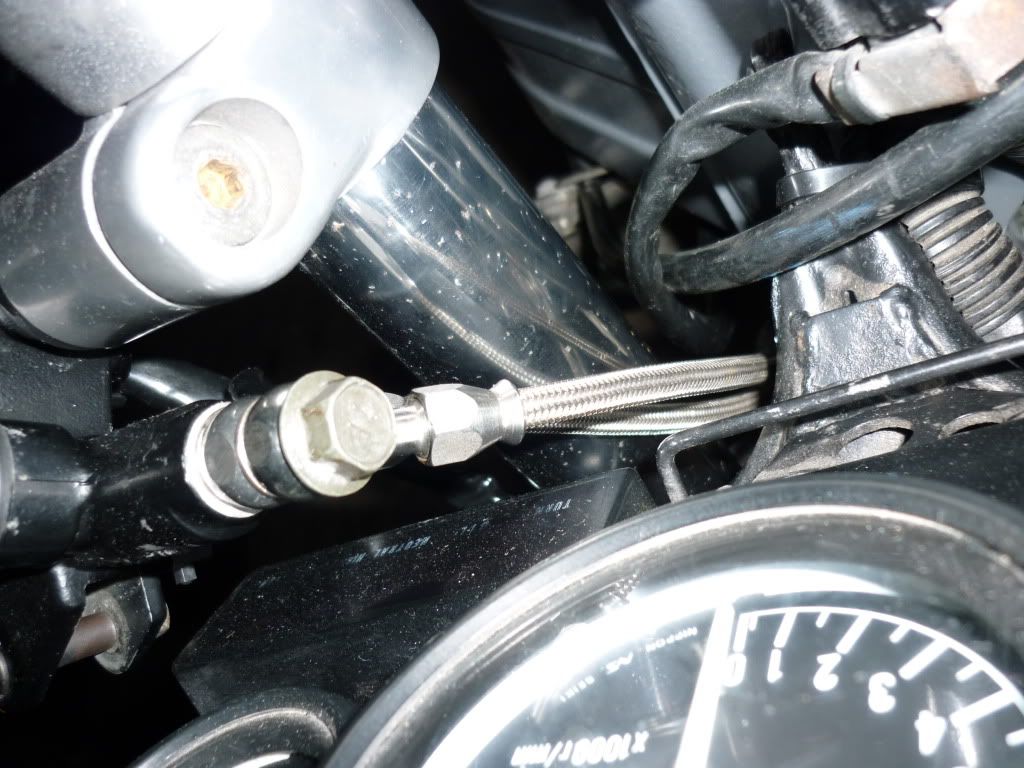

Purchased and fitted goodridge front hoses (thanks Ben for the heads up on those :D )

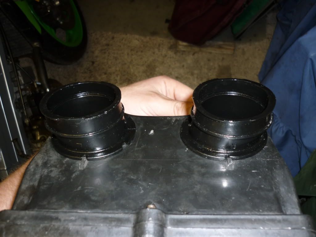

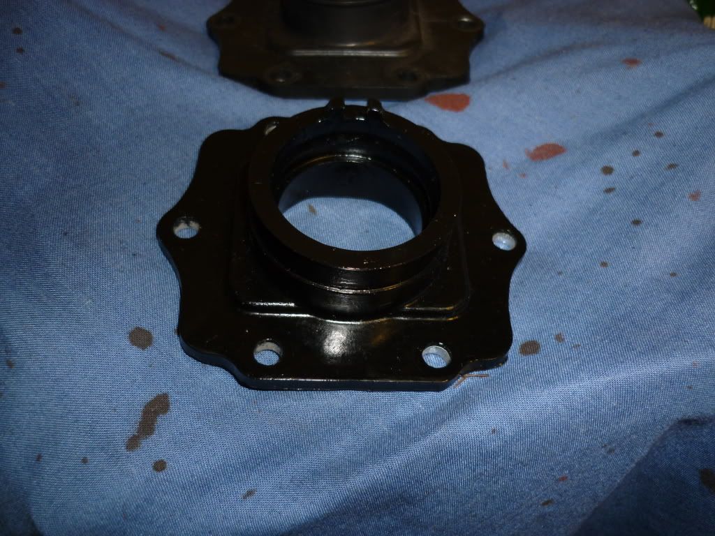

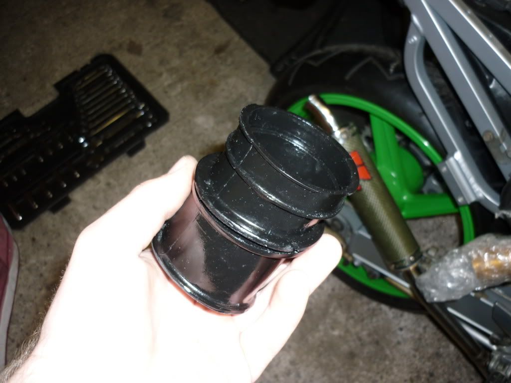

Received a parcel from Danny aka KR1R from new zealand containing these:
Very very happy with them they are spot on, very pliable compared to the originals!

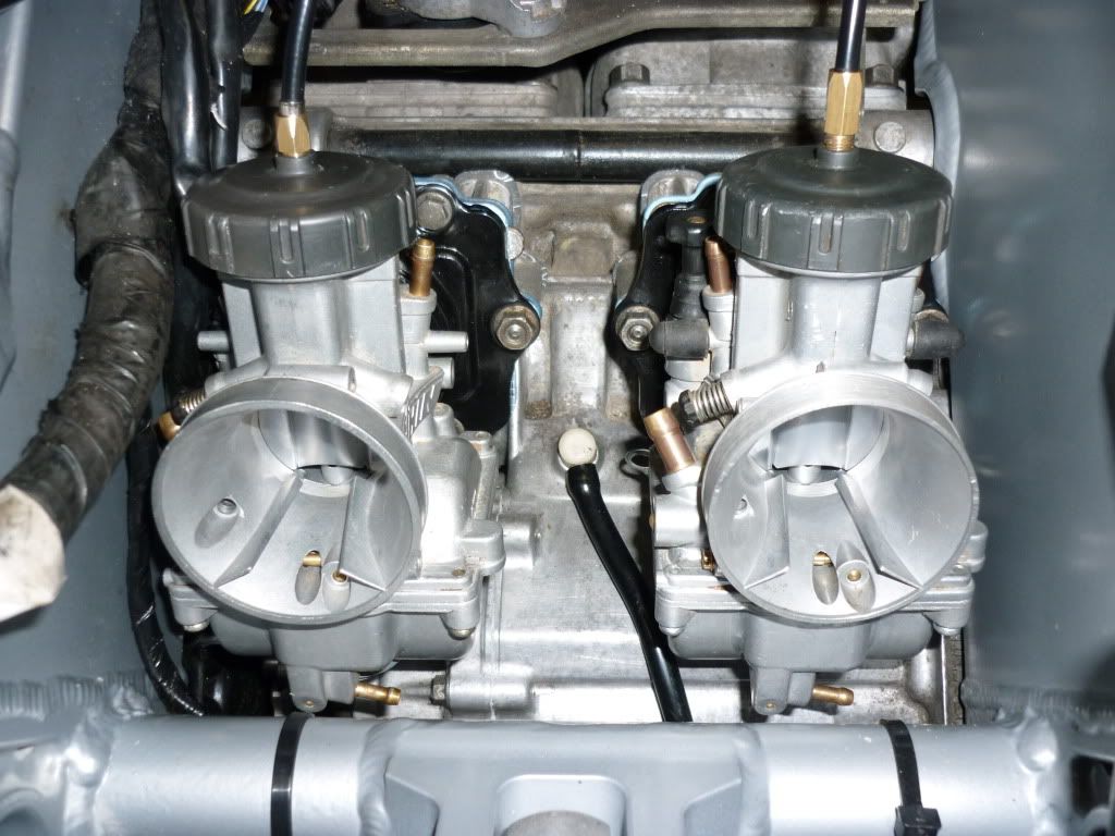

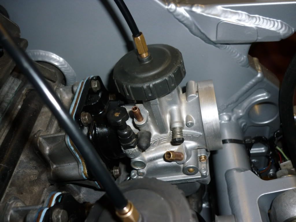

I made up two new throttle cables to go from the splitter box to the carbs as the standard kr1 ends wouldn't fit in the adjusters in the top of the carbs. Easy peasy!
Carbs settings are as follows:
Main: 155
Pilot: 42
Needle:DEL (middle clip)
Slide: 4.5 (may put in the mill to make them 6.0 depending on how it rides)
Pilot air screw: 2 turns out

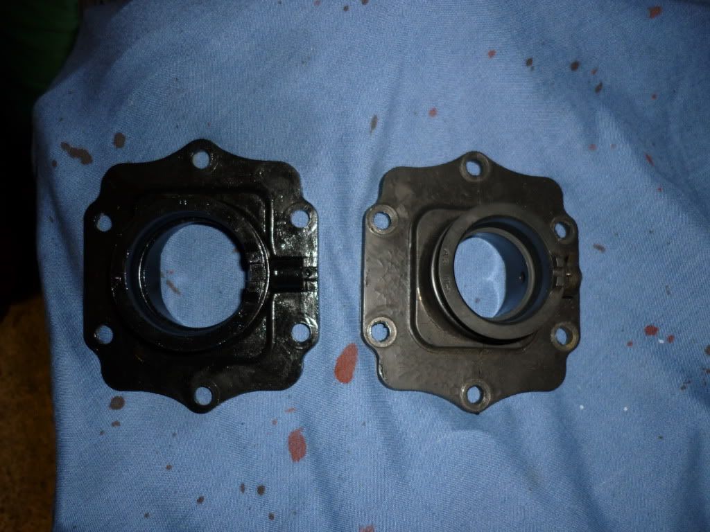

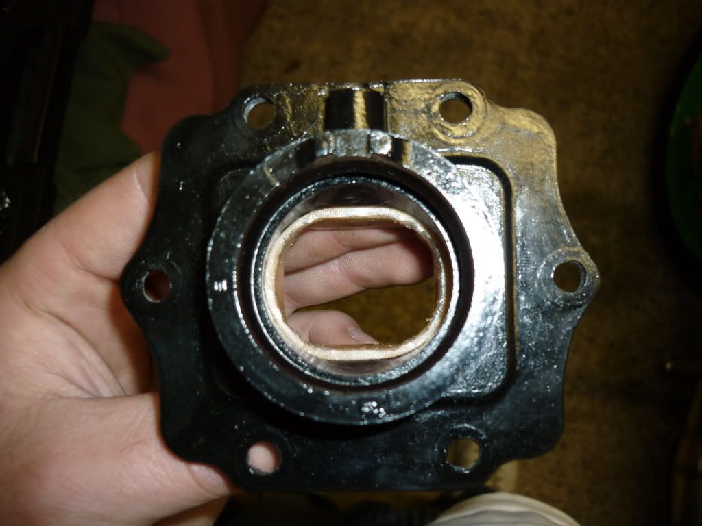

For now i have removed the reed valve stuffer as i couldn't be bothered to file the hole to match the new reed rubbers but i will do that soon (or buy some v-force reeds :twisted: )

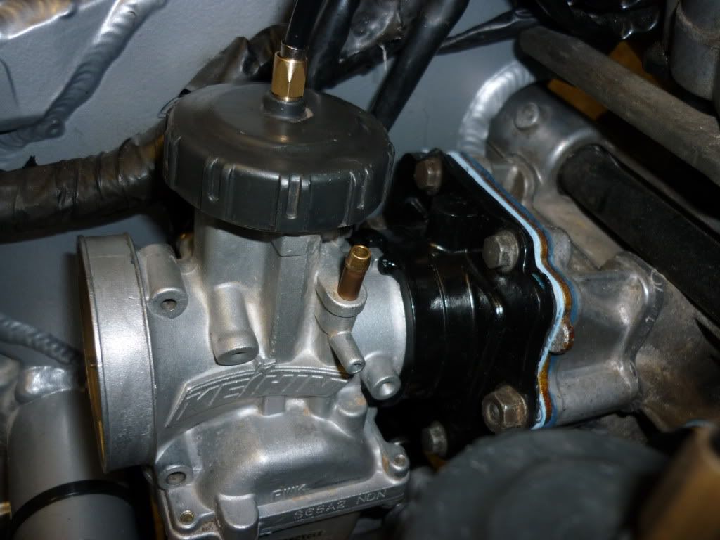

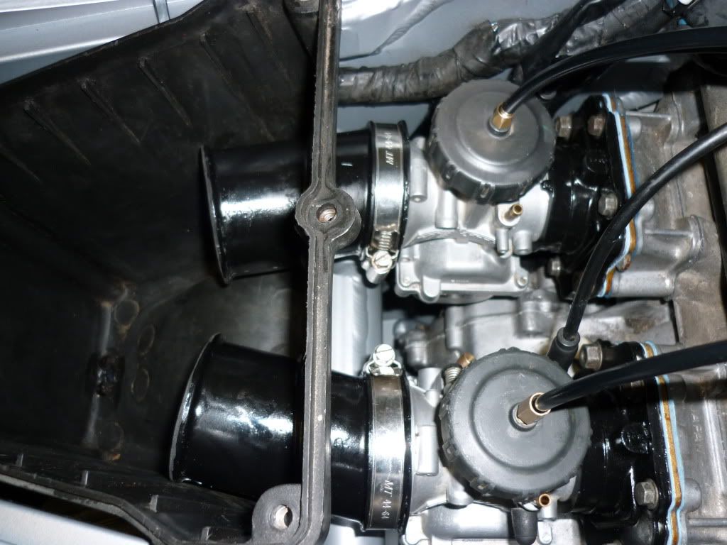

Carbs fitted (minus clamps):

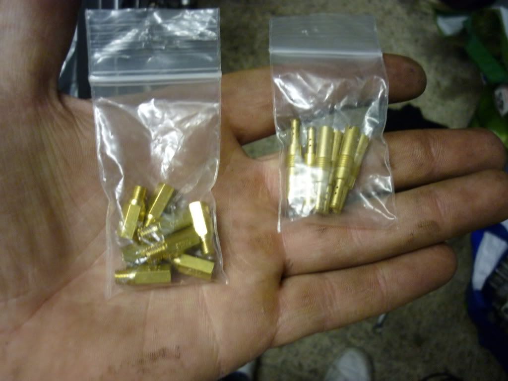

The last pic shows the number of jets i have to play with, 110quids worth from allens, i nearly died when he told me the price!
I have mains from 152 through till 162, pilots from 40 to 48 and had to buy two DEL needles.

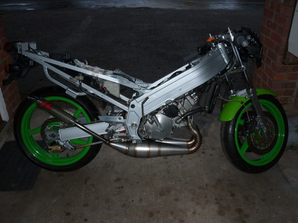

Put some fuel in her and she fired up!

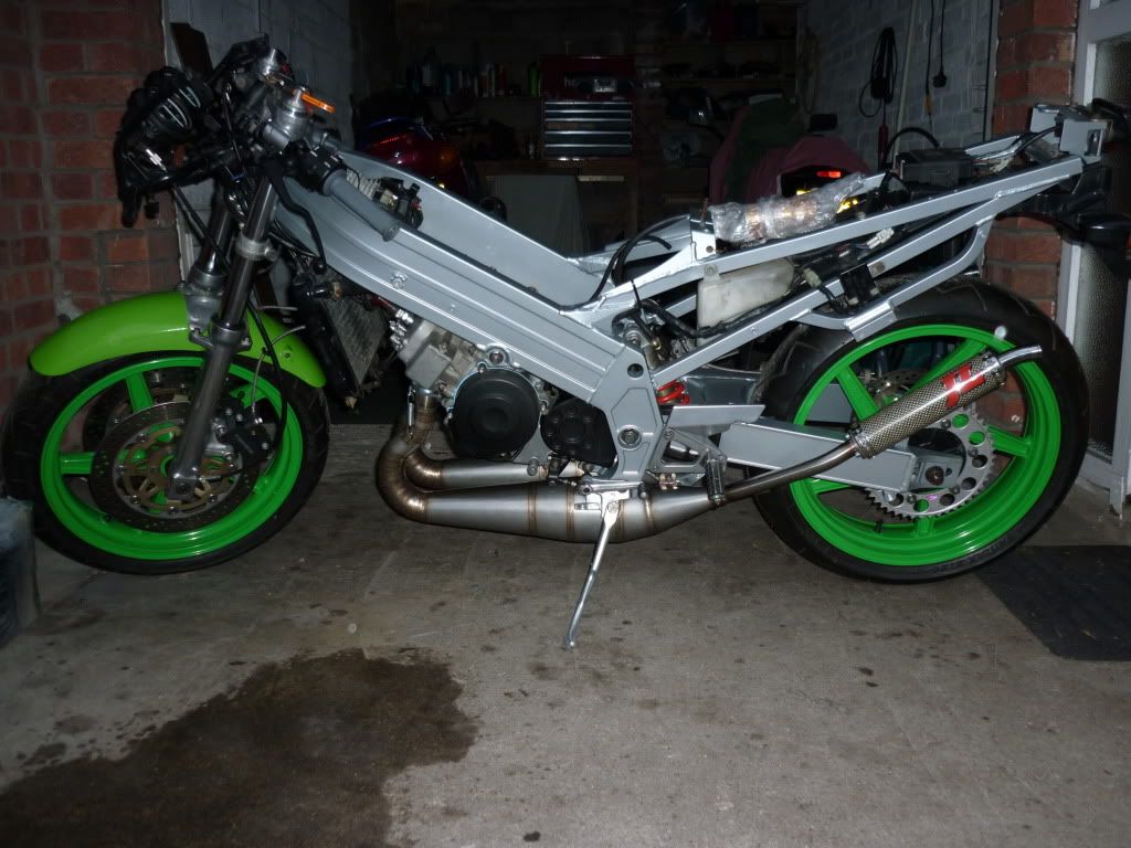

The lomas pipes sound mint! Running a bit fluffy but shes running! Will tweak later!
Throttle cables need fiddling with as the slides aren't quite sitting on the stops and the left carb won't quite go fully open, i may put the oil pump cable back on so the the junction box is being pulled nice and square if that makes sense?
Otherwise i will get a splitter box that only splits into 2 cables :)
Nearly there!!!!!!!!
Will do a video when i've got it running a bit better!

Did a bit more on the bike last night:
Sorted the throttle cable, slides now go down to the stops and open fully too, still using standard kr1 splitter box but with new cables that go to the carbs, all seems fine!
Synchronised the throttle slides
Set the tickover on both using a 5.5mm drill bit under the slides.
Ticks over a little bit low at the mo but pilot seems a tad rich so will wind air screw out to see if this confirms and if so will fit 40 pilot jet instead of 42.
Top end wise, main seems too big, will only rev to just under 9k in neutral and smoking lots, running 40 to 1 premix,
Will get the chain fitted and go round the block to do a plug chop or 2.
But for initial settings, not too far off, revs fairly cleanly in neutral and sounds pretty crisp, can hear it four stroking a bit at the bottom and again at the very top, but all in all very happy!
Maccas
