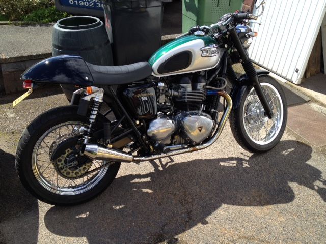

Post by headcoats »
Now fitted
Haven't ridden it yet though
The remote reservoirs look a bit out of place but saw another Bonny with a black cover over the reservoirs and it made them blend in
Maybe just fit upside down front forks now !

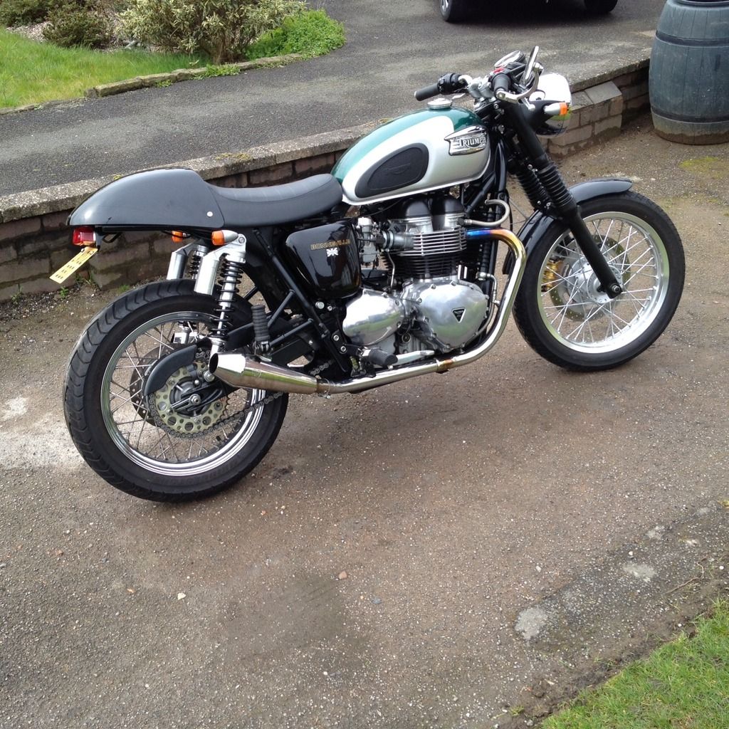

Re: Well it's Green and a bike !!!
Matin maybe its the camera angle but in the last shot your pipes gave really blued and the heat affected zone is much more pronounced. If you compare them to earlier photos they are more blued.
Its not running too weak is it.
Have you changed the headers?

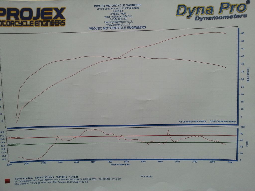

headcoats wrote:Image
Well this was the last run I had but that was with Thruxton needles and 135 main jets, It ran super rich at the bottom and was told to fit the standard Bonny needles and go up to 140 mains which is what it's on now
Standard trim they have 110 mains :?
I kept the airbox but is gutted with a K&N and belmouth intake trumpet
The pipes were second hand and were quite blued as it came off a fuel injected model if that makes any difference

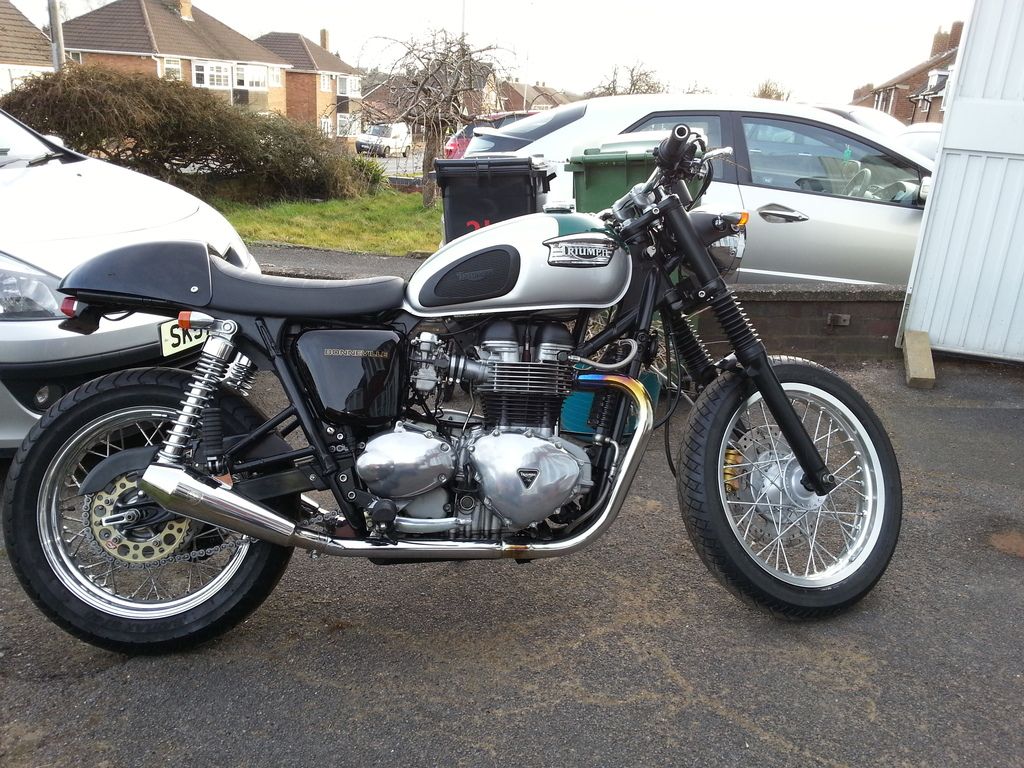

That's the first pic I had of the pipes before I even ran it
Yep they look like the same there, error on my part.

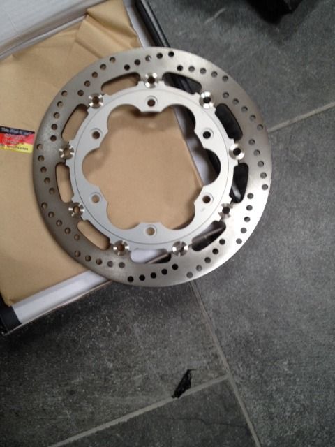

Crap photo but the replacement EBC front disc has arrived today :P
It's a floating disc so should be better
the old one has got down to minimum now at 22K miles (4.5mm minimum thickness)
I'd loctited the disc bolts on per manual so will be a booger to get them off
I usually just copper slip the disc bolts and don't usually have a problem
Only time was the LC rear disc where I just needed to tweak them back up

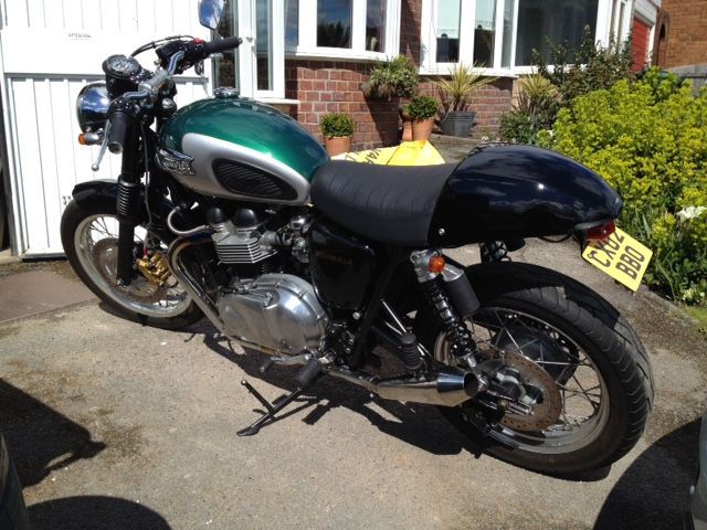

Put some 50mm heat shrink over the rear shock reservoir canisters to disguise them
I think it looks better :P

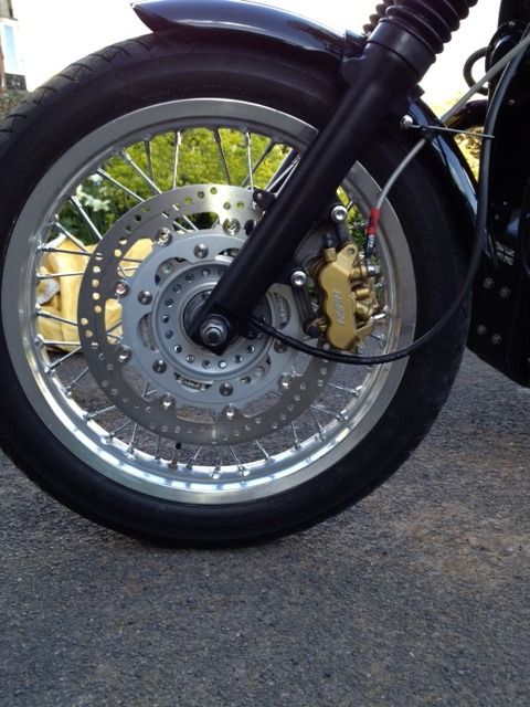

Fitted disc now
Bike was balancing on bricks and a plank :lol:
