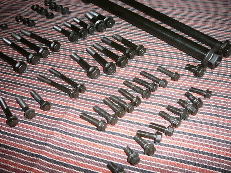

Anyway, anorak time (nearly) for me, thought I'd get all my engine bolts replated, but, sorry, had to deviate a bit, got them done in that black/green colour.
Just didn't fancy shiney head bolts, pleased with the results might get a few more bits done, had swingarm and rear wheel spindles done, might get all the disc bolts done, should be cheaper than replacing them :lol:

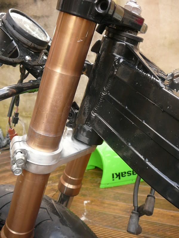

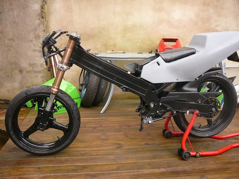

But we have a little bit of progress, it's up on it's wheels (for a bit anyway). I've had a bit of a rethink on the zxr front ends and this is my current one now.

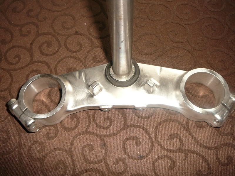

zxr400h yokes, with kr stem, but then with the bottom yoke machined out to 52mm (I think!) to take zxr400l legs(top one fits ok)......why?.....Cos I'm finding harder to get good 400h forks. They're all from 89/90 so knocking on a bit now and there are much more good l forks about. 2 other reasons, the 400l forks are the same length as a kr so steering geometry stays similar if not the same and the main one is, 636 forks fit straight in and I've got some coming, dunno if they're going in this one or the other one at a later stage.
The machining and stem swap cost me £30, so quite pleased with that.

Bottom yoke as machined up
Yokes as fitted
Rolling chassis

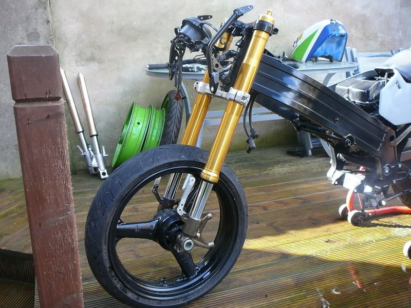

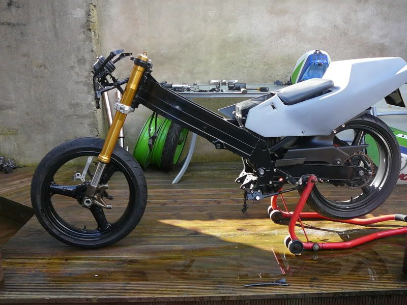

Front end version 12) part 3967 :lol:
Radial front anyone? The 636 forks have turned up, straight bolt in the modded h yokes.
Well I've run out of things to do with zxr400 bits :lol:
Wheel is only placed in, need to do the same as the other one, get the spindle remade/bushed out to fit the zx6r forks.
Got the calipers coming, need them to work out disc and offsett and stuff, got some great information and measurements off Martin, hopefully it may work out quite easy-we'll see 8)
