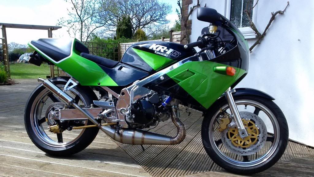

Project KR1SS - So far

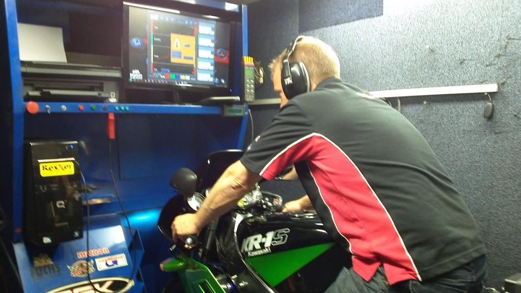

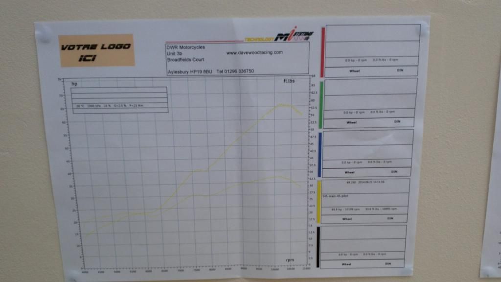

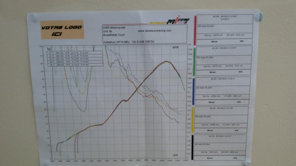

he got the bike done at dave wood racing in Aylesbury. [I did speak to krazy kat on the phone before going to dave wood racing but unfortunately he was less than helpfull. ] [his website goes on about how he wants to try all sorts of tuned and standard two strokes,but even when I told him the spec of this bike and the sort of bhp figures it may get, he was,nt really bothered, does,nt matter as I will now go to dave wood racing and recommend it to other members,
he did the dyno runs and I adjusted the carbs changing the jets and settings,
the bike ended up running.
42 pilots
needle 2 nd position from top
and 155 mains with 66 bhp at the back wheel and 72 bhp at the crank.

Hi, well impressed with the results Martin certainly knows how to build a great engine. Massive thanks to him for making it possible :D

Very impressive skipper! I like your paint too! That's not the standard green?

It.s all paint, done by kas racepaint, lastest kaw green, green flecked in the black. Need to c in the flesh, pict don.t give it justice.

The paint looks bang on chief. Also the pipes look fantastic too,

How does that dyno compare to KrazyKats?

I was thinking the same Ben. What make is the dyno?
