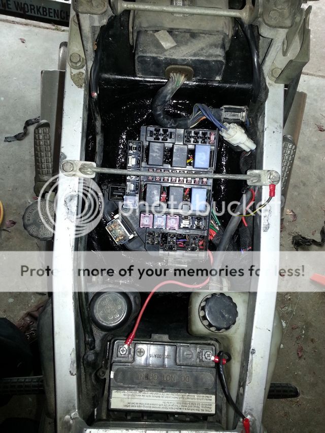

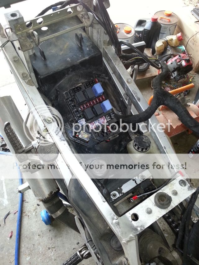

I wanted to add some other electronic accessories at some point in the future and figured that the best way to sort out the issues and be able to do this was to install a relay box. I picked up a second hand one from a wreckers which came of a Hyundai "something" I got one of these as it was reasonably small and it included the fuses and the relays in the same box.

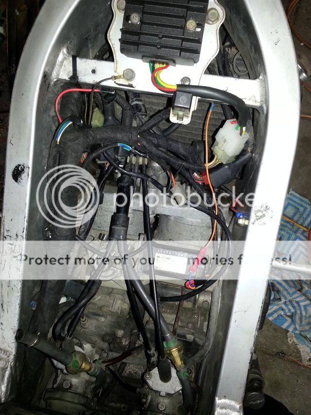

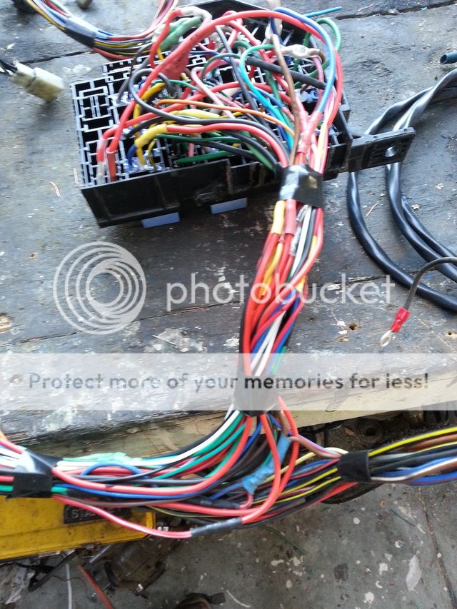

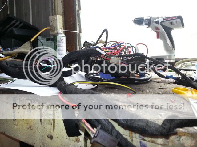

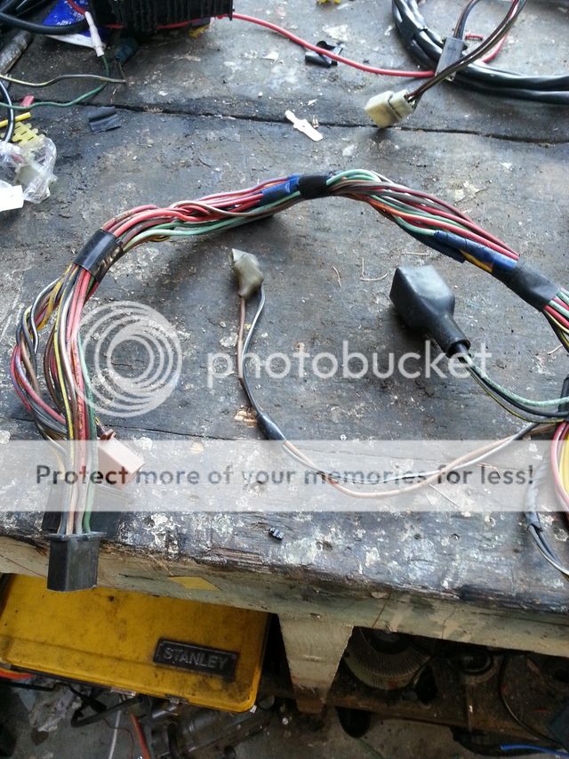

Here's some of the pics of the loom before and just after ripping it out of the bike.
As you can see quite nasty, I've bought some proper loom tape to wrap it back up with which will be a good start anyway.

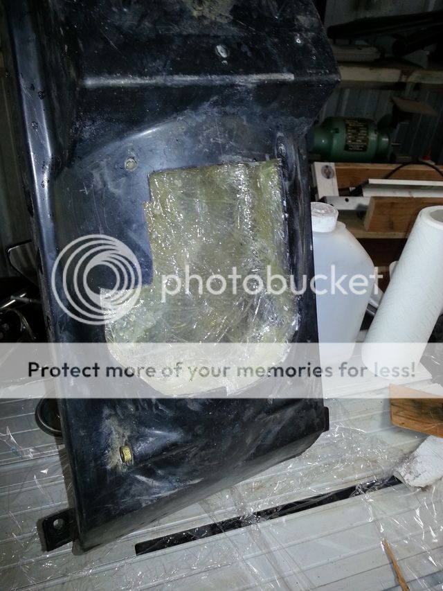

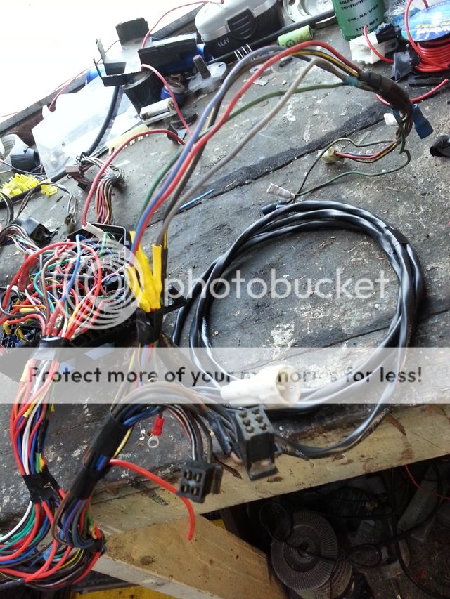

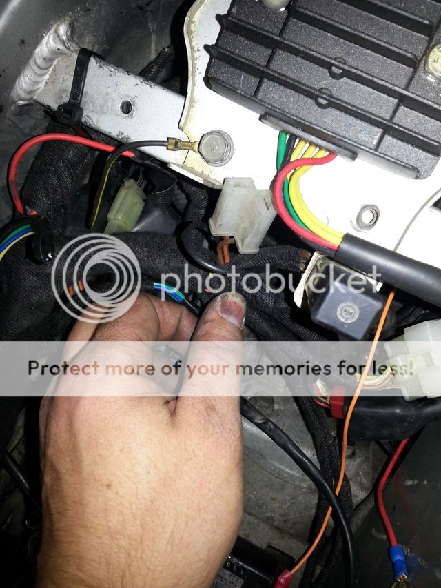

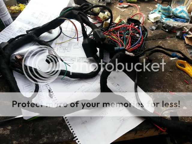

Here are some pics after doing all the rewiring, I've put it back in the bike to test everything before I wrap it up and cut and fiberglass the hole for the relay box.
The bench testing was extremely frustrating as nothing was working, that's when I discovered that I had a bad battery (again) it's showing 12.5v but dropping down to 9 as soon as you turn the bike on. So that's as far as I got for the day, I'll bring the car battery in tomorrow and finish up bench testing with that.

Those pictures bring a new dimension to a rats nest of wiring!

Yes it is an absolute rats nest however the hard part's done, once it's taped back up it should look neater than brand new.
No I'm not replacing all the connections, I've intercepted "vital" wires in between the switch and the component and run some "hook up" wire from the switch to the relay then some 10A back to the component.
I don't think the relays will protect from over voltage however I've added extra fuses to isolate certain systems (doing away with the old fuse box).
There are 8 relays:
Ignition - power from the key - provides power to the engine/cdi/kips etc as well as to all other relays.
Brake lights,
High beam,
Low beam,
Right indicator,
Left indicator,
Horn
and an accessory switch which I've added.
Hopefully isolating the systems will allow far better performance from the lights as well as not disturbing the existing electronics if further high amp circuits are added (heated hand grips, radiator fan, etc.)
When you say rats nest it's kind of disturbing that I know exactly what I'm looking at the moment. I think if you named a colour wire from the loom I could tell you exactly what it's for lol - this is information I could do without haha.

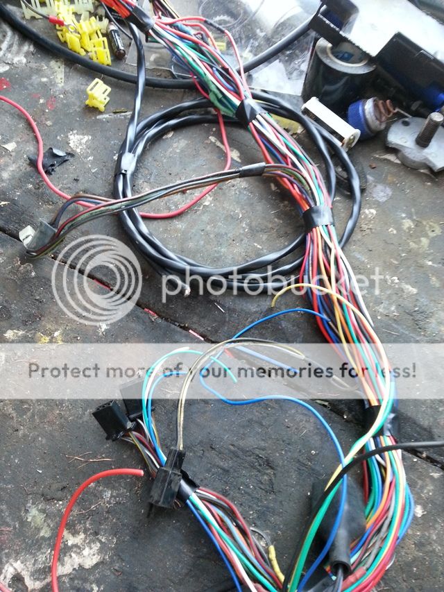

So I've done some more to this, I've taken the rats nest and wrapped it up nicely, first with some electrical tape where all the divergences are.
And then with proper cloth loom tape, personally I think it looks far better than it did :D .
The wires coming out without connectors are for some extra accessories which I'm planning on adding at some point in the future. I just thought to keep things neat I'd wire it all up inside the loom.

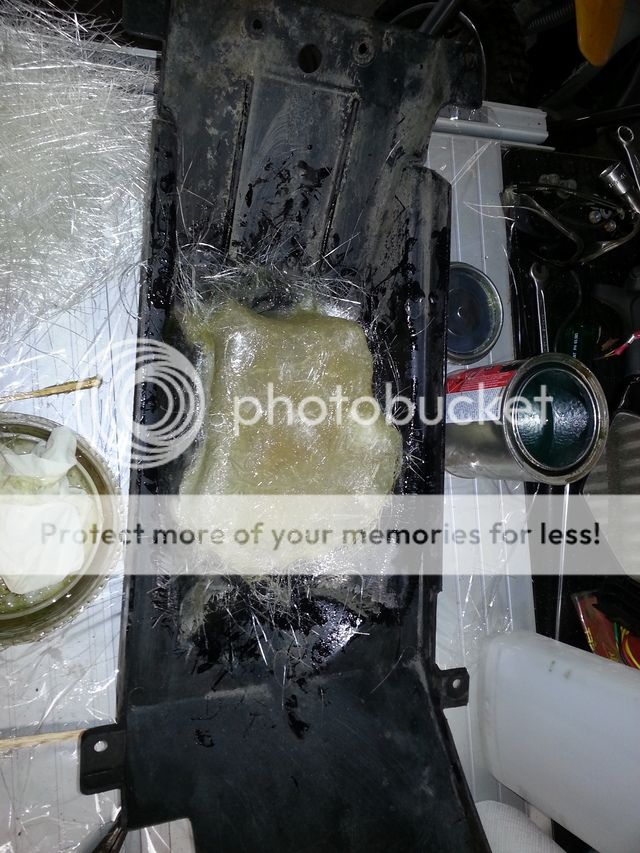

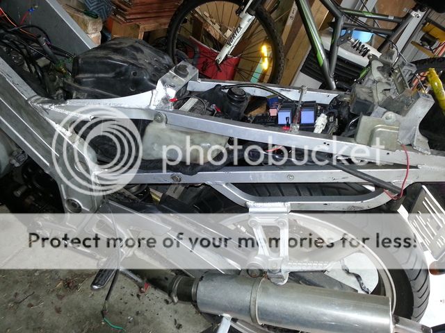

Here's the "bucket" which will hold the relay box, it's cut in under the seat, I'm hoping that it will still leave enough clearance for the suspension travel :shock: but I've bounced up and down on the tail as much as I can and I couldn't get the tire to touch so fingers crossed. I have a real love hate relationship with fibreglass, it's so handy but so bloody messy. Still curing so no pics of it in the bike sorry.
I know it's pretty ugly but I'm a bit over it at this point and I'm planning on making a rear wheel hugger and I'll build a better box for it then.

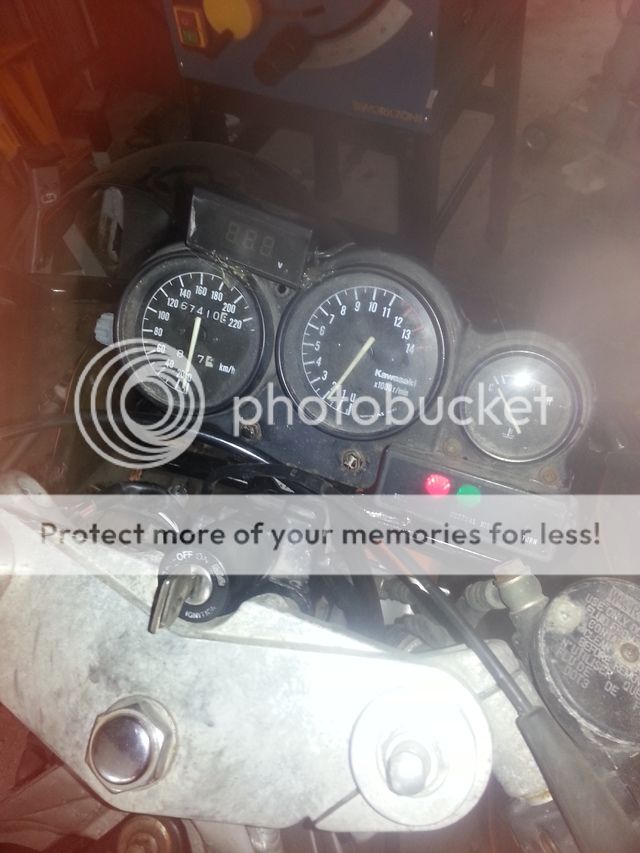

Right so I've got the loom back in the bike, hoorah, I've lost some length somewhere along the way so it's a little tighter than it was and I was having some issues getting in the reserve water tank however I got there in the end.
Mmmmm two smoke in the air.
Revs
One issue with this mod is that the flasher relay no longer works as there's now near zero load on the circuit so I've wired a ground to it and ordered an electronic flashing unit.
I'm still having some issues with the power my battery is absolutely stuffed, only getting about 7 volts when it's running, turning on the lights still kills the motor. So I'll order a new one of those and see how everything goes.
I'm sure this has made a positive difference though, I noticed even when i turned the key with the stuffed battery the neutral/oil lights are really bright even with the stuffed battery whereas before they were barely visible.
