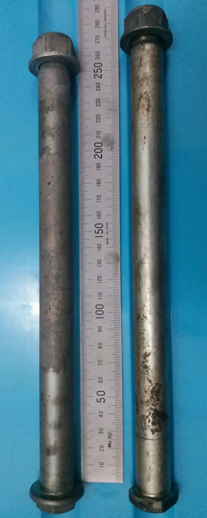

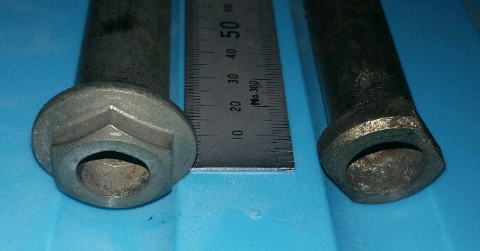

KR-1S 20mm Swingarm pivot bolt LINK
(KR-1 pivot is dia 15mm)
KR-1S can use RGV VJ22 hollow pivot, afaik VJ21 is also 20mm, differ in head end
