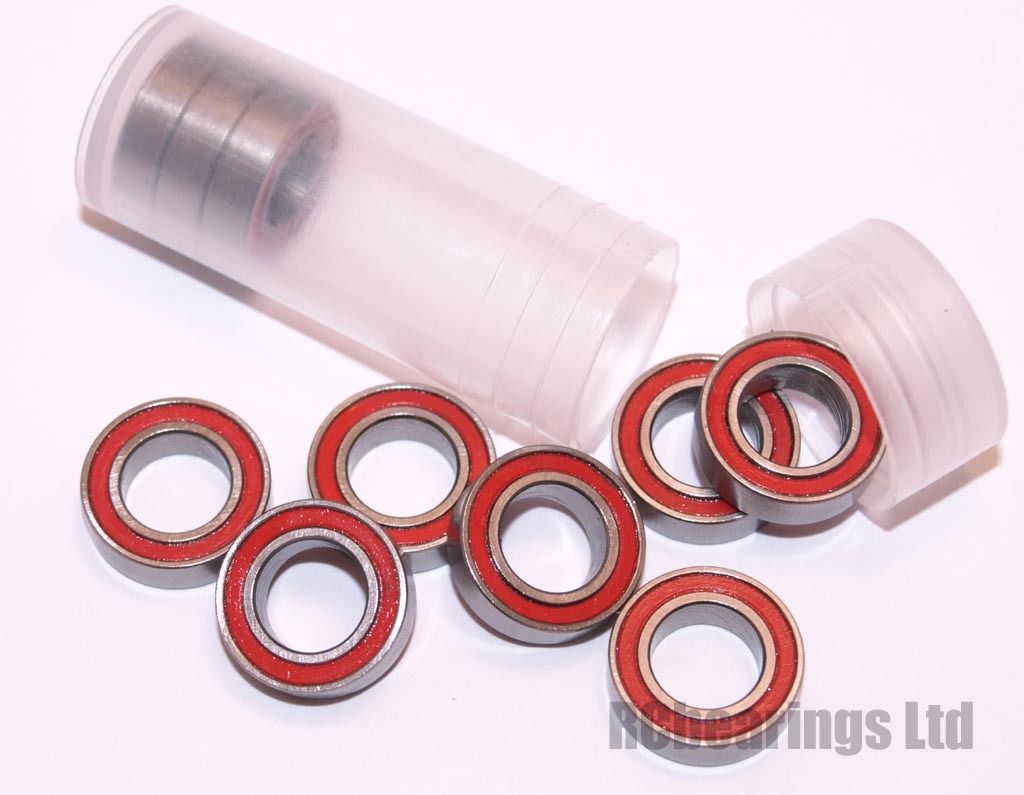

i can only find single lip seals . i will order some jb weld and i can etch the shafts so it sticks well , and thought i would try sealed bearings and sort 2 problems out , 8mm id x 14mm os x 4mm wide ,more surface area to stop everything rattling about ,hopefully .£10 for 10,we will see. ile have a look tomorrow to see if there is enough meat to counter bore into the seats to have a bearing and seal

probably why you are looking to improve robustness and save money at same time - if the finished tolerance on the stems is close enough, would you even need seals on top of sealed bearings?

That's my thinking. Mine have always danced and bounced about a bit

They fit sound. I'm going to pop the old rubber seals above the bearing as a damper and to stop the bearing floating. Took up all the sloppiness.

Thats a good idea with the valves Fred, I have several that are worn ill give it a try👍do you thi k any oil will be able to escape tho?, let me know how they perform cheers dan

I'll use a little Heldite sealer (used for petrol and diesel sealing over ptfe pipe joints) around the stem and on the outer race. I will pop the old seal above just as a damper, on a spare head I need to tig weld a snapped ring Mark up in the squish area so will remove the steel sleeves and counter bore in 3mm so a bearing and seal will properly fit. But that's a way off yet
