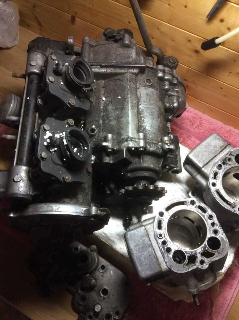

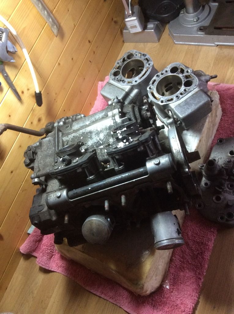

are those pistons on backwards?
- martin
- Posts: 1610
- Joined: Sat Jan 13, 2007 10:35 pm
- Location: luton,beds
Re: 300cc Kr1s Engine build
Looks like they are Danny.
Did not notice the holes on the piston facing the back when they should be to the front.
Doesn’t matter as it’s going to be stripped down and new pistons fitted

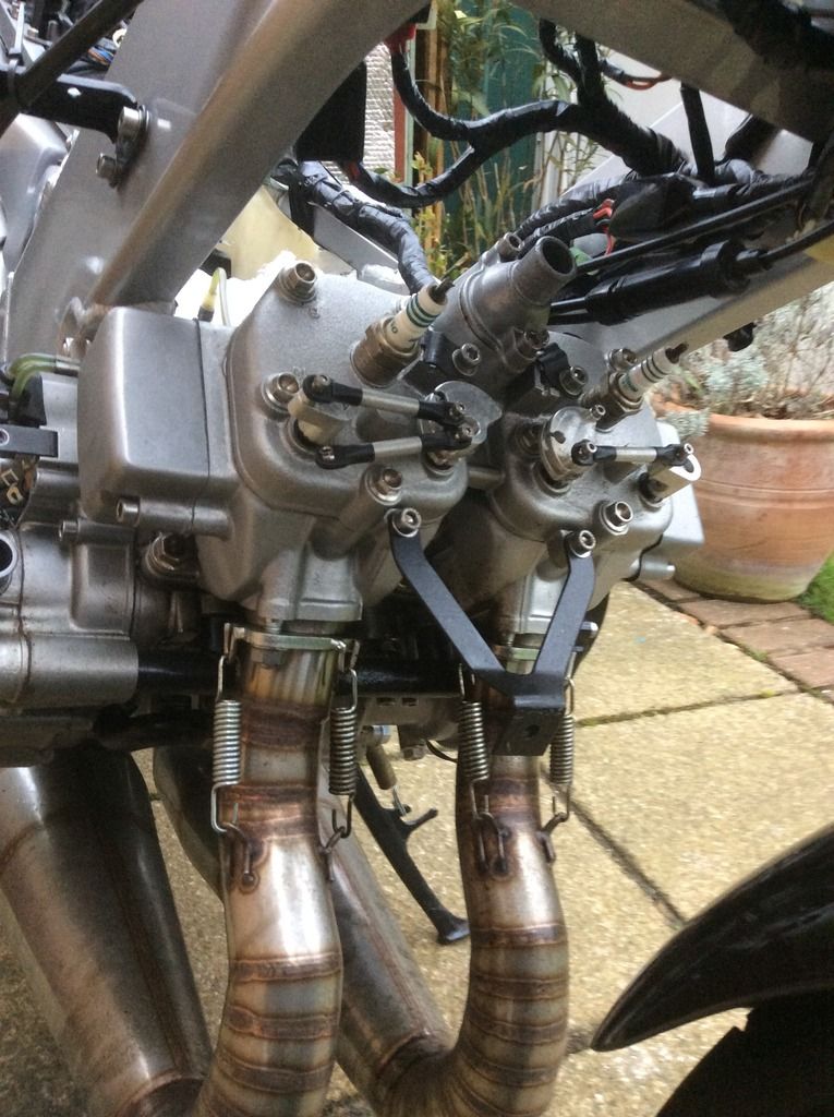

E3 plugs ,aren’t they the plugs with the fancy electrodes, bit like marine plugs? Looks like everything on your sparks from generation, timing, connection and firing will be spot on. Looking forward to hearing how its going.
- Posts: 3403
Hi Steve,
Been running mine with all those parts for over 4 years now, never missed a beat, never fouled a plug in all that time, and had quite a few blasts on Mick Abbeys dyno.
- Binetta Steve
- Posts: 949
- Location: North Wales
I didnt spot the electrical wizardry you had employed in your build Bernie. I guess I looked more at the finishing and those lovely Lomas pipes.
