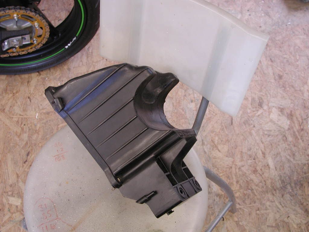

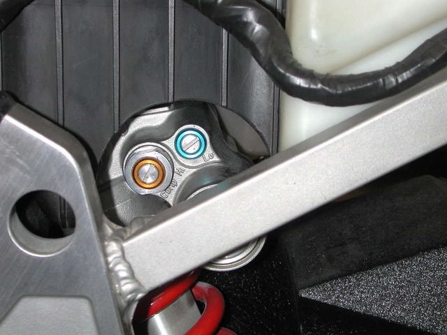

Fitted a 2006 R6 rear shock a while ago whilst the engine was out for re-build. Engine back in frame now and was wondering how to modify standard airbox to clear the top of the shock.

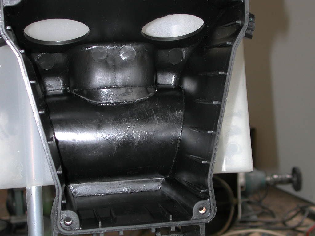

I cant find the post, but I remember someone cut the offending area out from the airbox, and plastic welded a piece of old mudgaurd in it's place to seal it up. Made for a very neat mod and left enough room to reach all the adjustments.
The one thing you may want to do, is look at expanding the airbox into a different area to reclaim the lost volume. Apparently the reduction in airbox volume has caused some running issues on some bikes (I suspect it's mostly on higher tuned engines). Some people have moved the battery and used that space the get the volume back and others are planning to extend it to enclose the carbs (although this would likely require a lot of setting up of the jetting).
Hope this helps. Scott

I stumbled across that thread a while back - and took the liberty to download the pics. Cant find it now. But here are the pics that might help.

Think its time to get busy with the hacksaw and soldering iron! Thanks for the guidance.
1990 KR1S
KR-1R: That's the one I was thinking of.
Pretty dang professional finish as well. 8)
