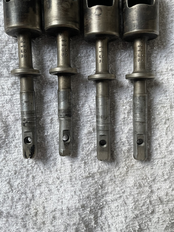

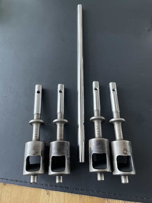

Since plastic drinking straws are not allowed to be sold in EU (and suppose in UK as well?) there are lots of alternatives. For instance stainless steel drinking tubes. The medium size has an outside diameter of 8mm, which happens to be the same as the stems of our KIPS valves…..
I thought: let’s give it a try and bought a set for a few euros. Found a guy who machined my tortured KIPS stems down to 7,2mm and placed the stainless steel sleeves on them.
Before:
Now:
At the moment my bike is stil completely in parts so I can’t give you a review of this mod for some time. But thought it would be nice to share.
