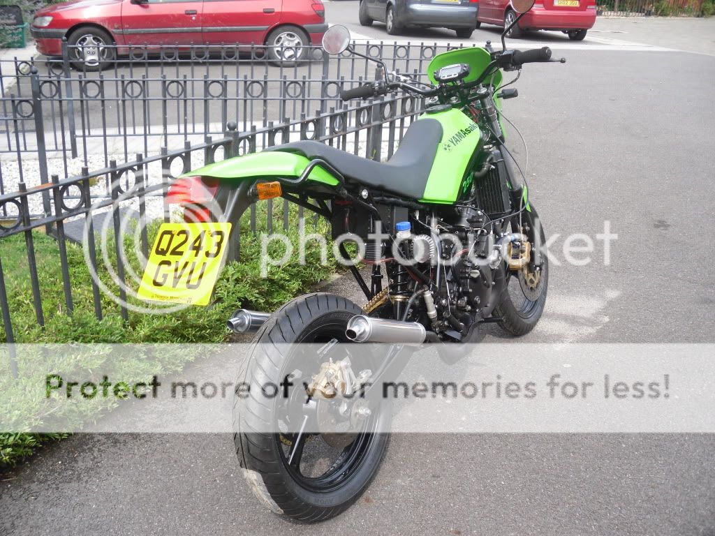

mmm, nice, are those swarbrick end cans?
make sure you post a vid on youtube as I'm sure it sounds great with those open carbs
Gordi
Heavy Smoker
Posts: 149
Joined: Sun Oct 25, 2009 10:29 am
Location: Gloucester
Post by Gordi »
That's right, Scoobie, they're Swarbricks. Never put anything on youtube before but will give it a go later. I'll have to get used to the reversed gearshift now. 1 up and 5 down-buggar!!

Looks barking mad! I love it! =D>
Luders
Avgas Sniffer
Posts: 3926
Joined: Fri Jun 18, 2010 11:29 am
Location: Oxfordshire
Post by Luders »
That's a lovely job you've done there Gordi, top marks :)
