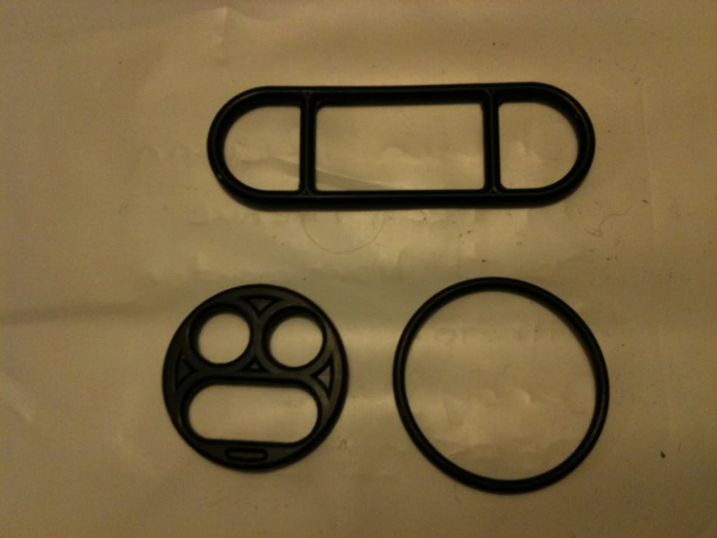

My fuel tap decided to start dripping when in the 'on' position and no repair kit was available from Kawasaki.
So been doing a bit of investigation and found the KX125 and ZXR400 fuel tap internals appeared to be similar -
well now got parts in the post and .......de de de deee de de de Daaaaar
The ZXR400 is an exact match:
Ok .... so I'm easily pleased
