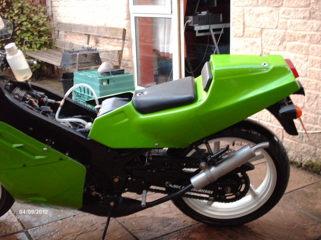

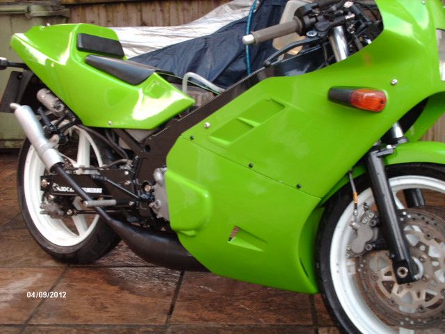

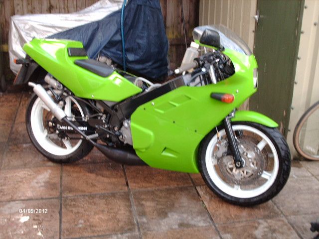

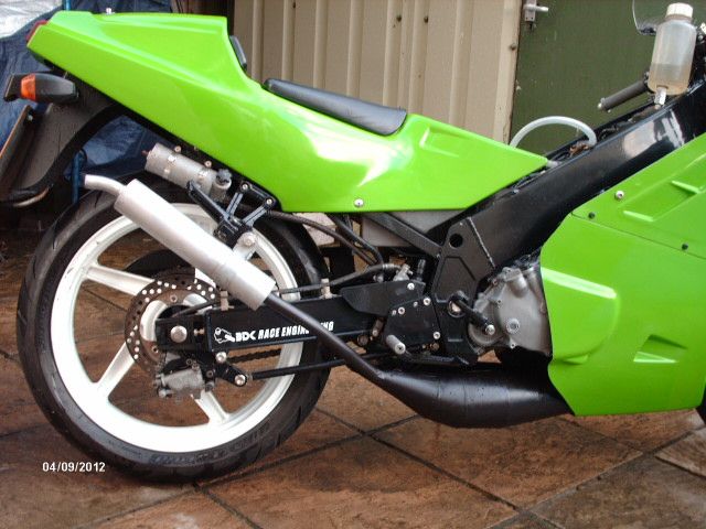

shame the lad did the seat hump the way he did ,but at 180 deliverd i couldnt grumble and he just took over from his dad who passed away,only unwrapped it today ,need to put some heat tape in the bellypan ,got a roll we use on the graindryers, built as a usable road bike thats easy to clean,i can live with pistons n barrels on the list tho ,
