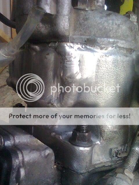

Well I've finally come to a decision, after a closer look that is! This is what I spotted..........
[img][img]http://i800.photobucket.com/albums/yy28 ... /018-3.jpg[/img][/img]
What you are looking at is a .40 feeler gauge quite loosely put into the crack on my bottom yoke :shock:
Never seen this happen before & like I said, the plating on the bolt in minimal & it is the original bolt(you can tell by the turned over edges :lol: :roll: ). Pretty glad I spotted it now & not out on the road :lol: 8-[

Not seen that before, Possible to clamp it and then weld ? or you going to fit a spare.
wow never seen that either just a dodgy one or been hit at some point i'd change it personally wouldn't bother getting it welded.
:shock: :shock: :shock: Yep, I'd bin that one as well.
Also, is that a toothed washer I see between the clamping faces? :-s
Nope thats just a build up of crud from our lovely British summertime weather & my inability to clean anything properly :lol:
I will bin the yoke, don't think I would ever trust it even if I did have it repaired.
Ho hum :roll:
That's for the scrap ally bin that mate.
I've never known a replated bolt cause any problems.
before you bin it, take out the stem :wink:
