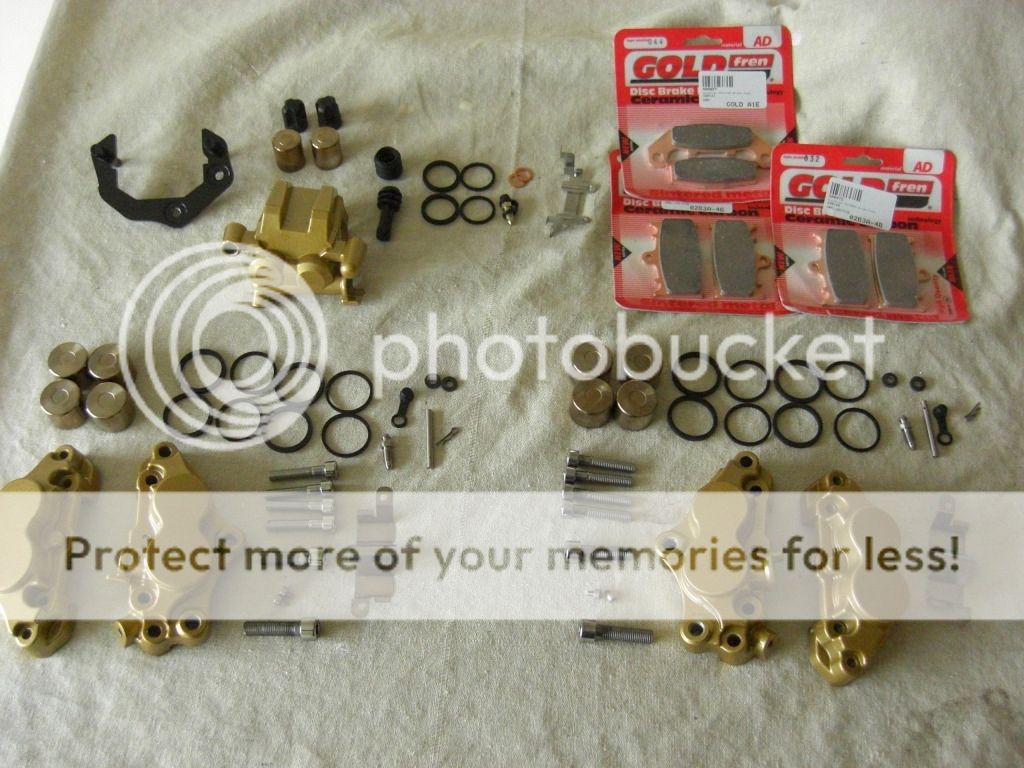

just stripped some calipers apart for a forum member. as he is,nt too happy with the finish on the ones he had rebuilt by powerhouse[they advertise on ebay]
what a bunch of tossers. had to struggle like mad to remove the pistons.
and as you all know, when rebuilt,pistons should move freely.
, look at the pistons, a lot of the marks are fresh,so make your own mind up. [you can even see the marks on the pistons where they have rubbed them with wet and dry,so would of known how bad they were]but why rebuild calipers with pistons that bad.
if you read this powerhouse, sorry that I am knocking your work. but really, come on, is this your standard.
their paint is shit too

Not a good advert for there work, was there any red grease on them?
yep, loads paul.
but when I rebuild calipers, I never use red rubber grease,
the only thing inside a hydraulic system is fluid, so why use loads of grease,
if the pistons were that bad, why did,nt the company phone the customer up advising that new pistons were needed,
I know the customer has rung them up and guess what, they don't want to know.
I will be replacing them with nice new stainless steel ones =P~
all sorted now.

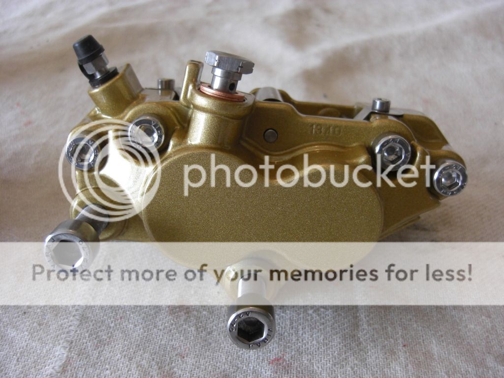

Is that powder coating on fresh calipers Martin? Looks very nice
Hardcore you know the score
Re: dont use powerhouse
it is, i hae some nice 2 pack ones at the moment.
