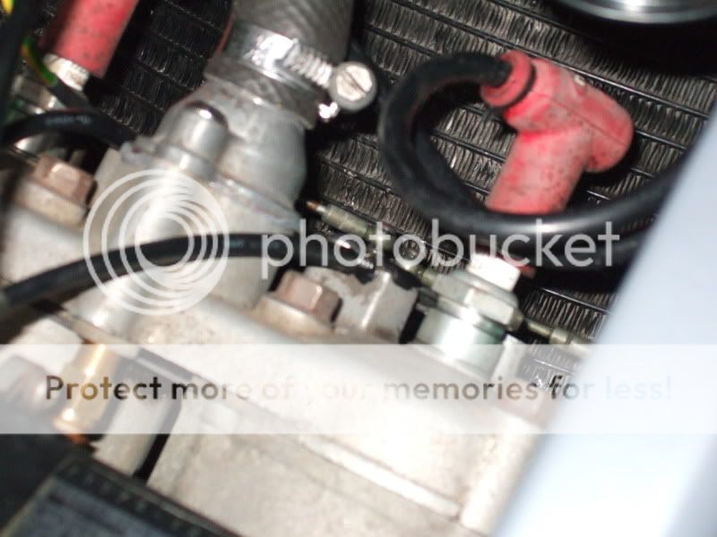

so.. fitted new temp gauge (feel like I should've just calibrated an original in the end) ](*,)
not much bother- sensor only just fit and when I tightened up the clamp at the back of gauge the needle swept round to full :x loosened it off and seemed fine.
also fitted thermostat and ladies tights.
went for short test and few miles later power dropped a bit and noticed temp gauge off the scale (not the best at keeping an eye on this), then noticed engine racing when I pulled the clutch in. home again with minimum revs, high gear, wide throttle etc. ](*,)
thought it was an air leak and the gauge messing about but slightly worse.
if I hadnt had knee pads on under jeans I might have noticed my leg getting wet :shock:
coolant leak and gauge was working properly ](*,) ](*,)
very lucky to get home without seizing, compression is still good. cant quite believe it went for even one mile (of the 2 or 3) to get home, at the temp it was indicating 120+
Powervalve cable seized due to melted outer casing.
have a good spare coolant rail but feel like getting stainless or aluminium one made :roll:
it never rains but it pours, there was a silver lining though, I think.

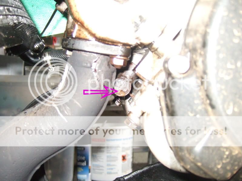

KwakOn
Posts: 514
Location: Northern Ireland
Post by KwakOn »
hole in that steel coolant pipe that runs from the pump, have put an arrow in pic.
.. Image ..
I got you now.
