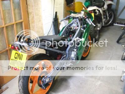

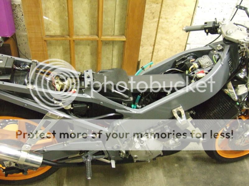

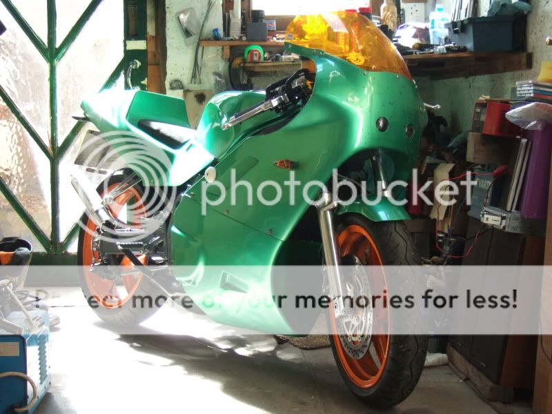

Eventually..... some visible progress,
just trying to get it M.O.T'd again, has been a track bike for a few years.
plenty still to do: clean engine, paint tank and fairings, sort brakes, get lights, horn etc. working, finish clock mount(nearly done).

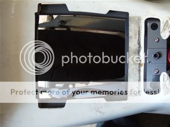

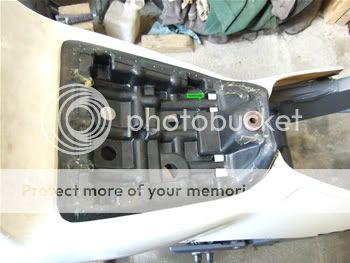

seat was done a while ago, small cuts to keep the support across the side panels.
[edit]
some more pics, (when it was nearly ready)...

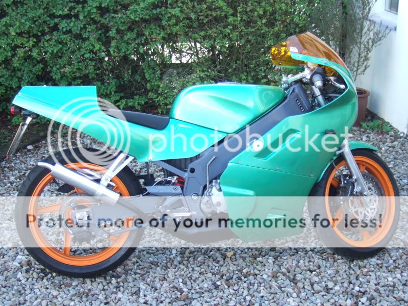

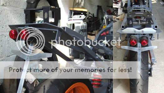

finished at last (except a few stickers), mot'd, taxed and a few test runs done.
:D :D :D :D :D it was good to get a wee blast but a little frustrating as last I used it was on track where there isn't fucty traffic.
indoor pics show colour better :? (on my screen anyway)
couple of things to do now,

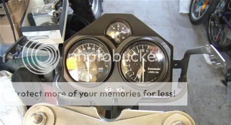

Temp gauge failed, will fit Thermostat as it seems to need it for the road, PowerValve seals to fit and of course some stickers/graphics(minimal).

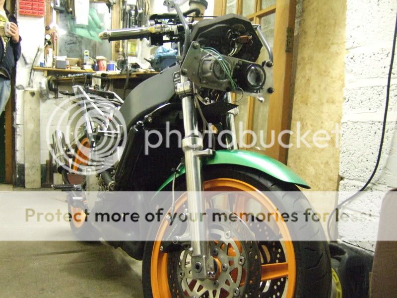

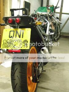

Those wheels look ace in orange 8)
Whats the shock Kwakon? Is it a hagon?

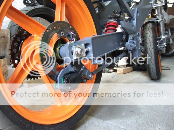

Yes Hagon, will try the R6 swap later in year I hope.
Hagon is OK but my susp guys cant get parts to service/rebuild it and its old version and I have no tools to get it apart to clean it etc.

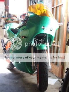

Really looking forward to seeing what you're going to do with this.
I love rebuilds at this stage, I think its because you get a small idea of what the final build will look like but it also lets your imagination run wild & as I intend to start my Kr1s rebuild in about oooh, six months, maybe eight, its a brilliant source of ideas.
Keep the pics coming kwakon, even the smallest detail :mrgreen:

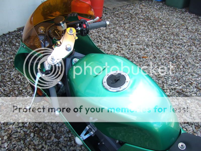

I like it too 8) Interesting choice of colours.What are you thinking of doing with the bodywork
666damned
Posts: 674
Post by 666damned »
as pablo asks...what colour scheme you planning?

cheers guys,

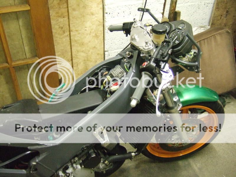

bodywork - I was quite keen on bright green, but that was to go with a black frame.
I was planning all matt black frame and brackets and fork legs, yokes etc. unfotunately it was taking me too long to get everything ready for the blaster so I just went ahead when got so much done.
painter wasnt too keen to do matt black with the engine enamel I was thinking of also "NLA in 2pac". Metallic grey (with greenish flake) also not available so the satin grey was what I went for, its a PVC paint I think he said, quite tough it seems.
I didnt remember till it was done that it is a primer colour so looks like it is waiting a final coat :lol: :oops:
the orange wheels go quite well with the grey I think, but green fairings as well... not too sure.
so now I am thinking matt black fairings with flouro green graphic and/or white, then get bright green wheels. cant really decide.
Basically I originaly wanted Black frame, Green body, White detail but "best laid plans....."

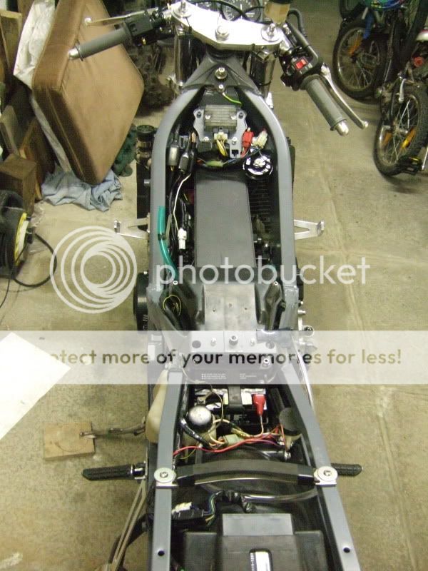

I'm glad you mentioned that, I was going to ask what colour the frame etc will be once painted :oops:

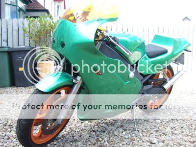

finished :D \:D/

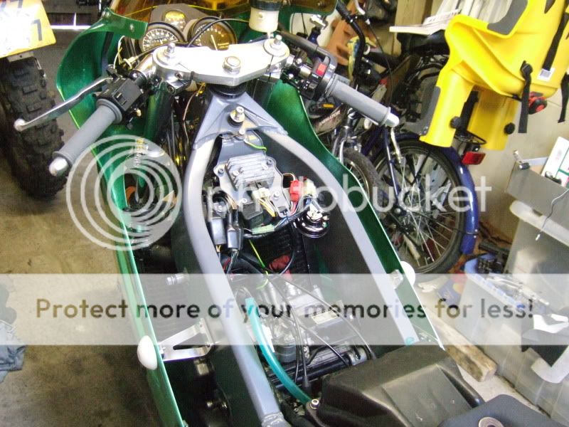

I see you've ran a front air feed to the air box.
Where does that intake start?
KwakOn
Posts: 514
Location: Northern Ireland
Post by KwakOn »
"Where does that intake start? "
just in front, and central above the rad.
I jetted up significantly(150 I think) to use this on track which seemed fine. this was after I had munched a piston and barrel by not jetting up. it does seem a bit rich for the road as can hardly get up RAM speed :lol: .

I havent changed the jets yet - after wasting a barrel and piston first time I am happy to run rich - and havent done a lot of races. It was pulling really hard last times at the track (good weather), no speedo, 14 front sprocket and just about to top out the revs in sixth at end of straight. you definitely notice the extra top end in last three gears.
Checked the plugs last night and they are quite black but surprisingly not really oily. I was using the Iridium BR10IEX (EIX?) which I wont continue with, back to standard, maybe cooler ones.
I did run without any filter previously, but cant remember which times. Next road test will be without as I had forgotten about it #-o and this setup is meant to be no filter (unrestricted).
as you probably know - must route carb overflow and air tubes into the airbox.
I closed up the normal inlets (airbox).
