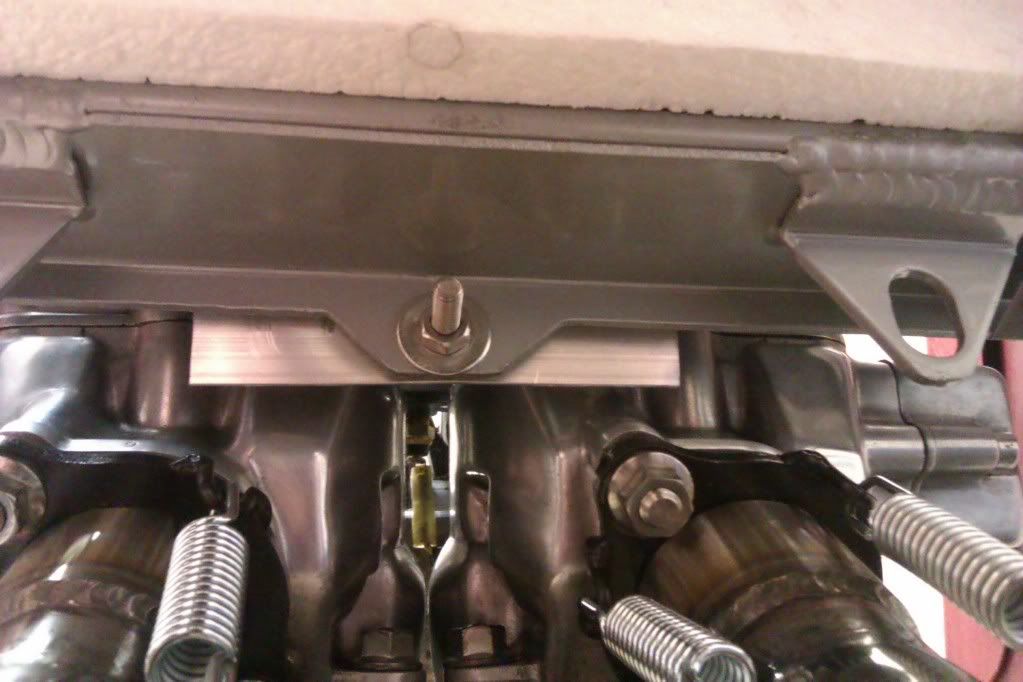

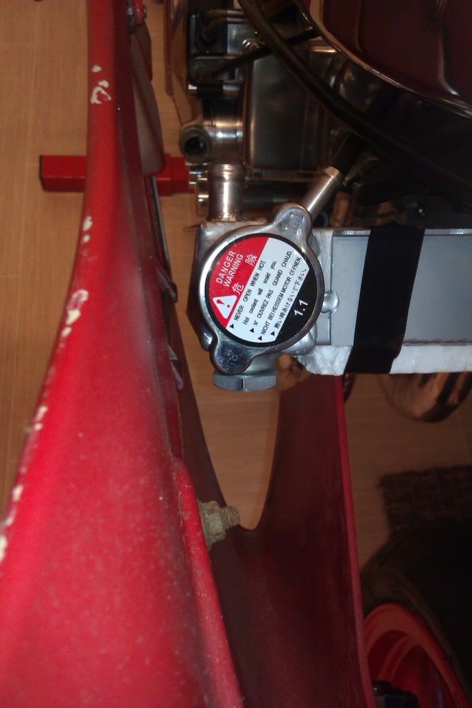

I have been messing about dry fitting the rad, I think I have found the best fit location, by dumping the bottom bracket and mounting the rad from the same fixings on a 25x30mm aluminium angle. It places the new shorter rad in a mid possition, further back (closer to the engine (clearing the top fairing).
Once I am 100% happy with it I will remake the mounting brackets.

Shown the rad pic to the wife and she said.. "ooh that's a tight fit, how's he going to get it in with the pipe" ... She wondered why I spat out ma tea.. Think I best go and get me coat...

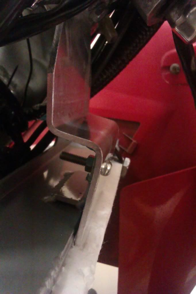

- Posts: 3403
Hi Wayne,

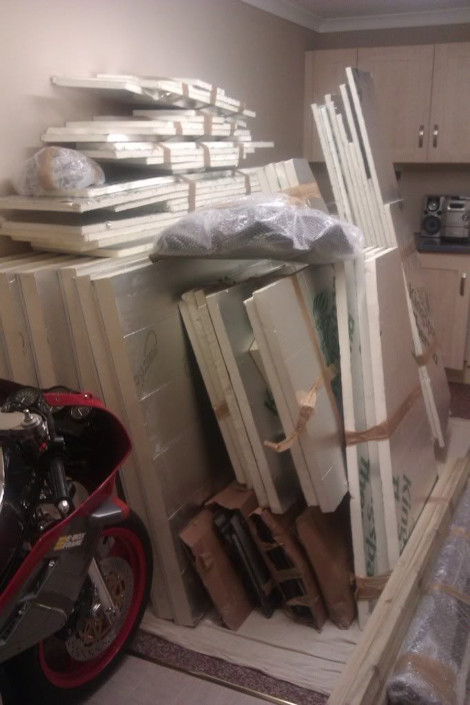

I have been really busy at work and I had the builders in at home (garage filled with kingspan insulation) so I could not get near the bike

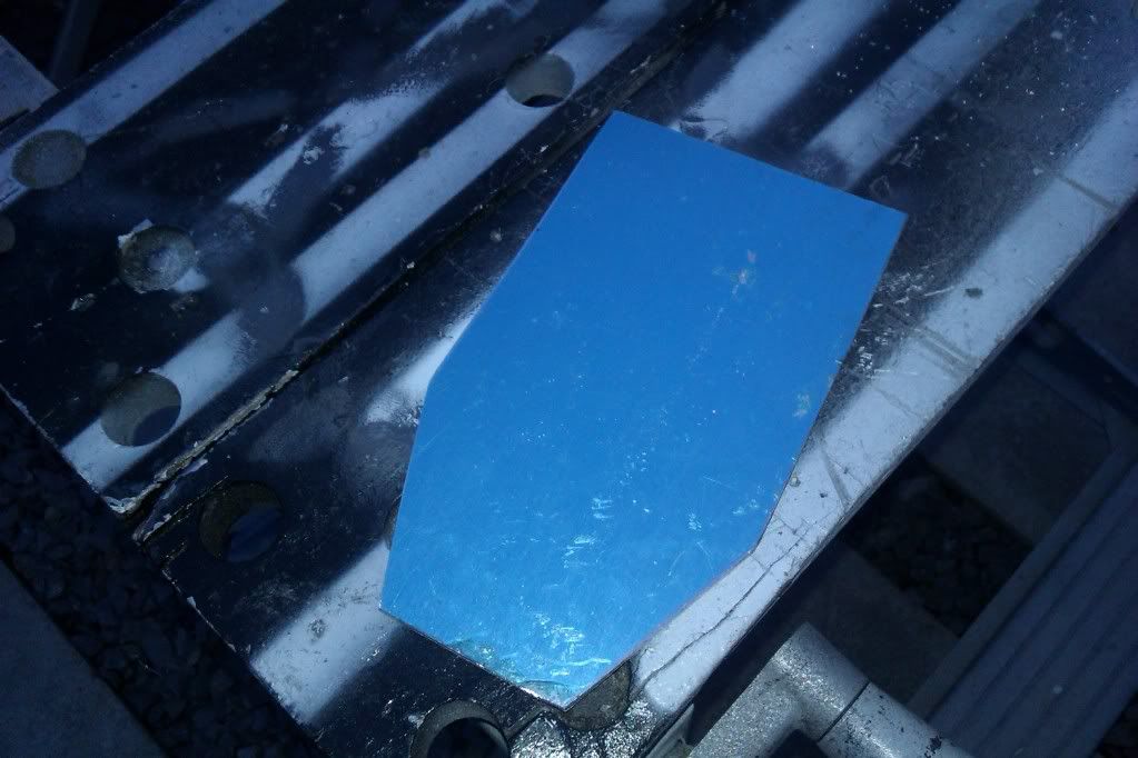

Ben was kind enough to donate some ally plate for me to make the finished brackets for the rad.
I have cut a blank out to size, now I have bent it to shape.
Once I have made the bottom bracket I will polish them

- Posts: 3403

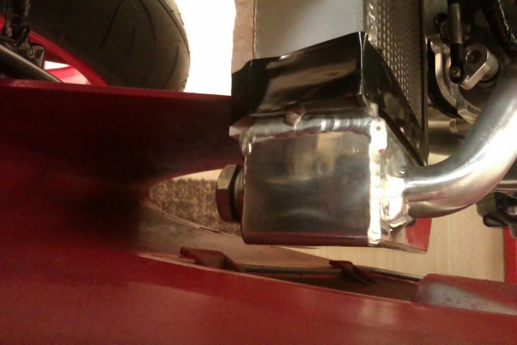

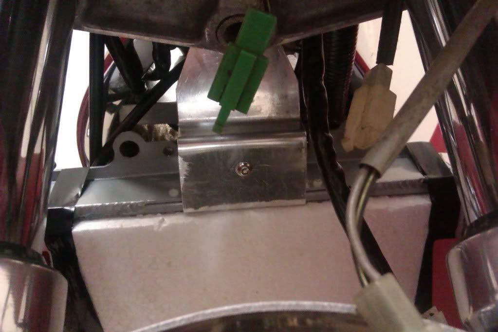

Sorted the bottom bracket out, the rad is really solid and clears the fairing all round by about 10mm.
I will sort some photos out later.
Just need to measure up for some nice silicon hoses
