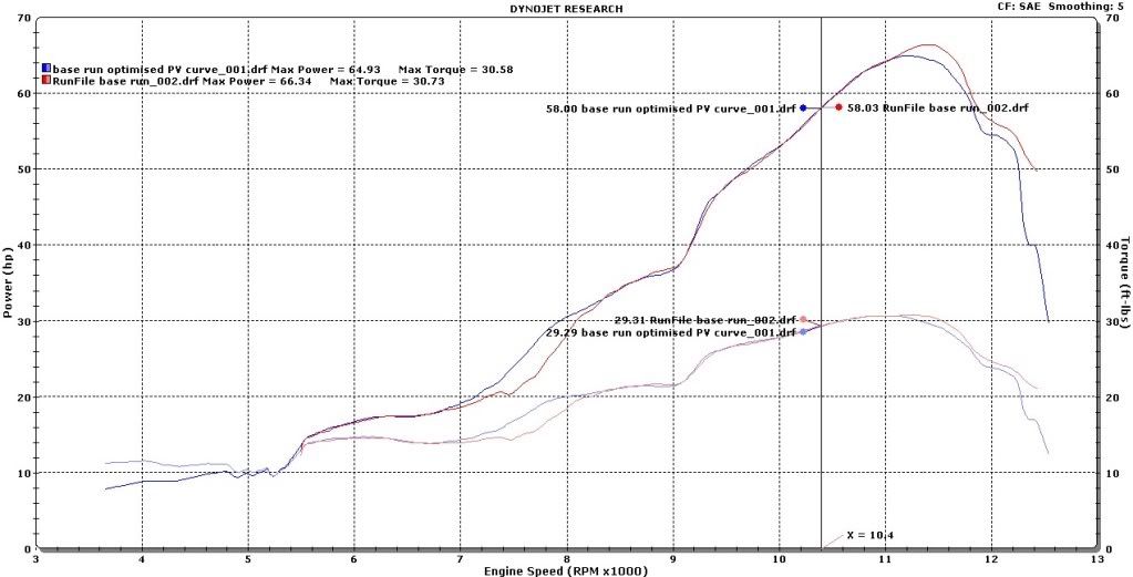

Pretty much a standard cylinder/cases with TYGA pipes and aftermarket ignition. About 40 dyno runs later emerged an optimised ignition/pv curve. Crawled our way back to the 'cold case' figure. This dyno reads low (SAE 0.95 correction factor).
Not quite there but on the right track, next is some better cylinders, more comp, reed valves and case work.Wishlist would be a set of my pipes if I could get the bike for a while.

Yeah that's the spec of the RS250 Aprilia(basicaly RGV) with just bolt-on bits. Was about 35 runs and 2 hours work to get us back to the cold case figure. Running pump 98 ULP fuel too. I think my signature is 'crochet & croquet'mgtkr1 wrote:tsi, what engine is that? very good curve. that the spec in the bottom of your sig?
