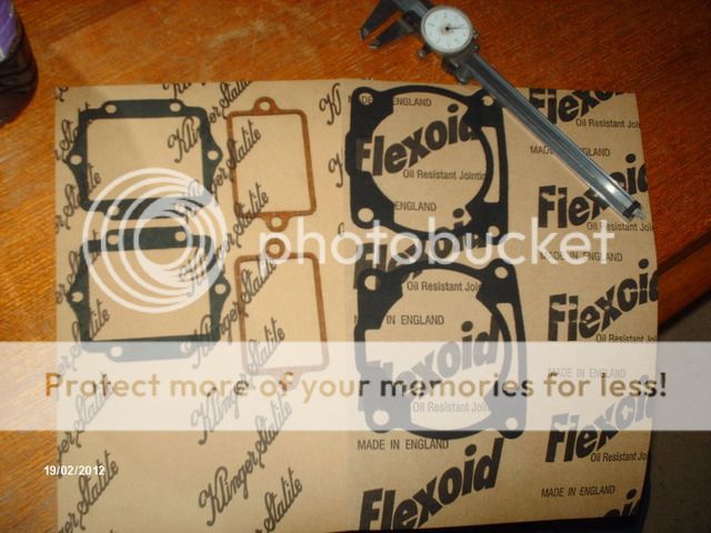

made a bit of progress and had a shift around in the shed,one of my mates gave me a unused shotblast cabinet for my 40th thats half the size of my home made tardise one,and finally managed to scale some gaskets .
love the bottle of newcastle brown fred

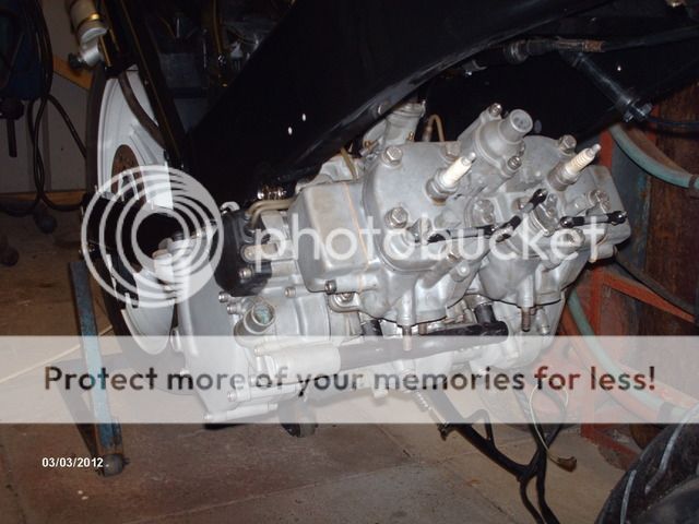

good evening ,barrels n head back on and new small ends , cut a .3 gasket for right 90.6 high barrel and .4 gasket for left 90.5 barrel ,checked squish at .7mm so hopeing i havent gone too low as the other gasket paper i had would`nt add up, and chucked the new links on just to see cheers lee,so spent £140 on barrels,15 on bolts 20 on links n 20 on thermostat n sender :D

good progress today ,them carb t airbox rubbers always seem a pain to me(bit of hot water and rotate them to get seated allways with the airbox open) cheers spannerman for the throttle cable ,tommoro ile be gutting my standard expansion chambers and maybe make a jig for the new homemade exhausts to aid repeatability on the next ones ,booked in to run the hill at prescott hill climb as well in a month or so ,should be fun ,ile be shit scared of being infront of a audience tho 8-[

Tell you what Fred, that's like looking down onto my bike, only yours is a whole lot cleaner & neater :D
Are you keeping the wheels white? I do like white wheels 8)
Posts: 926
yep white wheels ,black everything that could be powdercoated,zinl plated fixings n stainless, and plain kwak green with no stickers to keep people guessing ish
