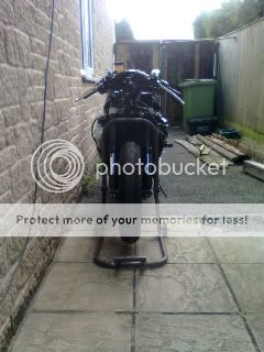

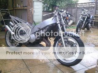

bought on 17.9.2001 for £50 :D ,was done up,cheaply ,shotblast everything,smoothright silver on engine and frame,race products fairing was vauxall mettalic blue (before a icy crash 2yr ago :oops: ) and was on the road all the time whatever the weather.
Posts: 927
it was running well ish ,started second kick,and pulled 110mph in 6th at about 10.000 rising with 15 stone on her,ive never took before and after pictures so this will be a bit of a drive to get the job done,cheers fred

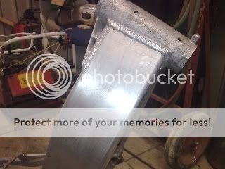

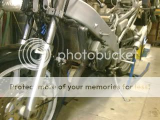

3 litres of liddles paint stripper later,came up cleaner than i thought,thinking of keeping it ally now, has anyone used zoop clear coat or clear powdercoat,i hate polishing,any input would be appreciated,cheers fred

just making some enquiries on clear powdercoat ,orderd some scotch pads to give a fine linnished finnish on all the box section and flat ally
Posts: 927
Just had a chat with a aircraft fitter freind.they use alocrome 1200 a and b. And alocrome 1000 on jet engine intakes.it stops corrosion on ally.picking some up thursday

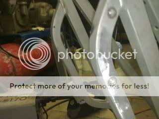

Havent been on here recently.women ,homes n other cxxp .cleaned everything up.ally mig'd the frame for a new nut insert (rear damper mount) ..shed.,winter.,3 projecs., supersurs.... Bleeding knuckles ...i love it .anyone got a drawinng of a bike workbench?

ready for powder coat at last,need to put more time in
ally repair and new nutsert
removable top spar

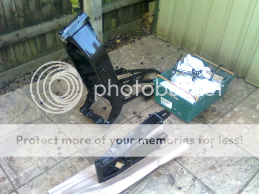

got all my bits back from the powdercoaters today £70 well spent,

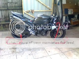

here's a blacked out blade at a show in Sydney
the guy must have shares in a powder coating company
photos dont do it justice
very low and mean with kinda old school but military look
when you think of other models you might do on a cheap find - probably wouldnt turn out this good (faired bikes sometimes hide a lot of complicating junk)

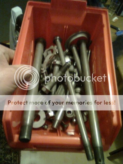

all fittings ready for plateing ,nickel ,droping em off this satday,then its pretty much a rebuild ,but i recon i will start asking more questions when i get to the refill shock with oil bit
