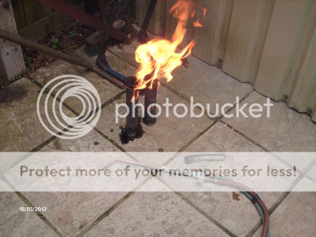

had a bad cold and am asthmatic so aint done much last week was nearly passing out coughing, but on the mend ,,gutted the silencers today,you only need to sand of the weld on the bolt flange then pull out ,get rid of the old packing,burn of the carbon,re wrap and reasemble then reweld ,make sure the 3 inner perf tubes are inline,1 of mine was bent and had started to burn the packing.
all welded ready to fit,Not going to shorten the cans just yet ,(it would be a easy job)callipers blasted ready,new clutch plates n springs to fit ,new battery to boot so should be on with the electrix later this week

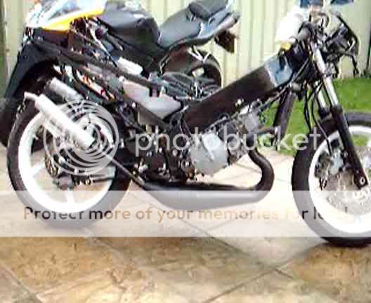

Shese a runner
,second kick ,0nly ran for 2 mins just now bcoz of the neighbours, need to look at tickover on left carb and dont know what air screws are set at,think i did em turn and a half out , the pipes sound great ,quite a bit louder than stock real crisp ,so last of electricks to do tommoz , then fibreglassing and undercoat ,ready to send off ,pics to come tommoro
if i remember rightly with pilot airscrew you tighten them, then undo them till it starts 4 stroking then tighten a bit till it stops ?

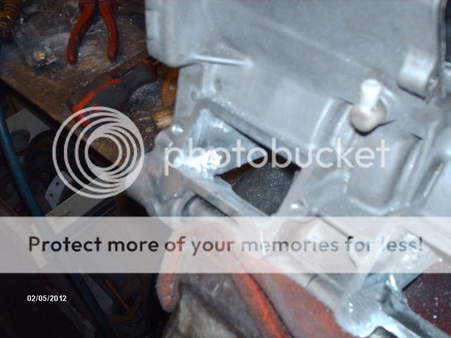

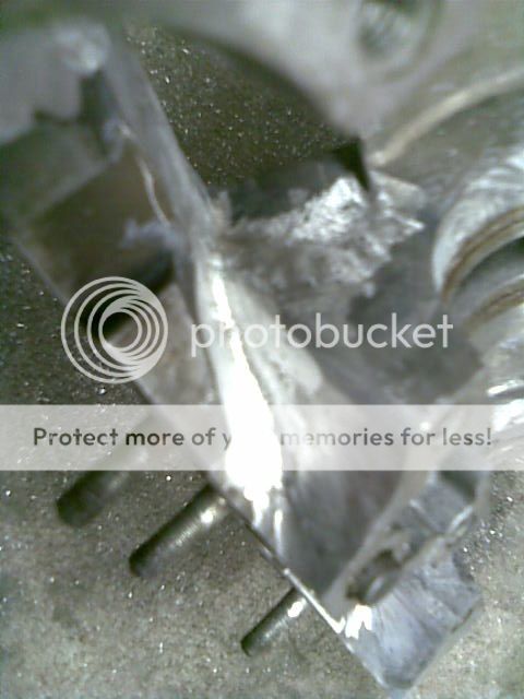

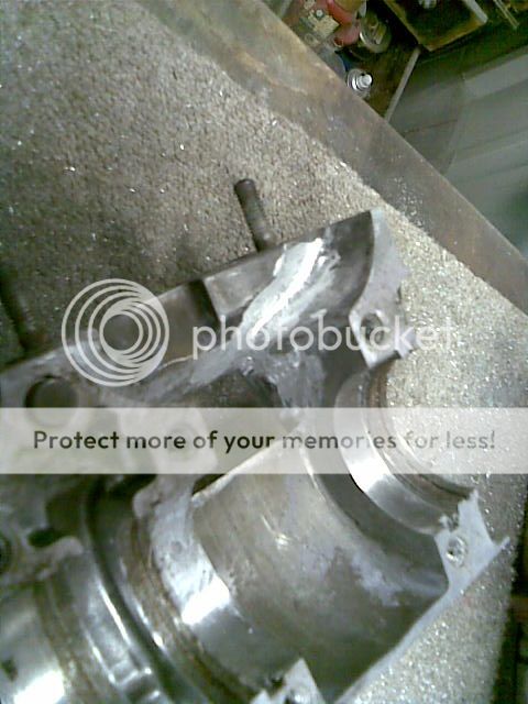

mig ally welding
welded up the receses in the inlets and laid a weld arouns the steps on the inside on the left n right of the inlet and the small pocket just infront of this (i think this is where the casting cores come together ,started fettling this evening and checked nothings moved. it did`nt even get hot enough to burn the engine mounts that i forgot to remove
good temprature indicator tho ,i dont want to remove too much but wanted to add some ,any recomendations would be greatly recieved

- JanBros
- Avgas Sniffer
- Posts: 3322
- Joined: Wed Jul 26, 2006 11:50 pm
- Location: the land of Francorchamps
there's a lot more that you can grind away
viewtopic.php?t=7457&start=0
viewtopic.php?t=1418&postdays=0&postord ... A&start=15
